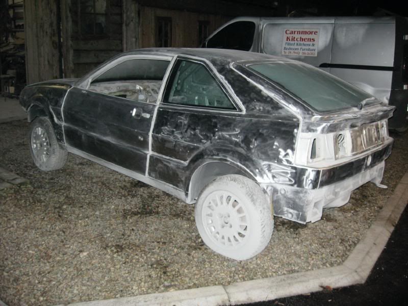

20vturbo 0 Posted January 27, 2009 im doing all the work myself. the only things i am not doing is putting on the base coat and clear as you need a oven to bake it and im getting someone to do the mapping on the engine. everything else is done by yours truly. as soon as a panel is stripped it is going to be primed. Quote Share this post Link to post Share on other sites

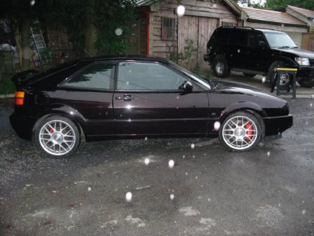

20vturbo 0 Posted January 27, 2009 im using 305mm seat ibiza cupra r discs and carriers. why are people so obsessed with silver corrados, personally i dont like silver on a corrado this is the look im going for its my brothers Quote Share this post Link to post Share on other sites
junkie 0 Posted January 27, 2009 Agree the darker 1's look better. Is your bro on here? Quote Share this post Link to post Share on other sites
20vturbo 0 Posted January 27, 2009 junkie said: Agree the darker 1's look better. Is your bro on here? ya but he doesnt post much, too busy working on his track car Quote Share this post Link to post Share on other sites
mattnorgrove 0 Posted January 28, 2009 Keep up the good work mate! Fair play for even tackling this being as young as you are. The best resto/build thread on here for a while... 8) Quote Share this post Link to post Share on other sites
8vtornado 0 Posted January 28, 2009 loving ur bros car too. brembos+dark colour+bbs rc's = sex Quote Share this post Link to post Share on other sites

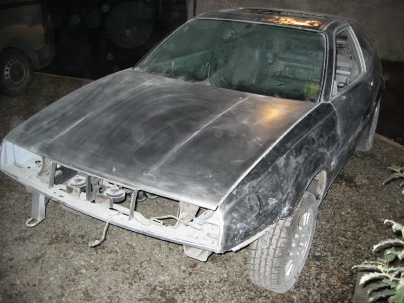

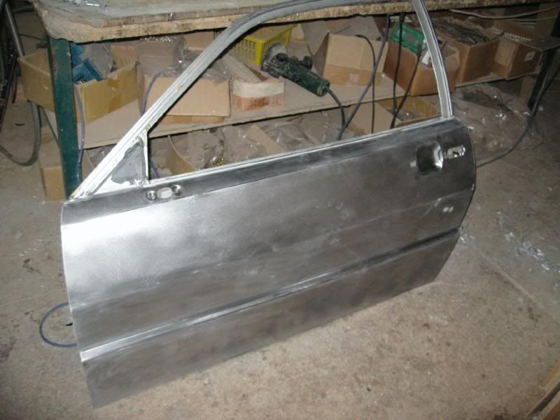

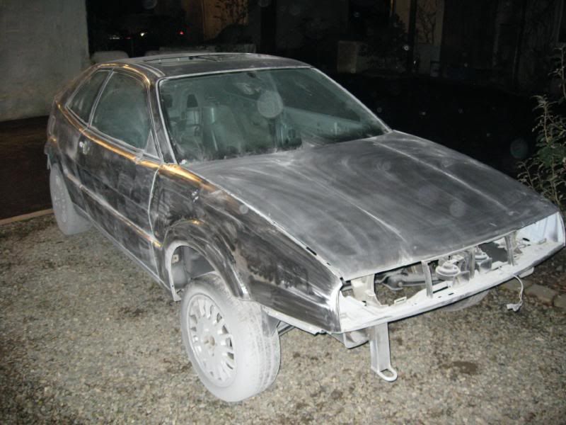

20vturbo 0 Posted January 29, 2009 got some panels striped door finished wing finished bonnet finished Quote Share this post Link to post Share on other sites
KipVR 1 Posted January 29, 2009 Nice progress chap, really impressive. :salute: I noticed you've been sanding the bare metal, tell me if I'm teaching you to suck eggs, but if you use nitromors (put cling film over it to prevent the solvent from evaporating so quick) onto a 40grit sanded area and then use exactly (very important) the type of wire brush pictured below, the paint comes off really easy, but the main advantage is it doesn't take the galvanising off the panel which sanding does, it's also really good for getting into fiddly areas like door shuts etc. Heating up the paint (and so blistering it) with a heat gun first also makes for much faster paint removal. Keep up the good work, this thread is good reading :D Quote Share this post Link to post Share on other sites
rusty bolts 0 Posted January 29, 2009 dude respect, i thought i was one of the youngest on here with a rado when i joined at 18 lol clearly not lol awsome work, im doing an 8v 95 rado to 16v ABF at the mo i might have to come ask you for some pointers lol keep up the good work and lovin the carbon black, almost like the midnight blue LC5M colour very nice. Quote Share this post Link to post Share on other sites
20vturbo 0 Posted January 29, 2009 KipVR said: Nice progress chap, really impressive. :salute: I noticed you've been sanding the bare metal, tell me if I'm teaching you to suck eggs, but if you use nitromors (put cling film over it to prevent the solvent from evaporating so quick) onto a 40grit sanded area and then use exactly (very important) the type of wire brush pictured below, the paint comes off really easy, but the main advantage is it doesn't take the galvanising off the panel which sanding does, it's also really good for getting into fiddly areas like door shuts etc. Heating up the paint (and so blistering it) with a heat gun first also makes for much faster paint removal. Keep up the good work, this thread is good reading :D if only it was that easy, the nitromors or any other paint stripper wont go through the factory primer so the only way to get it all off is to sand it :( bought some of those rubber strip disc for the the shell, the nitromors is just too slow, takes it a while to go through 6 paint jobs :roll: Quote Share this post Link to post Share on other sites

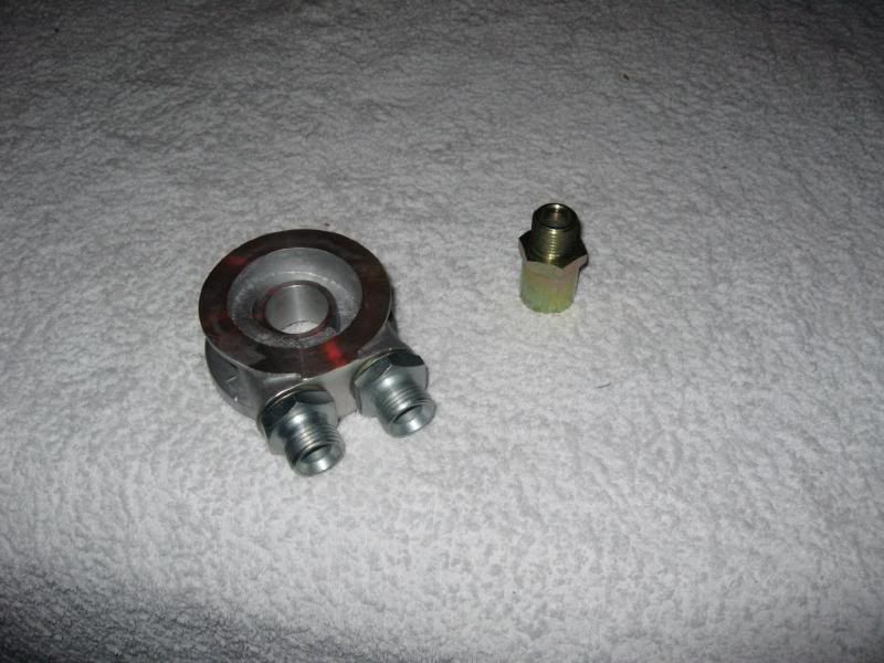

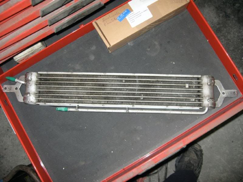

20vturbo 0 Posted January 30, 2009 you wont see one of these on another 20vt conversion very nice oil cooler mocal sandwich plate Quote Share this post Link to post Share on other sites
Sean_Jaymo 0 Posted January 30, 2009 Looks like that oil cooler may be a bit of an overkill to be honest but looks cool as so all is good!!! Quote Share this post Link to post Share on other sites
20vturbo 0 Posted January 30, 2009 going to see how it goes, if its too much i can cover up half of it. plus it was free :D Quote Share this post Link to post Share on other sites

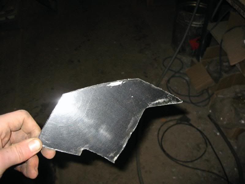

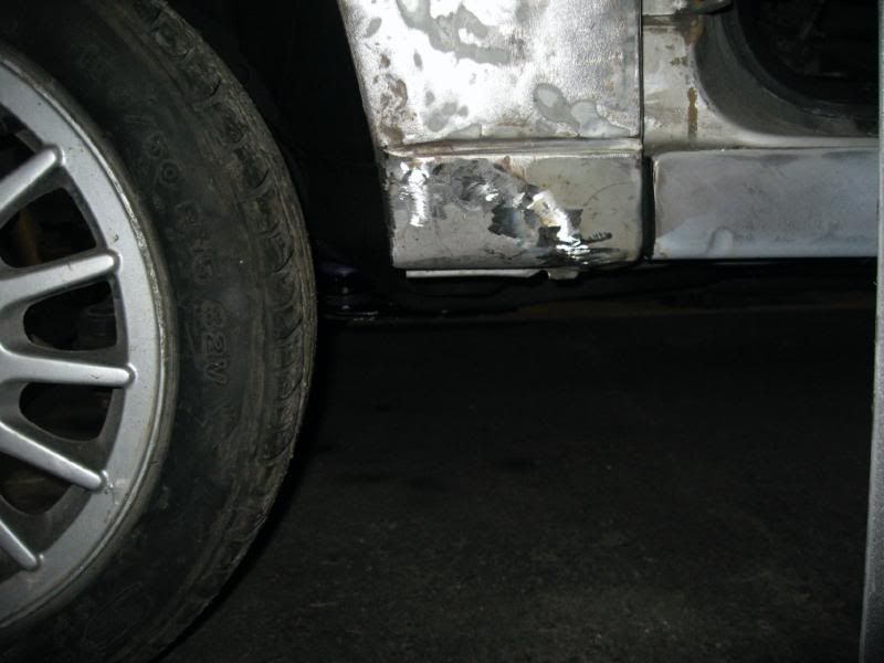

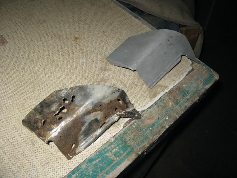

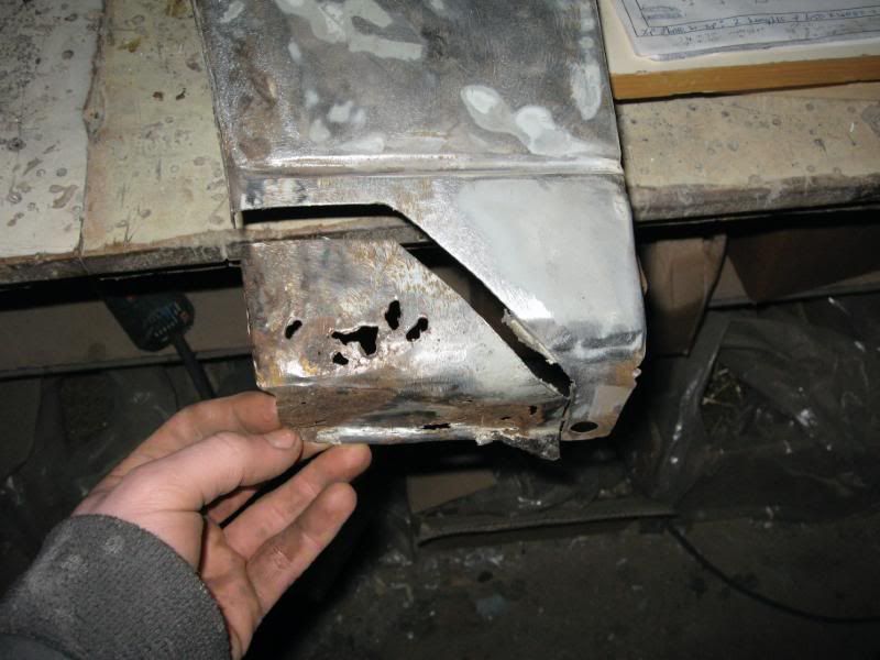

20vturbo 0 Posted February 2, 2009 before anyone says it, i know i could have just got another wing but wheres the fun in that. the mk2 golf bonnet that has sacrificed its self for my corrado (i like the fact that im putting vw metal back onto the car) cut the bottom off the wing cut out the shape i needed the new and the old just need to weld it on Quote Share this post Link to post Share on other sites
raddo_tom 0 Posted February 4, 2009 You have IMMENSE SKILLS! Quote Share this post Link to post Share on other sites

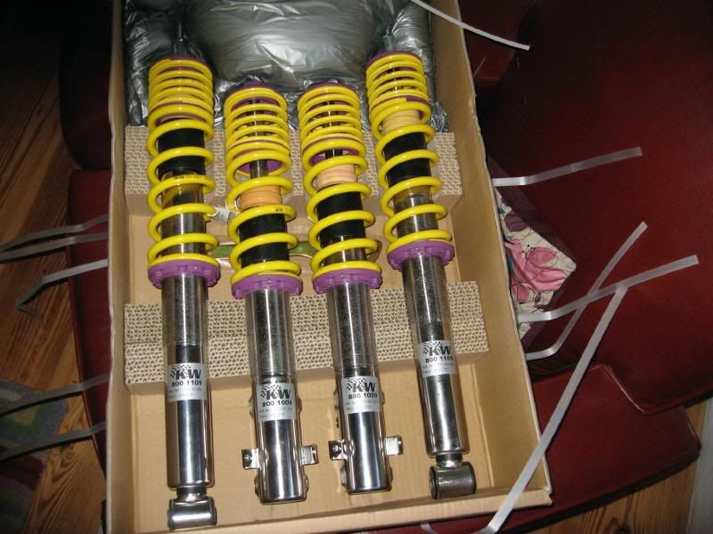

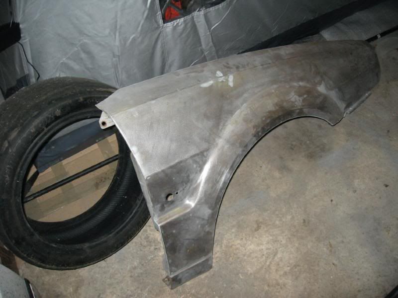

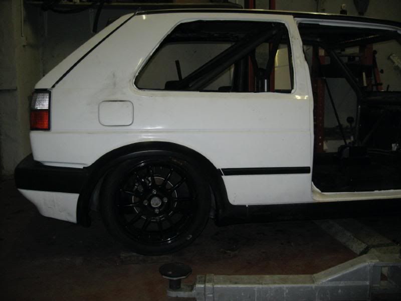

20vturbo 0 Posted February 4, 2009 got the wing finished got distracted because my suspension arrived. kw variant 3's fitted them to my brothers track car so he can move it while he is waiting for his suspension. wound them right down just for the laugh. hard to get a good pic Quote Share this post Link to post Share on other sites

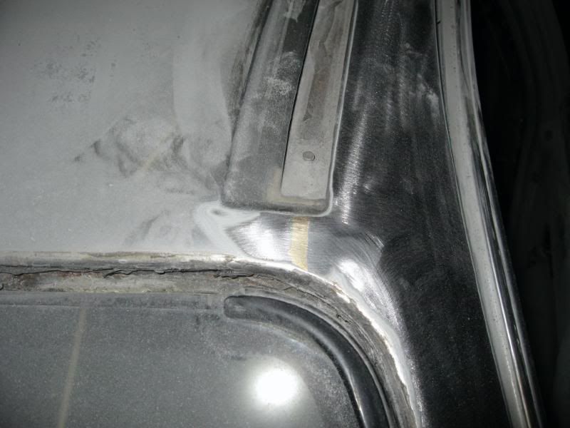

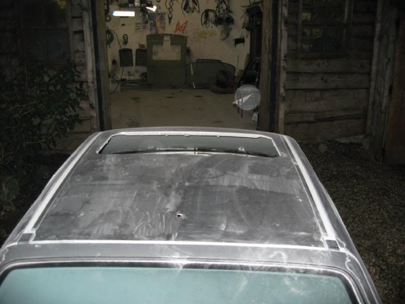

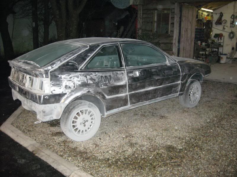

20vturbo 0 Posted February 7, 2009 started on the shell and 5 hours later i was left with this some really nice brass work waiting for the wire to cut the windows out, then i can finish off the shell. Quote Share this post Link to post Share on other sites
corradophil 3 Posted February 9, 2009 You've been busy. Funny how it looks black - for a moment I thought it was a different car. :lol: Quote Share this post Link to post Share on other sites

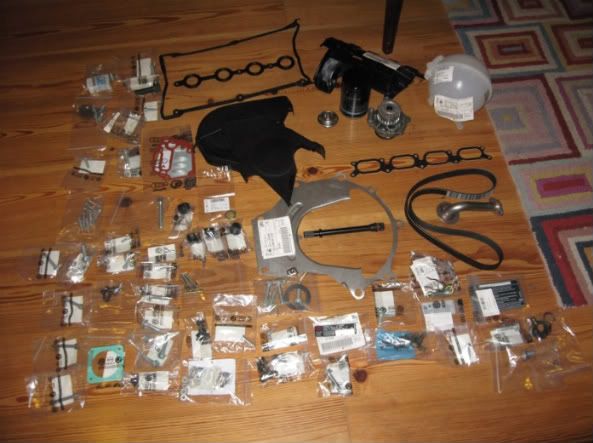

20vturbo 0 Posted February 11, 2009 got some engine parts (genuine of course) and the owner of the body shop came over today to have a look at the car so hopefully it will be going for paint soon. Quote Share this post Link to post Share on other sites
waynos 0 Posted February 11, 2009 you have got some serious skills there lad! Your vw dealer must love you! Can you do me a favour? have you got part numbers for the inlet manifold gasket and the oil filter housing gasket ( the red one in the pic) Quote Share this post Link to post Share on other sites
