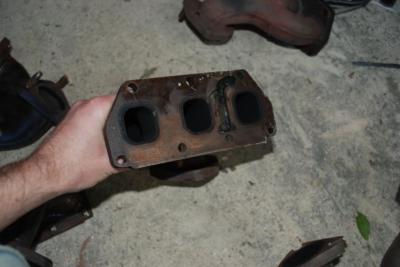

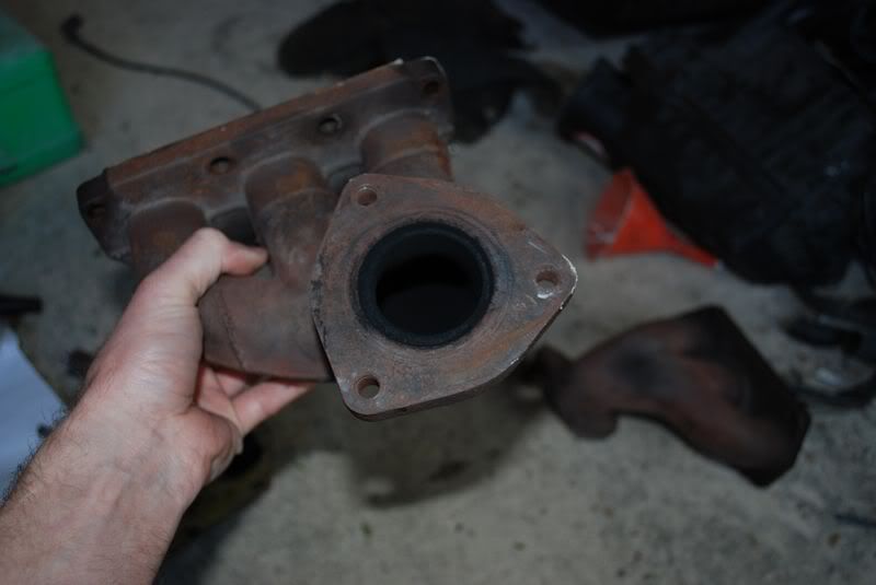

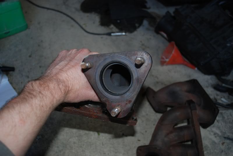

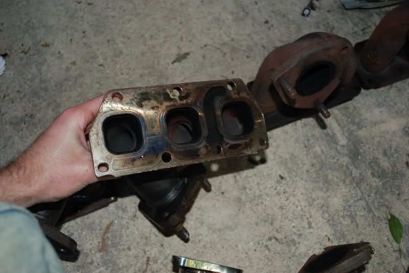

tribetype40 0 Posted September 10, 2009 Ok, just a quicky.. heres the standard OEM 2.8 cast iron manifolds.. and the Tubular late spec Audi 3.2 one... 2.8, Audi 3.2, Its clear looking at the black mark on the 2.8 that the ports in the head are bigger and dont match up that well, looking at the 3.2 ones they are much better. Should be much more free flowing... Quote Share this post Link to post Share on other sites

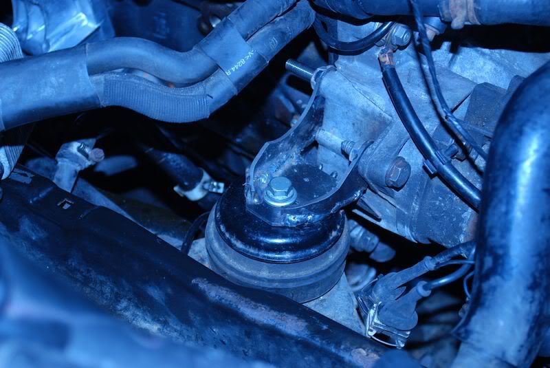

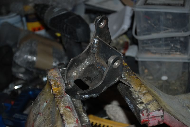

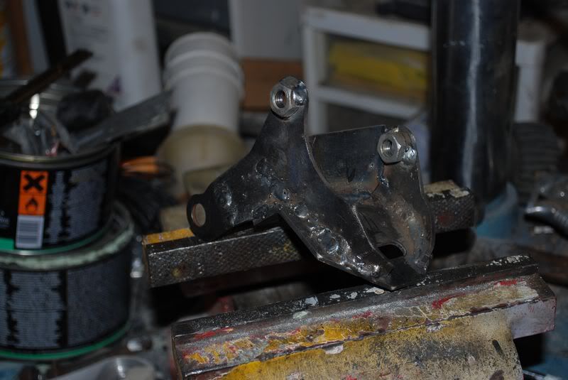

tribetype40 0 Posted September 10, 2009 Here a few pics of the development of the front engine mount. fits around everything so you dont have to mess about with remote coolers etc... Quote Share this post Link to post Share on other sites

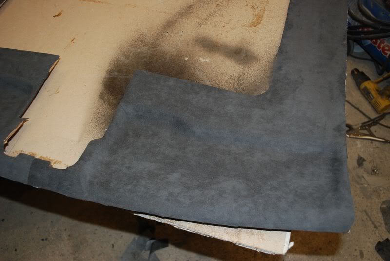

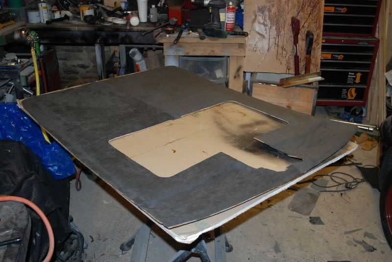

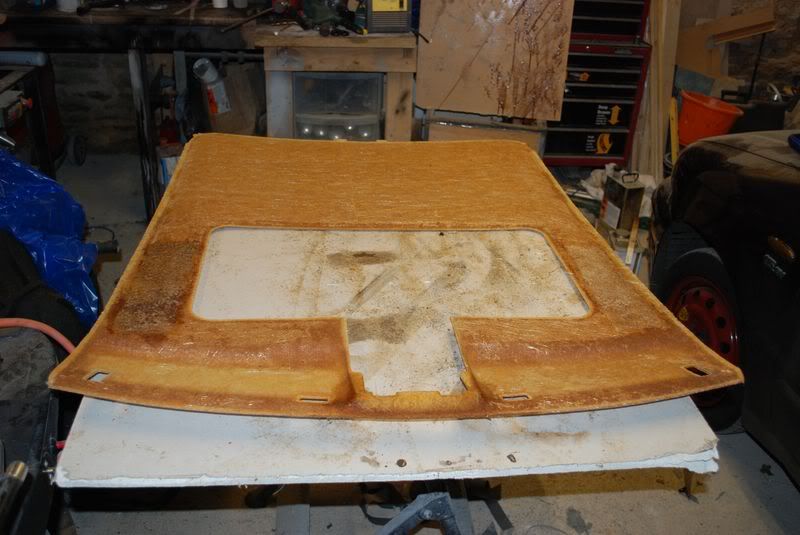

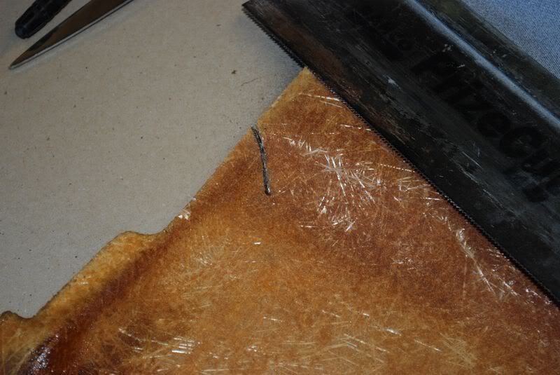

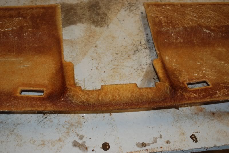

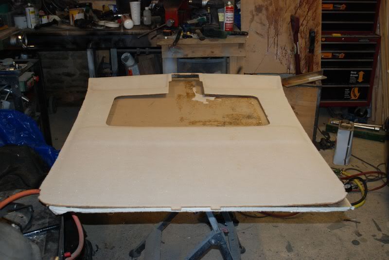

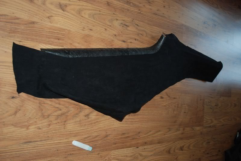

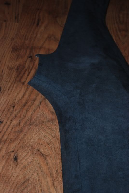

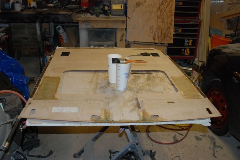

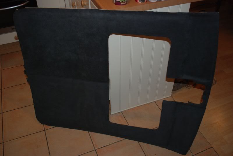

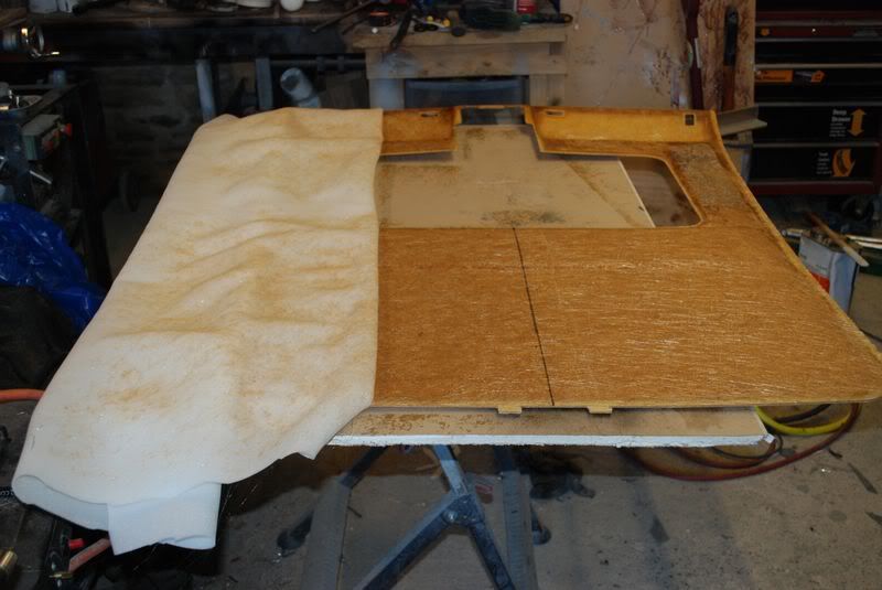

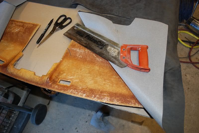

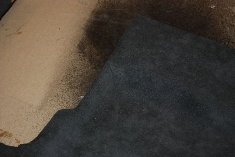

tribetype40 0 Posted September 12, 2009 Eh, you can talk buddy! lol R32's looking impressive, certainly dissapeared quickly enough! I was hoping to have a good day today and get the engine running all set up and check the activation of the cam advance... but, I seem to have had one of those days were, whatever you touch you ar5e up. I've always had a little crack in the sump that just weaped oil, so thought I'd pop it off and run a sliug of weld over it - long story short and a big hole late.... i need a new sump!lol as such I may have to delay I plan for getting it mapped next week :cuckoo: So I cut my losses with the mechanical stuff and turned my attention to the interior. I have most of it trimmed now but today I did the headlining. The old headlining looked fine but on closer inspection the material had started to come away from the substraight so 'the o'l fing'll 'ave to be redone' It neded a little help where it would crease under its own weight on the thinner parts so I braceg it with a thin layer of glass fiber on either side, Then I test fitted the cover, and marked and cut the difficult areas of the sunvisor recesses, When I was happy with that it was time to start sticking stuff, first up new foam (2mm) The final fit of the alcantara... I've also finished the 'A' 'B' and 'C' pillars.... Tomorrow its the sunroof out to trim that. Quote Share this post Link to post Share on other sites

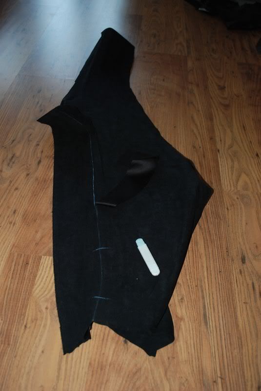

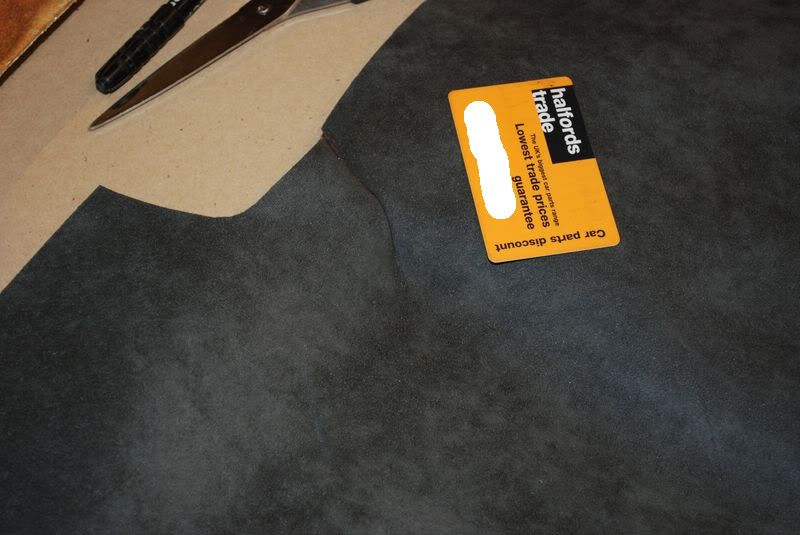

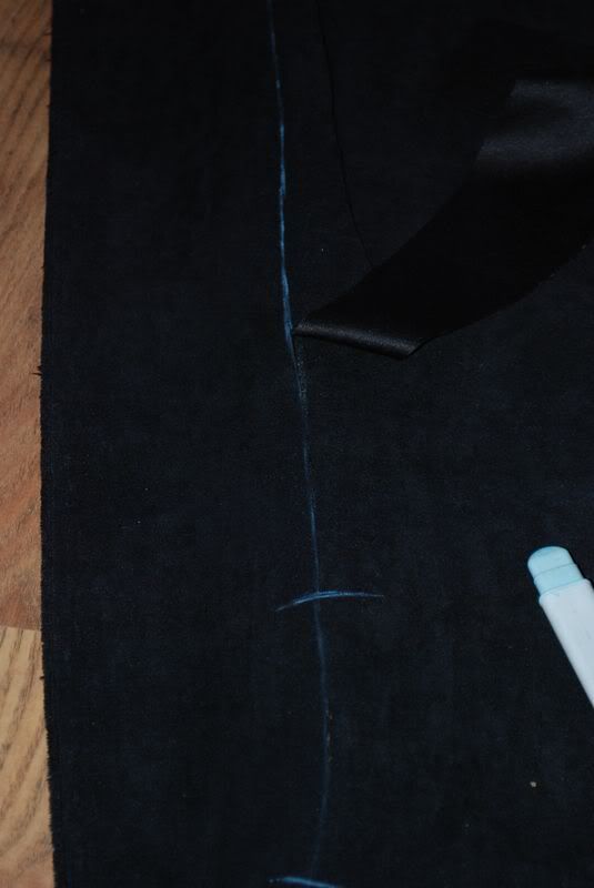

fla 9 Posted September 12, 2009 great skill there Doug, very impressive. Putting alcantara on the trims is what i ahve planned some time so i'll need to pick your brains on achieving a tight finish on those. Are they all covered with single pieces or have you stiched bits together for them? Quote Share this post Link to post Share on other sites

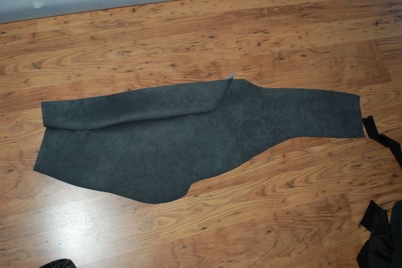

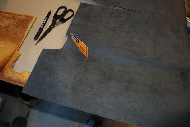

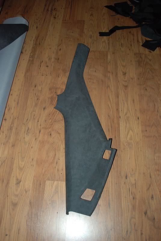

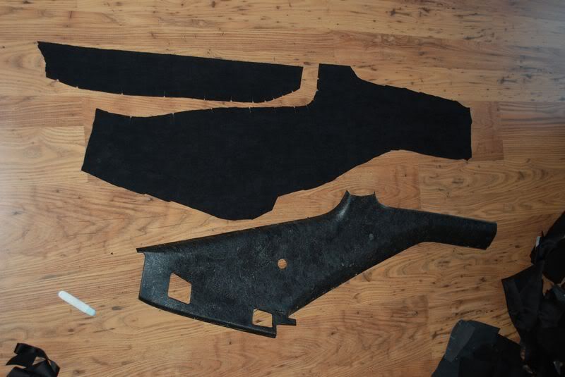

tribetype40 0 Posted September 12, 2009 Cheers, B anc C pillare will need a stich line as it wont stretch enough to cover in one piece. The stitch line is what I've tried to show in that last pic. these show the patterns I made as a template first and a little bit of the process.... Quote Share this post Link to post Share on other sites

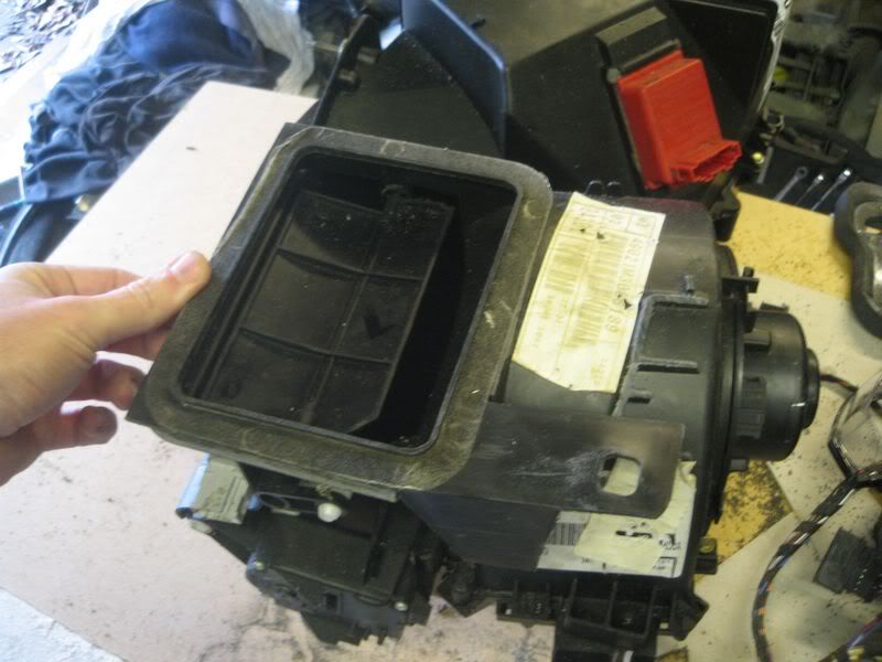

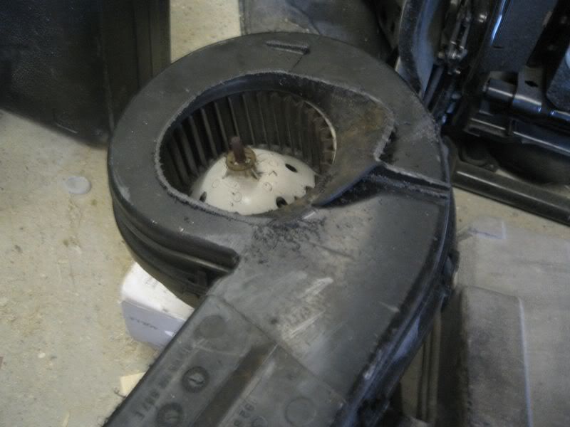

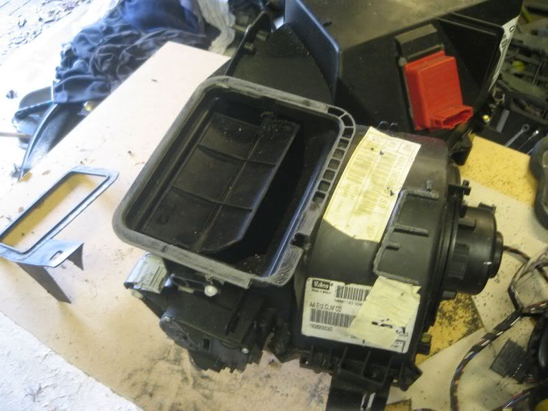

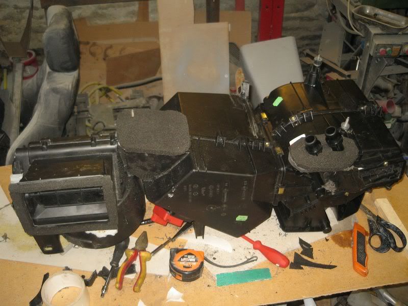

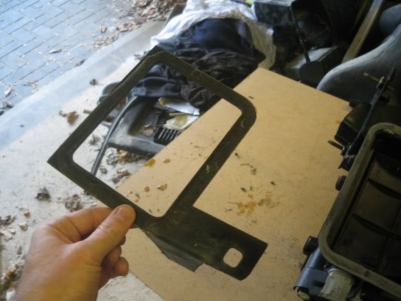

tribetype40 0 Posted September 13, 2009 heres some pics of when I fitted the mk4 airbox, I'd fitted one before so knew what had to be done but this time I made a better job of everything and also used part of the old fan box so I could retain the fixing by the inlet for the fan. this also ment it would position it correctly without any guess work. pictures show removal of the flange from the old box and fitting to the new mk4 box. Once in place I plastic welded the old to the new... In the last picture you can see I had removed and blocked off the pipes and outlet that goes through the bulkhead for the aircon.... during our hot spell I took the heater box out and refitted it all ready for aircon..... well probably ready for winter now! Quote Share this post Link to post Share on other sites

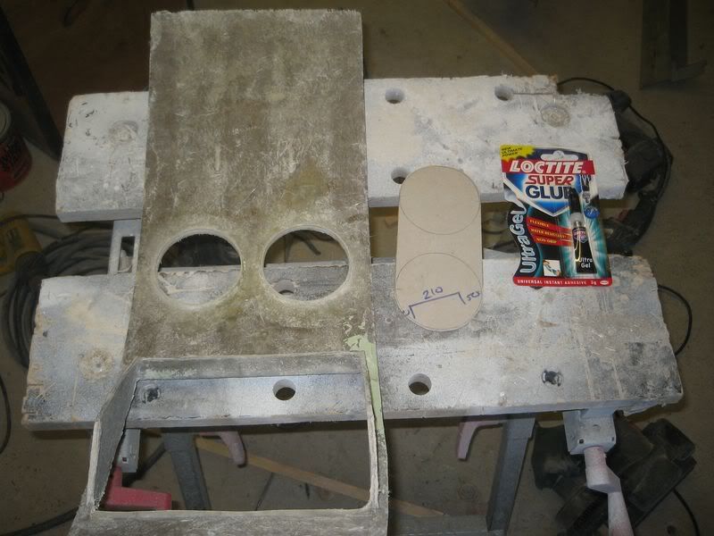

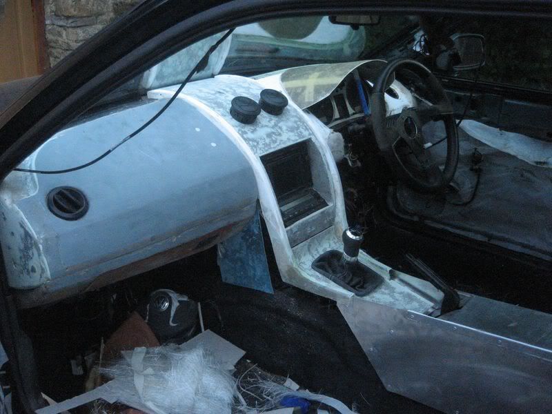

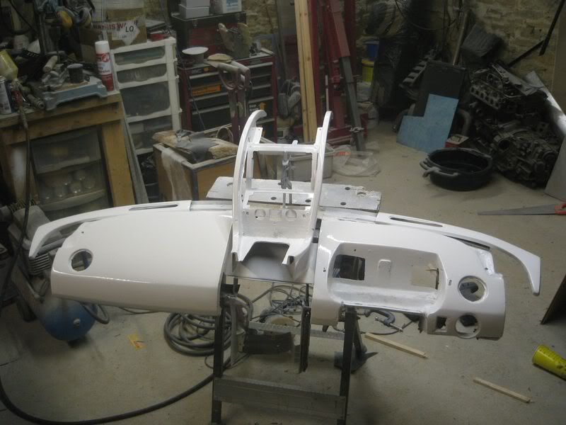

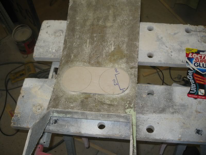

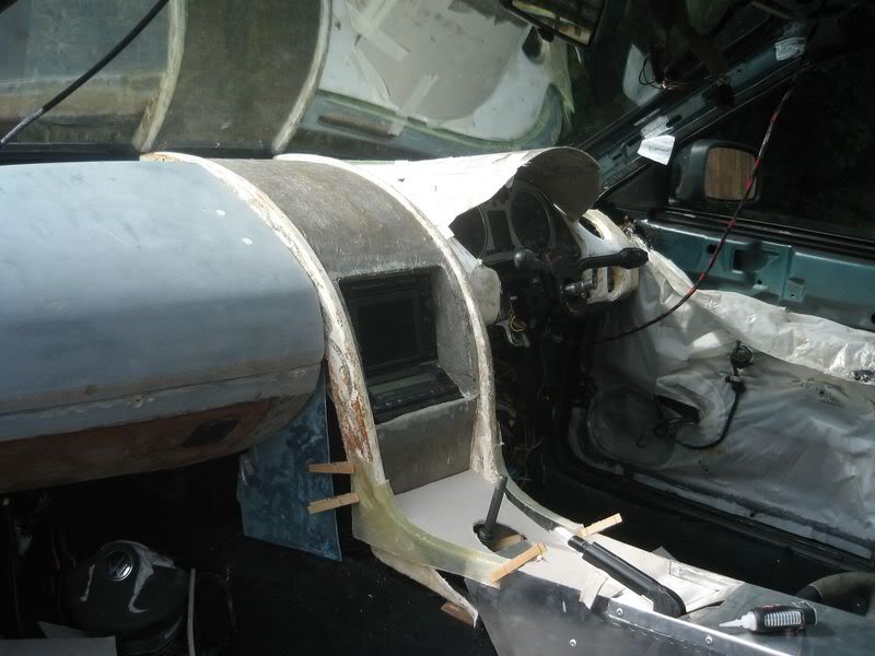

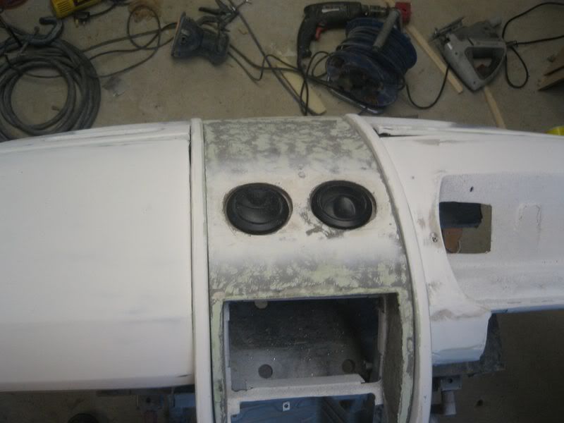

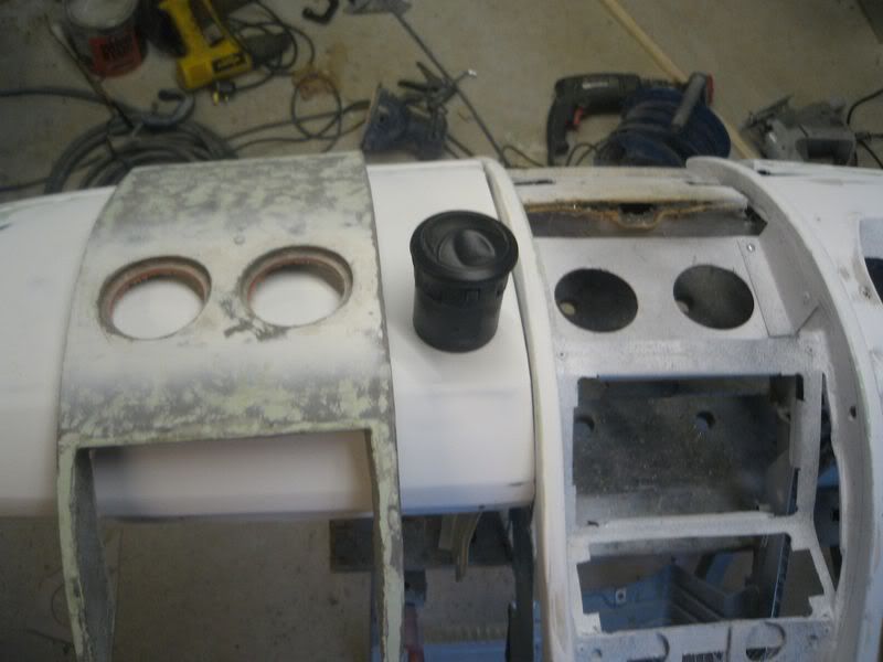

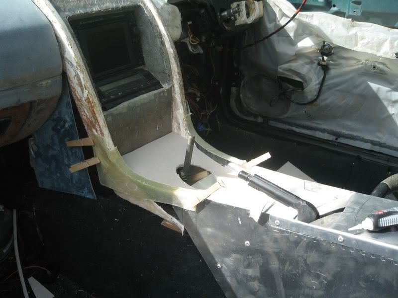

tribetype40 0 Posted September 14, 2009 The original dash, was stripped right down and most of it cut up to leave only parts you can see. The original Corrado dash was cut back and the new panels offered up. I kept cutting the corrado dash back until the new panels were in the correct place while trying to maintain all the heater ducting for the screen and face vents. I also kept the end faces of the Corrado dash and the area around the streering coloum. This ment I knew the width would be as standard and there would be no probems going around the steering coloum and the door cards. I also made a few changes from the origonal dash. I was never happy with the binnicle over the dials on the first dash so I made a new one with a more 'aggressive' style. the centre stack was also changed to be made from GF and have a more complex shape to hold the sat nav at a more horizontal angle ( i had problems with it reading the disc before) I increased the height of the center tunnel this time around so the bottom of the center had to be re-shaped New binnicle can be seen in this pic, it was later given thickness but i think those photos are on my phone, will try and get those up later. here I made the center stack infill panel and sorted the vents Here's a pic of one of the many times it was painted in pimerfiller to get the perfect finish ready for trimming - but that was someway off at this stage! Quote Share this post Link to post Share on other sites

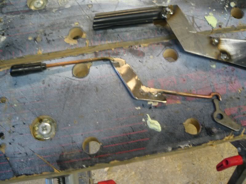

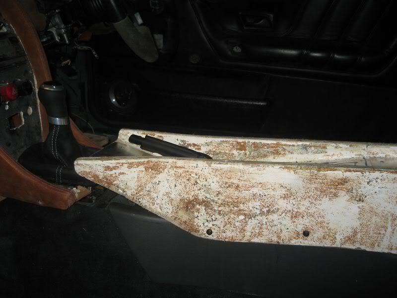

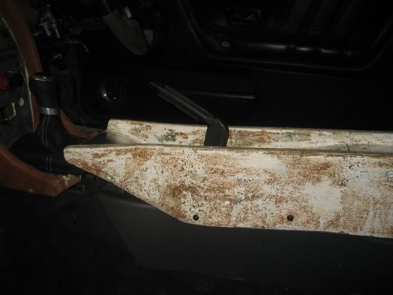

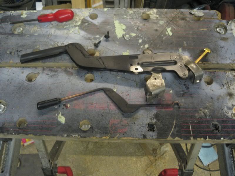

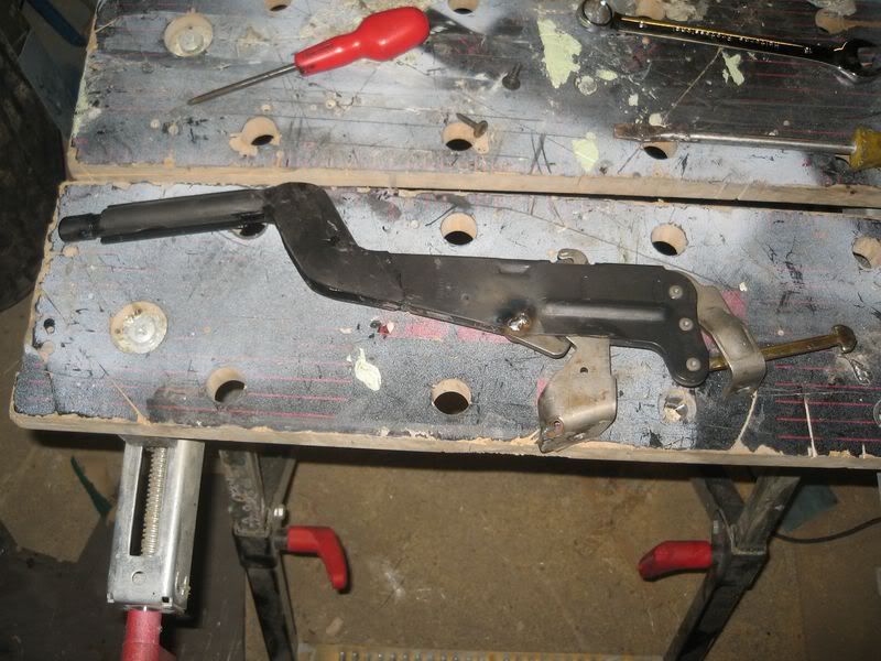

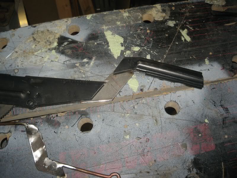

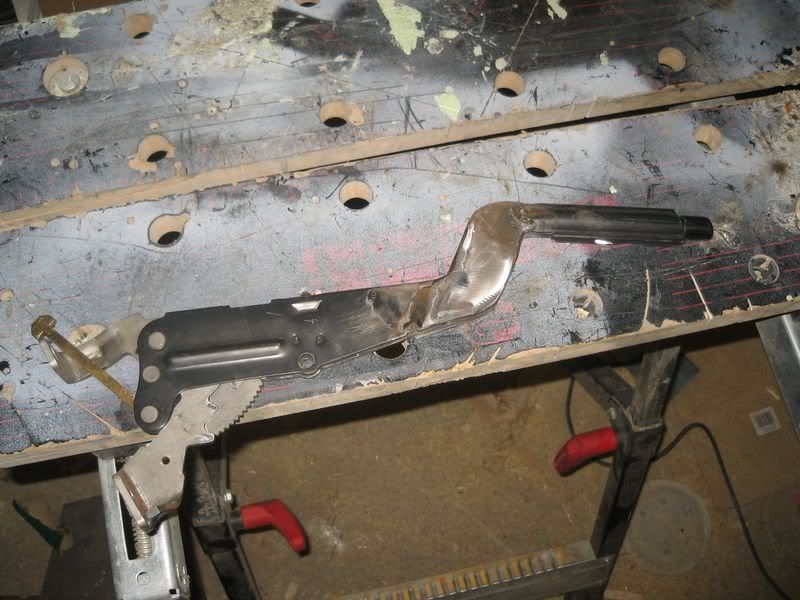

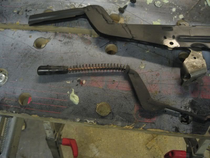

tribetype40 0 Posted September 15, 2009 Because of the new style centre tunnel I had to get creative with the handbrake - cue disc cutter and welder..... off.. on... The center tunnel in these photos was later thrown away as I wasn't happy with it. A new one was made to sit a little higher and I think could be seen in the earlier pics of the dash above. Quote Share this post Link to post Share on other sites
