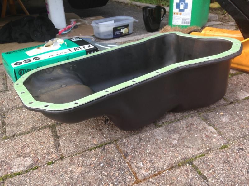

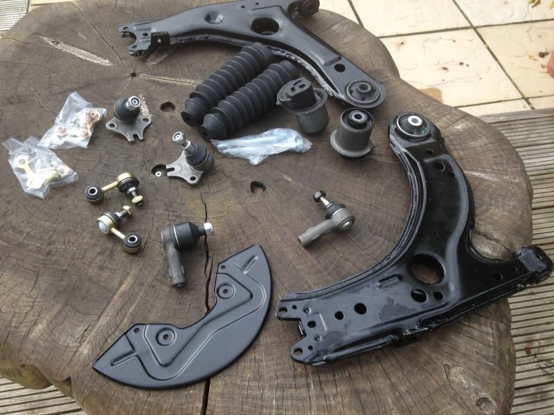

robrado974 1 Posted September 1, 2014 Took delivery of this little lot over the weekend . All parts from vedubmachine and service parts from TPS . Progress is a little slow because of the weather . I have managed to remove the sump , clean it , paint it and fit it back on . All the nuts n bolts are being soaked in WD40 everyday , as they are being very stubborn when it comes to removal . Im sure i will get there eventualy Thanks for looking Rob Quote Share this post Link to post Share on other sites
Roger Chatfield 0 Posted September 1, 2014 Looking good mate, just one thing I'd advise, when reassembling use some copper grease on all the nuts and bolts. We use it on everything on the trains, deffo makes removing stuff later on so much easier. Rog. Quote Share this post Link to post Share on other sites
robrado974 1 Posted September 1, 2014 Thanks Rog , will do . Quote Share this post Link to post Share on other sites
seanl82 23 Posted September 1, 2014 Nice one Rob, look forward to seeing some pics with everything fitted! :thumbleft: Quote Share this post Link to post Share on other sites

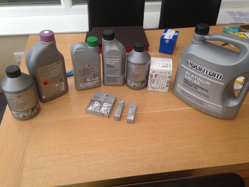

Chris Langdon 0 Posted September 17, 2014 dude why you using 5w-40 :/ thats a bit thin for the VR engine? Quote Share this post Link to post Share on other sites
Jim Bowen 1 Posted September 17, 2014 Took delivery of this little lot over the weekend . All parts from vedubmachine and service parts from TPS . Rob How come the wishbones are different ones? Top ones looks like corrado, bottom one doesn't? Quote Share this post Link to post Share on other sites
robrado974 1 Posted September 17, 2014 When i rang TPS thats the oil they said to use Chris . Jim i will check the part no tonight . Rob Quote Share this post Link to post Share on other sites
seanl82 23 Posted September 17, 2014 Think the 5w-40 is the longlife platinum stuff everything VAG seems to use at the minute. Synta silver 10w-40 is what it should be Rob, although I'm sure I read that it's no longer stocked. May be worth finding a good quality replacement bud. Quote Share this post Link to post Share on other sites
robrado974 1 Posted September 17, 2014 I've just replaced it with 5w40 Sean this is not the right oil ? What with this and what looks like to be a wrong wishbone and the pita door rods , this car is beginning to get me down . Two steps forward four steps back ! Quote Share this post Link to post Share on other sites
seanl82 23 Posted September 17, 2014 Has yours had much engine work done Rob? iirc yours has average mileage, but if it's had work relatively recently you should be safe mate. Thicker oil for a slightly "looser" engine will prevent excess wear, although I wouldn't panic mate, the mileage you do in it shouldn't cause any harm. It may sound a little more noisy than usual is all. Speaking with oilman anyway, he's mentioned that the Synta silver 10w-40 is old hat now and not particularly good compared to modern oils either. It's a little frustrating but it's not a big deal so don't worry too much mate. Quote Share this post Link to post Share on other sites

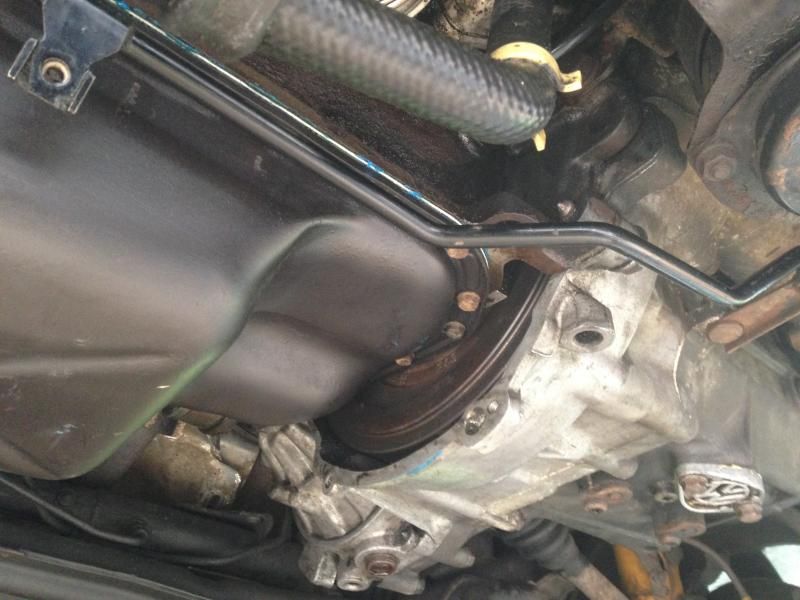

robrado974 1 Posted September 17, 2014 Mine has 151,000 on the clock Sean . New TSR head at 100,000, chains and tensioners were done at the same time . When I removed the sump it was as clean as a whistle , no metal fragments , nothing at all . So fingers crossed it should be fine . Having said that I've realised since I've changed the oil and replaced the sump gasket , that one of the wishbone bolts is directly behind the sump , so this may have to come off again , to get the bolt out . So I might put different oil in anyway , if the sump has to be removed again . The engine has always been as quiet as a mouse , I don't get any tappet or cam noise at all . Quote Share this post Link to post Share on other sites
Jim Bowen 1 Posted September 17, 2014 You can jack up the engine a bit to get wishbone bolt out. Just means undoing the bolts on the engine mounts. Which can be a bit awkward tbh. Deffo looks like a wrong wishbone I'm sorry to say. Quote Share this post Link to post Share on other sites
robrado974 1 Posted September 17, 2014 Thanks for pointing it out Jim , well spotted ! . I've emailed James at vedubmachine with the part numbers , glad you spotted it now , otherwise I would not have known till it came to the fitting . It is a completely different part number . Quote Share this post Link to post Share on other sites
