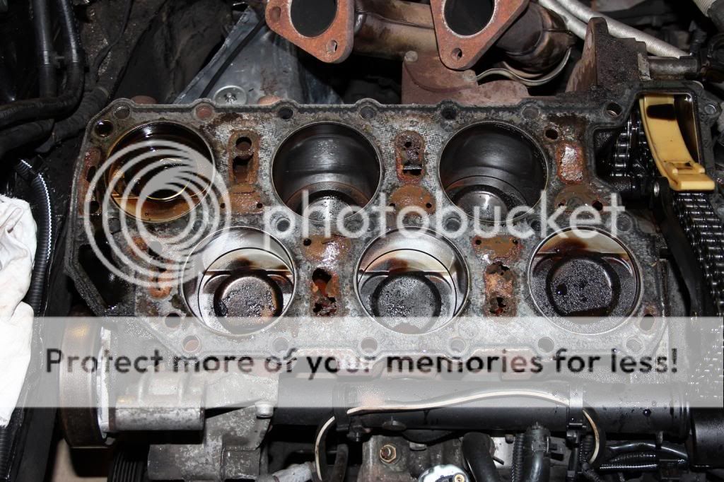

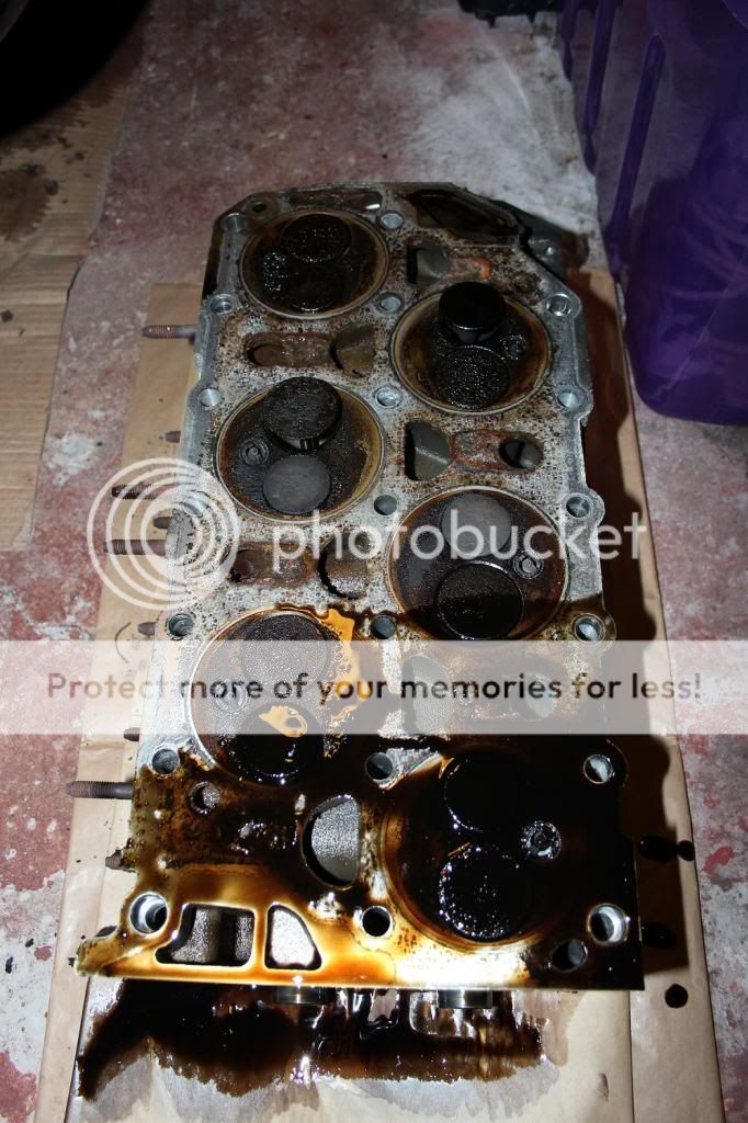

daves16v 1 Posted October 18, 2013 Took the head off a week ago and found the head gasket to be intact and oil in cylinders 1 and 2. Cylinder 3 has some scoring to the bore. So it looks like piston rings and/or valve seals, either way it's going to need stripping right down. The oil on the head is not as a result of the problem, it was tipped up leaking oil from the top of the head. Not sure what my plans are for it, I've got a few options but not decided yet, no rush now that Winter is on it's way. Quote Share this post Link to post Share on other sites

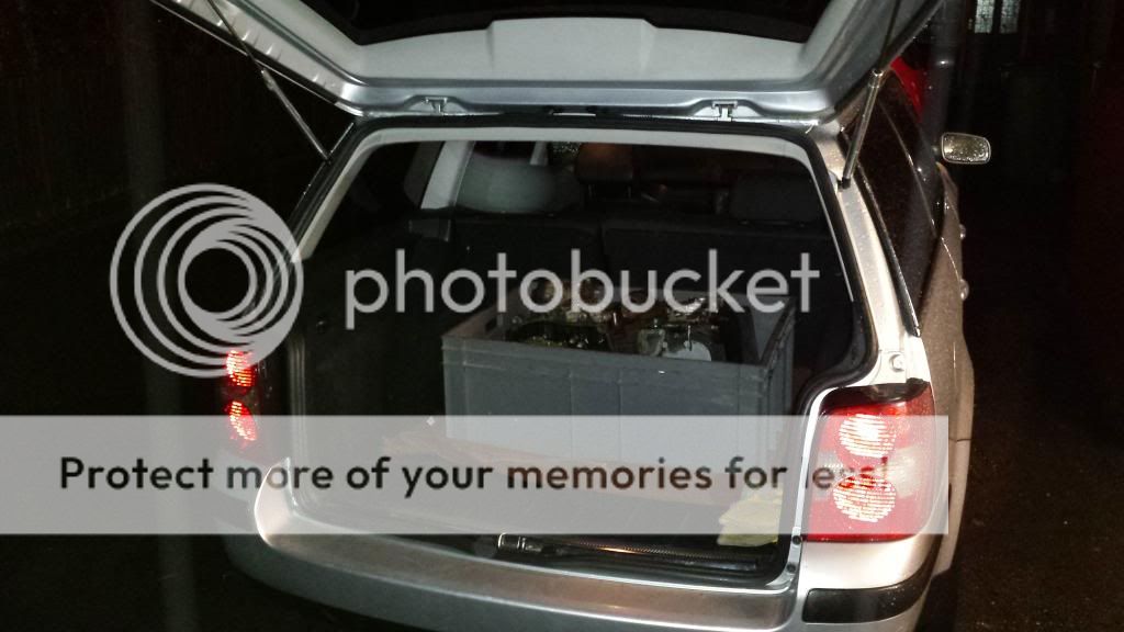

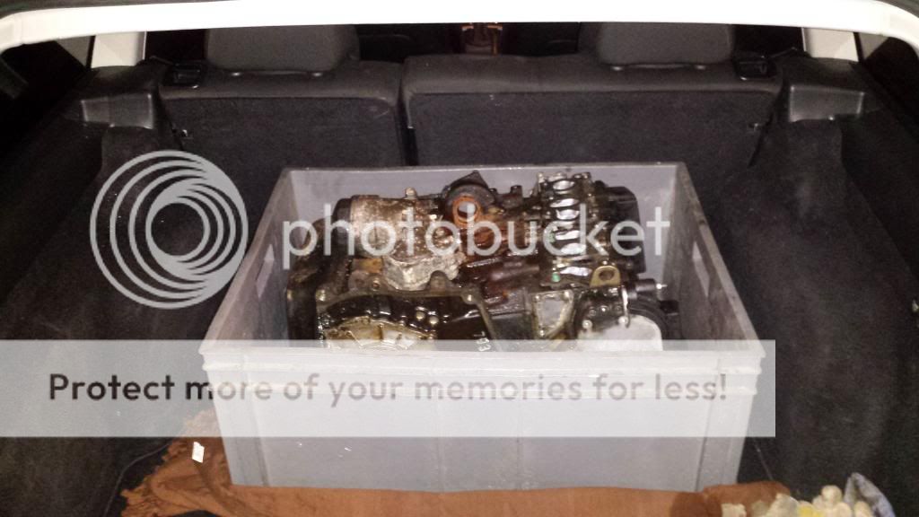

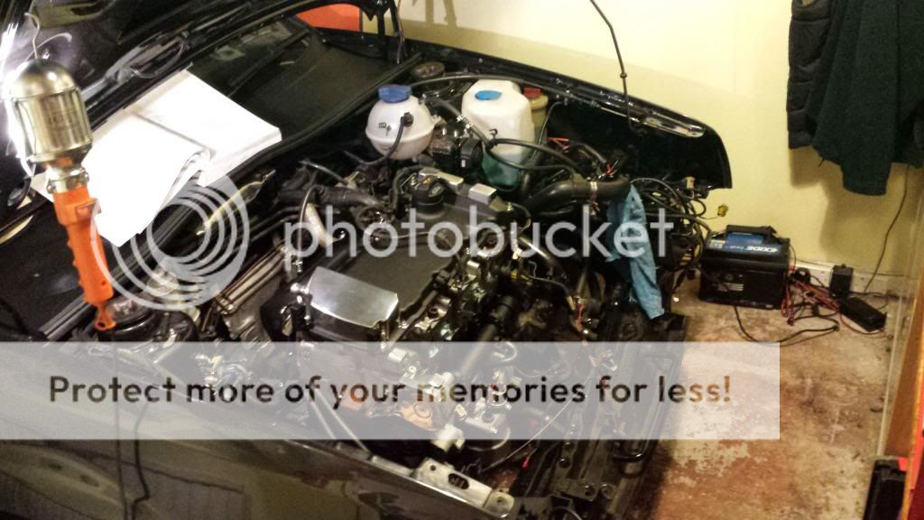

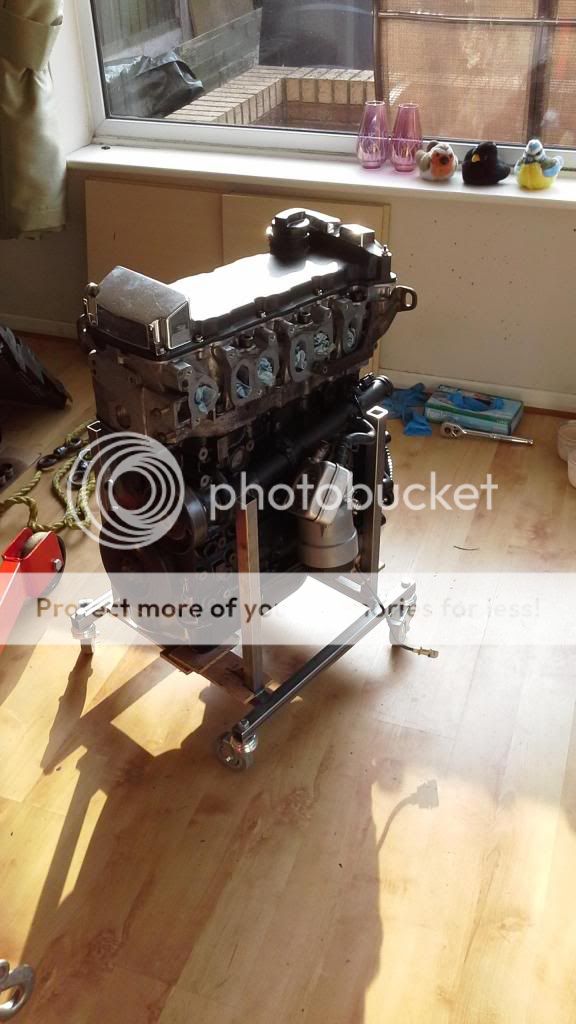

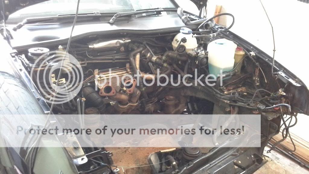

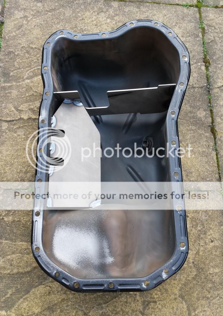

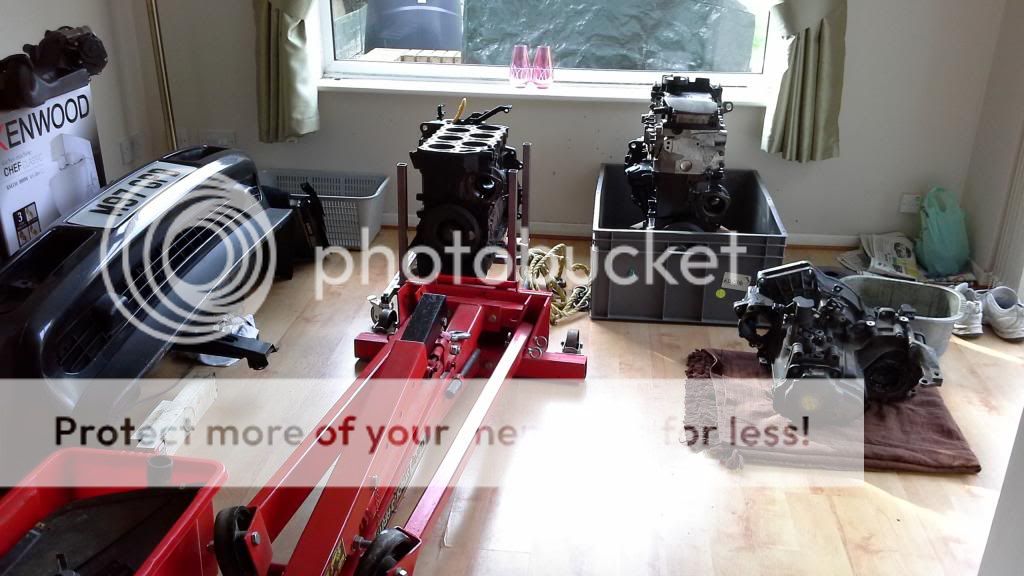

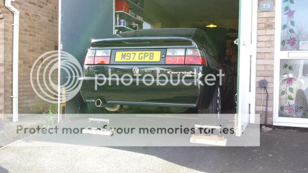

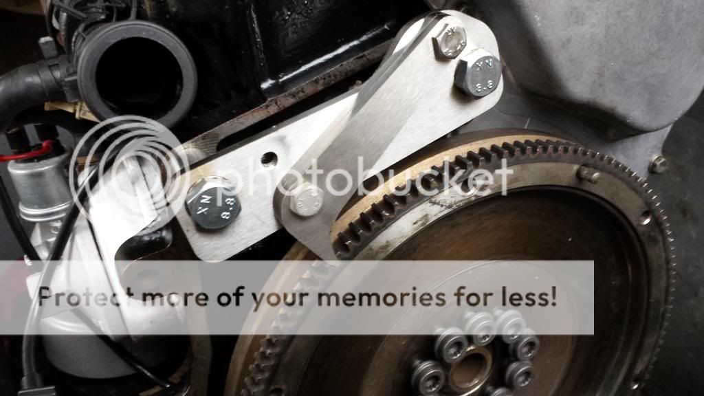

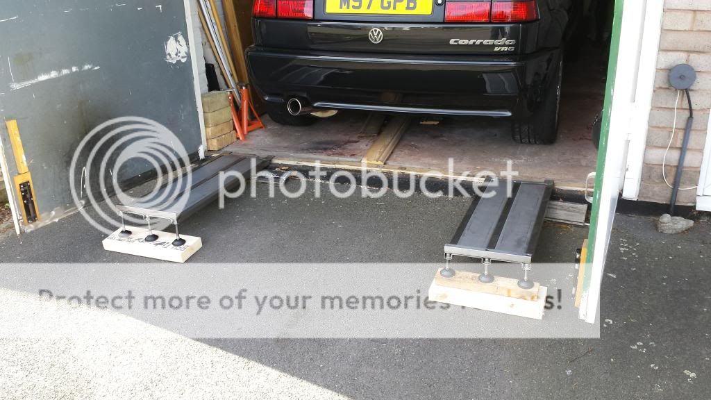

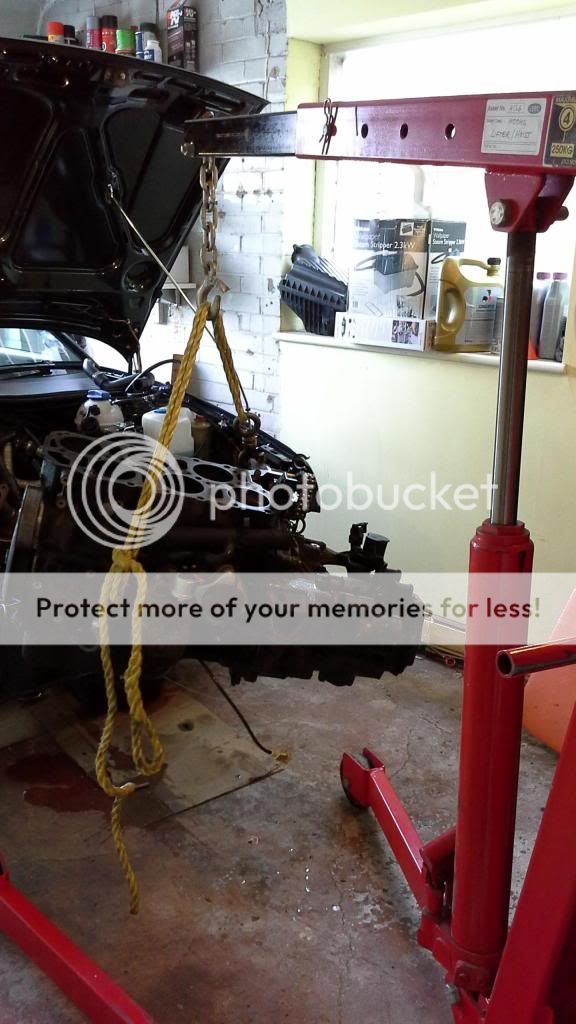

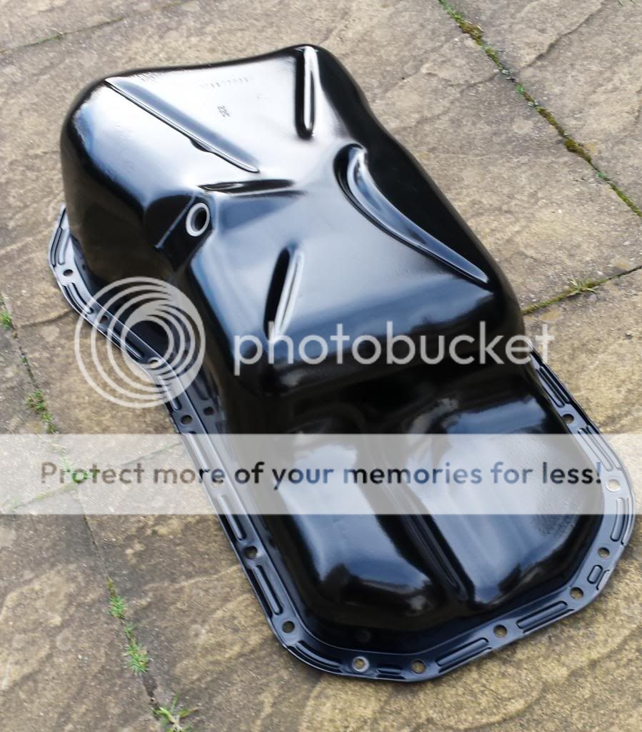

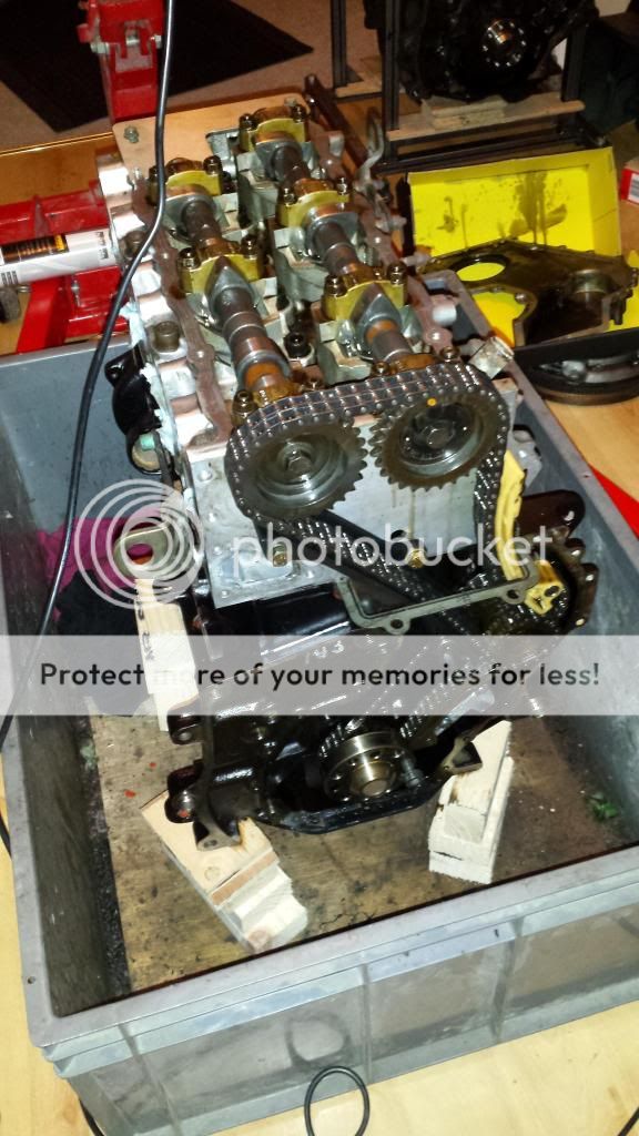

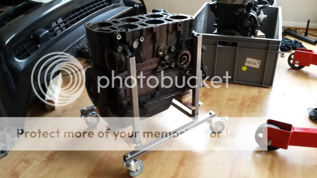

daves16v 1 Posted April 8, 2014 Time for a major update…… So the engine decided to give up last September and the car had stood in the garage for about 4 months before I did anything with it. I sourced a good used VR engine from PurpleTom and popped over to collect it in my Passat Wagon with a suitable sized plastic box which turned out to be the perfect size for a VR block and head. Thanks Tom! I have a standard sized garage but as the driveway is on a slope I couldn’t just push the car out to make space for the engine crane so I fabbed up some extender platforms. Now I have space to whip the engine out. I have an integral garage which means taking the engine through the lounge to the room at the back of the house where I’ve been doing the engine work. Again I fabbed up a wheeled frame to take the engines back and forth through the lounge. My wife is very understanding. Ok time to start swapping the chains, tensioners, 263 cams and tappets over as they’re all nearly new. Fabbed up a flywheel lock which works very well indeed. Off came the sump for some blasting and powder coating after fitting sump baffles. Block has been painted and various other bits blasted and lacquered, namely the Ali parts. In other words a good tarting up! Engine is on the frame ready for wheeling into the garage. I’ve done some tidying of the engine bay too, just a bit of cleaning, bit of surface rust sorted on the battery tray and some re-wrapping of wiring looms. A few more bits of Stainless done – Engine install well on the way to completion. Car is back together now and the first fire-up went well apart from a noisy tappet which is silent now and a minor fuel leak. Oh and I got my oil pressure and temp wires wrong way round which stumped me for a while. Anyway click on the photo for a video of how it runs now. Quote Share this post Link to post Share on other sites

easypops 8 Posted April 8, 2014 That wee trolley is class, as is the flywheel locking tool :notworthy: Quote Share this post Link to post Share on other sites

Goldie 2 Posted April 8, 2014 You have an eye for detail, not only in the bits you make to be fitted but those ramps are ingenious.. Craftsman.. Quote Share this post Link to post Share on other sites

ChrisL 20 Posted April 8, 2014 Excellent stuff Dave, love the ramps for levelling the car out of the garage. They'd be great for the front for cleaning underneath. Definately more trophies for you this year. Quote Share this post Link to post Share on other sites

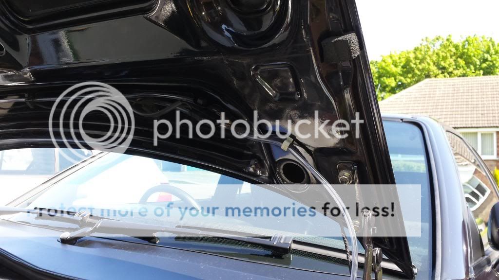

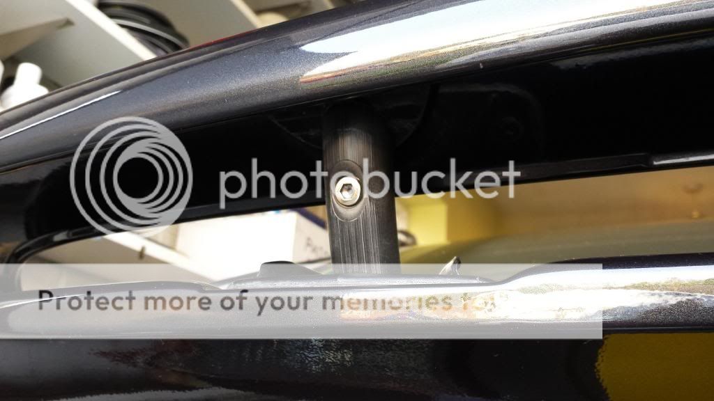

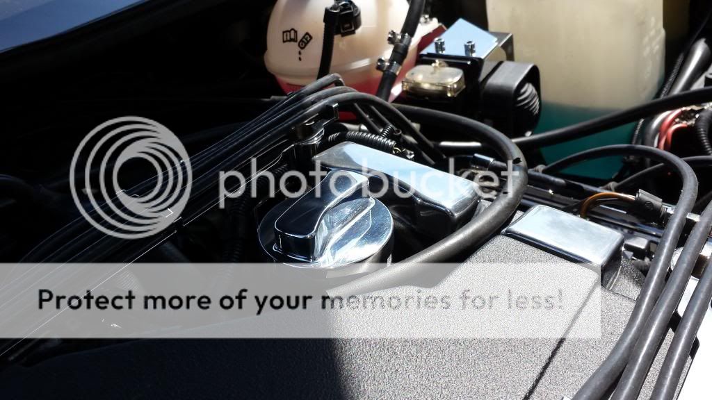

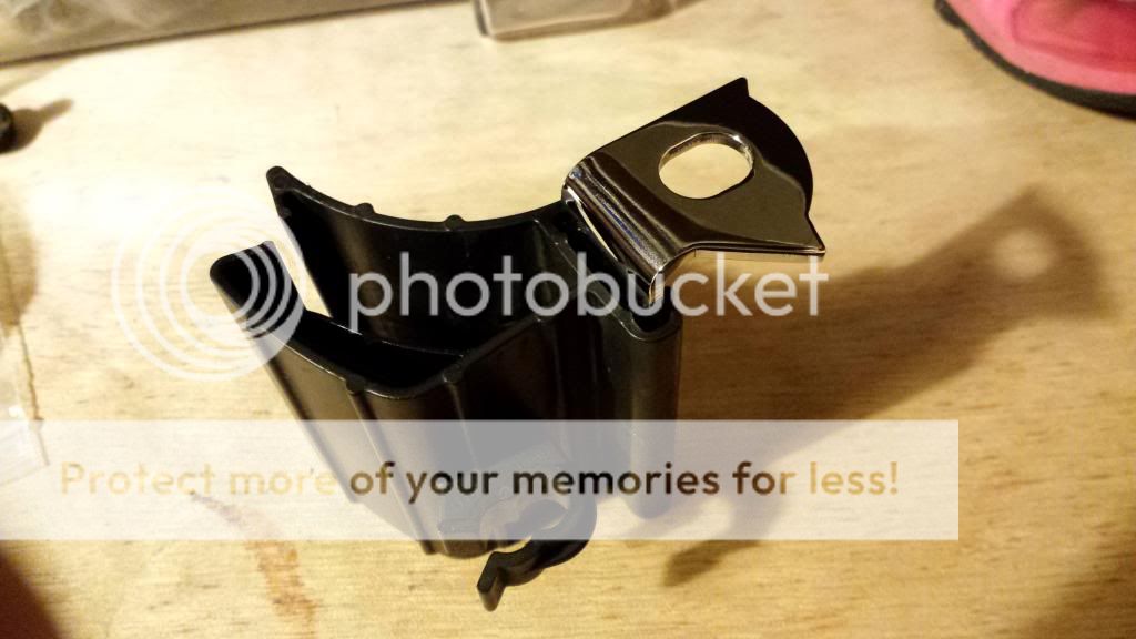

daves16v 1 Posted May 3, 2014 Just a few little upgrades recently. Trimsport Ali oil cap. Replaced rusty spoiler screws with polished Stainless, you do have to grind the heads down on a standard screw by about half. Replaced the old grubby Brown washer hose with new stuff from Halfords, perfect fit too. Quote Share this post Link to post Share on other sites
