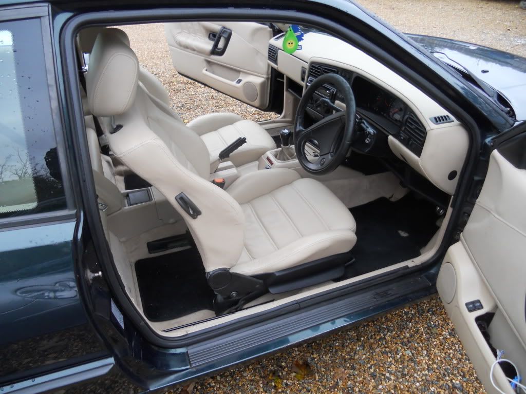

Looks stunning Nick! Big congratulations :) It must be amazing to have the car back finally, and those CH's are the single best wheel on a Corrado.
I hope the bill wasn't too much of a shock. I remember feeling quite faint when Vince showed me the bill for mine a couple of years ago! (I'm not even sure where the battery is for mine at the moment...)
Anyway, weather looks good for the next week, so get that oil leak fixed and put some miles on it!

Thanks Andy, it certainly is great to have the car back. Not sure about CHs being the best wheel - I am a huge fan of the RSs that ChrisL and Harrier have! Not sure if they'd clear my brakes though. Would also PX for LMs if anyone had any ;). The bill was roughly what I had predicted anyway, I knew it would be more than the quoted price but I can sleep happy knowing that everything has been looked at :) Oil leak will be looked at tomorrow so hopefully I can enjoy the car some more over the weekend :)

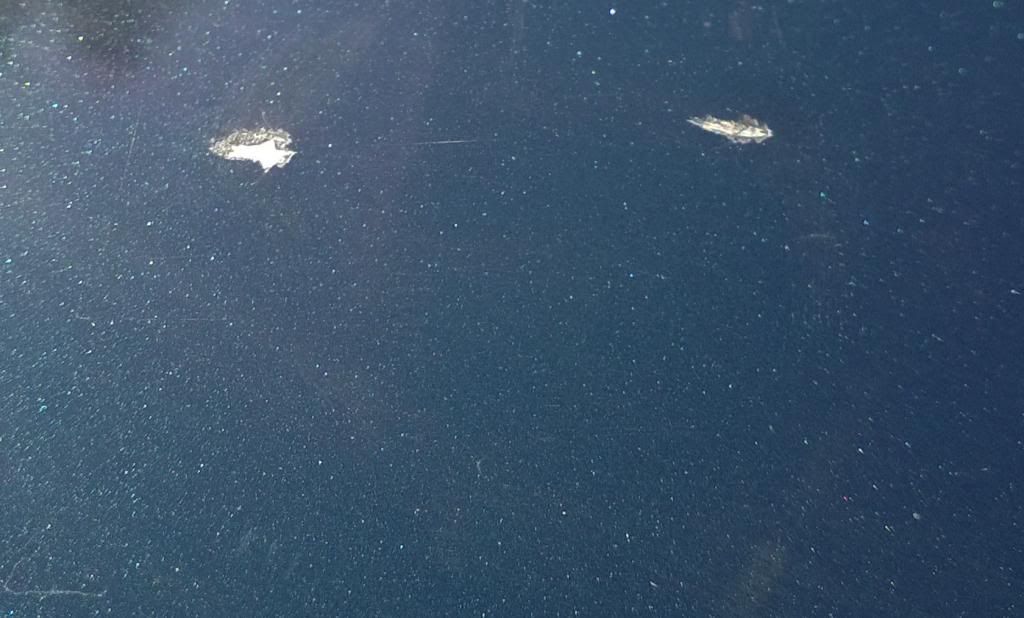

Picked up a couple of BAD stone chips too :( But I'll book it in to the body shop at some point before the national day as it's driving me nuts just looking at them (they're right in the middle of the bonnet!) Excuse the dirt etc.

Yep be prepared for some loud bangs :( stone chips on boost are not fun

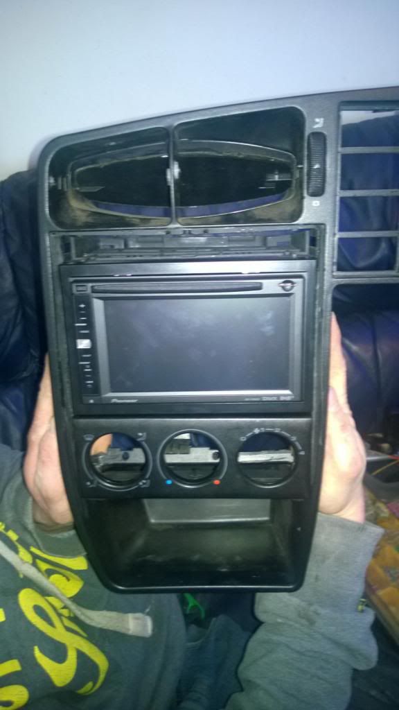

And made a very rough start on the double din conversion. I decided to use a mk4 golf cage as a)it securely holds a double din, and b) heater controls can be mounted using the existing holes.
Mock up of a mk4 cage with Corrado heater controls:

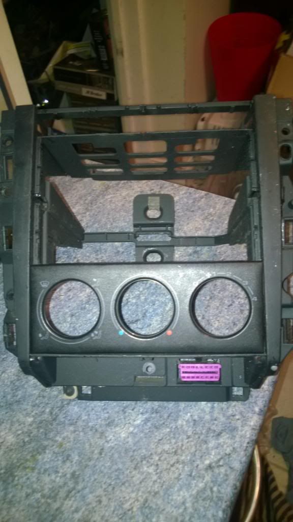

So out with the dremel, and after a lot of cutting and chopping I was left with a rough amalgamation of a Corrado and Mk4 cage. Just held loosely in place in this pic (heater controls), and the "roughness" around the screen (particularly the bottom LH corner) etc was prior to de-burring and smoothing (in fact it's now pretty much invisible). It's currently being araldite-d to all buggery - I'll fix them together in a couple of places too for good measure.
Oh, and the eagle eyed among you will have noticed that I've left the hole for a mk4 cup holder. Bit silly as it will cover half the screen when in use, but much better than no holder!
There's a slight bit of bowing by the heater controls, but no where near enough to deform the existing surround. Going to be a tight squeeze into the dash section! Hopefully I'll be able to pull it off...
I've read a thread on vwvortex where someone said the heater cables could be an issue, but I'll have to see how I get on when it comes to fitting. I seem to remember when changing my dash that there was room for movement anyway. When I get the car back I'll also find a new place to fix the back of the cage to part of the dash innards. Hope this post proves to be useful to anyone else unsure of going double din, as it isn't really well documented anywhere.

excellent idea. Could you mount the heater controls above the cage,perhaps?
I was initially planning to flip the cage around so the controls are on the top and the cup holders at the bottom, but the cup holder cartridge wouldn't have fit down there where it tapers, and there's no allowance for shaving it to fit (whereas the heater controls are more dremel friendly)
Wish I had the nous to fit the climatronic screen... maybe a project for the future :)
You should be ok with the cables. Mine have worked faultlessly for the past 5 years with a double din setup. Although I don't have the cup holders but the extra downwards movement shouldn't make much of a difference. Just make sure they have a nice smooth route and aren't tangled in wiring harnesses.
