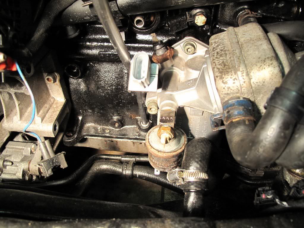

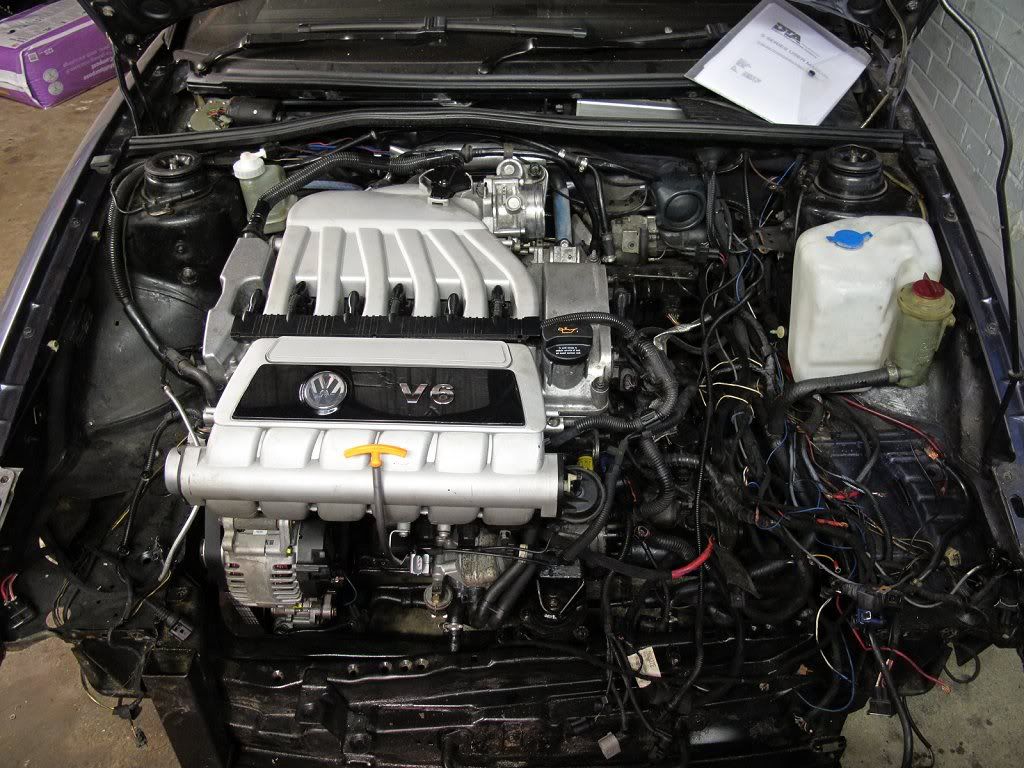

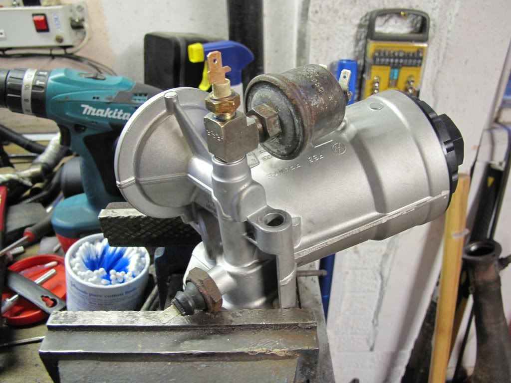

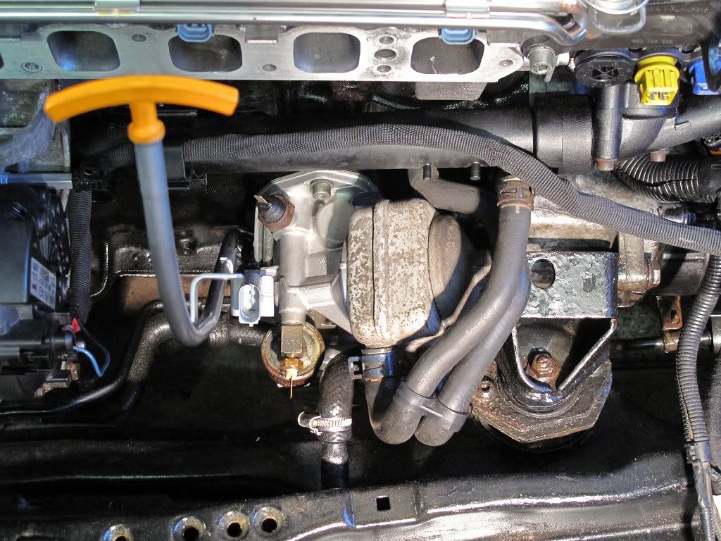

Kevin Bacon 5 Posted September 27, 2011 (edited) Couple of small updates.... I sorted the oil filter housing so I could retain the original oil buzzer circuit, the MFA oil temp and the oil pressure gauge. 24Vs only have one sender, so you need a T peice in the auxillary outlet. I used the T peice from my old VRT but it's 1/8 NPT thread instead of M10 x 1, so I just retapped the housing to suit :D Hanging down conveniently out of the way was a fluke (it's a bulky sender). That's just the position where the T peice happened to fully tighten :D Seeing an R32 lump in a Corrado is nothing new by any means, but I've always loved how they sit in Corrados and the near finished look is spurring me on :D I'd love to run the stock Corrado air box in it's stock location and I'm going to look into it. For me this is just going to be a V6 Corrado, nothing fancy. I want it to look as original and plain as possible. I don't even like the R32's red coil covers, so black is the order of the day :D I've made a start on the wiring too. The factory loom will be connected up in it's entirety (inc knock sensors) in case I want to run the standard ECU at some point in the future, so it will just be a case of switching plugs at the ECU end :D Edited September 30, 2011 by Kevin Bacon Quote Share this post Link to post Share on other sites
