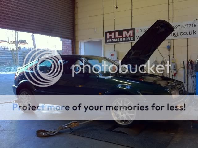

Mr Sands 0 Posted December 8, 2010 Received the following communications from Dave earlier on: "The results are in.......212hp! Nice fat torque curve. Air fuel spot on 12.5! Really pleased with that, this dyno is really accurate. :)" Suffice it to say, that absolutely made my afternoon/early Christmas/year...and I haven't even driven her myself yet, merely heard Dave and Graham say how it goes "like stink", for a N/A tuned VR that is; clearly the more hardcore among you, including the dynamic duo, start forcing induction. Nutters! :D It's OEM+ all the way for me and it doesn't get much more plus than an extra 20 odd bhp above stock and, much more importantly, a big fat wad of extra torque across the rev. range. Granted, I think the low miles on mine (72,200ish) and the simultaneously rebuilt head probably did a good deal to help boost the figures. I'll try to publish any graphs or data that come my way in time but for now, I am one very very happy camper. Roll on tomorrow and I'll be able to tell you all how a VR with DG cams in actually drives! :shades: Oh, it wasn't ALL good news. In the wait for the dyno slot, Dave and Graham found my stash of giant Cadbury's buttons on the under glove box shelf... Quote Share this post Link to post Share on other sites

nemesis360 0 Posted December 9, 2010 As has been said a million times before...you cant compare different rolling roads! As a reference we took an 83k stock VR with us as a comparison and it made 184bhp (unfortunatly we couldnt run Ed's before the cams were fitted as the head gasket had failed), previous runs on this rolling road with different stock VR's have made results within 3 bhp of this figure. The rollers are a 1 year old Dynojet setup. So I know you cant compare between different cars etc etc... but if you take the figure above as a rough guide... 212bhp minus 184bhp = 28 bhp The profile of the cams were chosen to increse torque over the entire rev range (and as we know torque is what makes cars quick) so mega bhp figures were not what we were looking for. Anyway we will get some graphs up once they have emailed them to us and you can make your own minds up :) Quote Share this post Link to post Share on other sites

nemesis360 0 Posted December 9, 2010 I wasnt having a pop at you Kev! You wont see any huge gains over something like SP263's as they are a great cam and weve had great results with them as well, I dont think anyone is going to come up with anything remarkable for a NA VR over what has been done already...weve just come at it from a slightly different angle. The RR results were done as a reference for Ed as he was intereseted and anyone thinking about cams has an idea of what they can do. Quote Share this post Link to post Share on other sites
