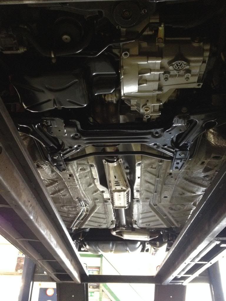

ChrisL 20 Posted May 7, 2014 I finally got the car finished on Thursday night ready for the tracking to be done on Friday. Got a quick picture on the ramps Its maiden journey was down to stanford hall and it was a bit of a nervous drive down but all seems fine!! Next job between shows is taking the stereo system out I think. Quote Share this post Link to post Share on other sites
