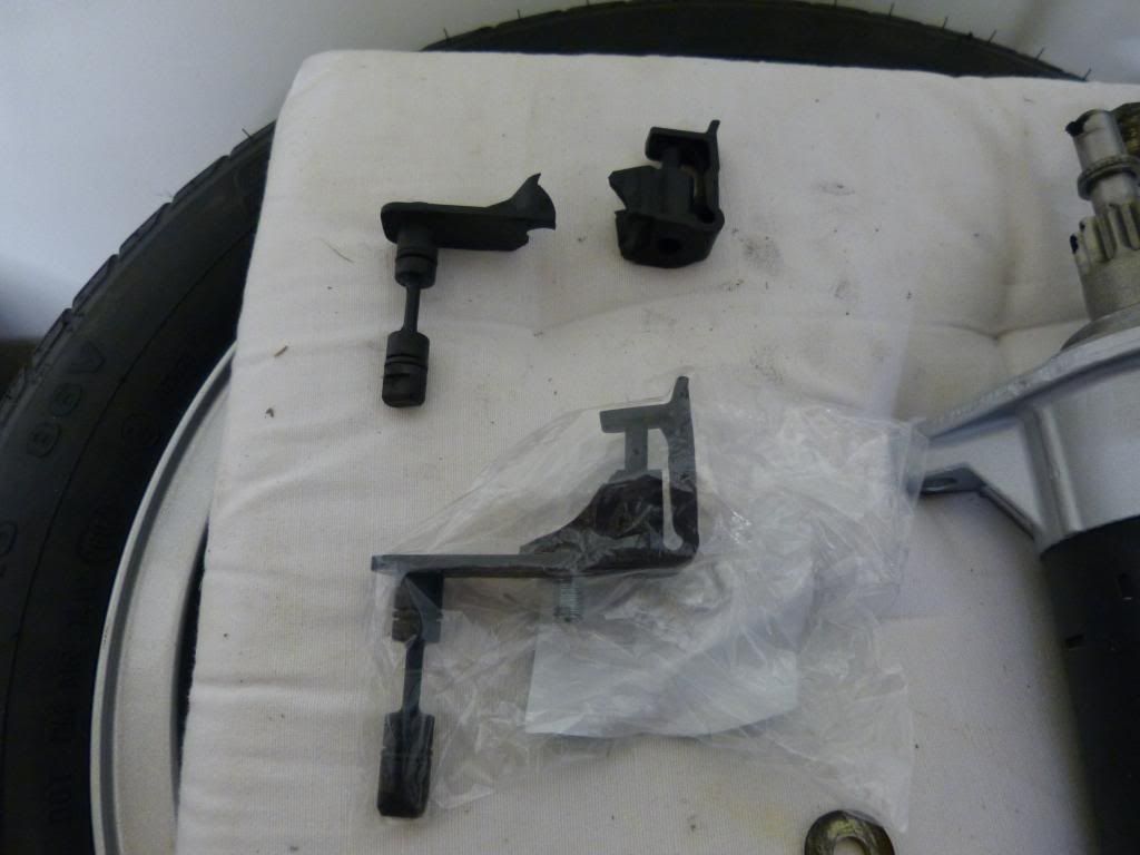

Goldie 2 Posted January 11, 2014 Few more pictures.. Damage on the wheel…minor but enough to need sorting.. Some more of the wiring, its difficult to get decent pictures of this and i wish id taken some before id started. This linkage is connected on to the gear selector cables and when i undid the nut securing it this happened. No ideal, fortunately still available from the dealer, nice new one waiting to go on.. Quote Share this post Link to post Share on other sites

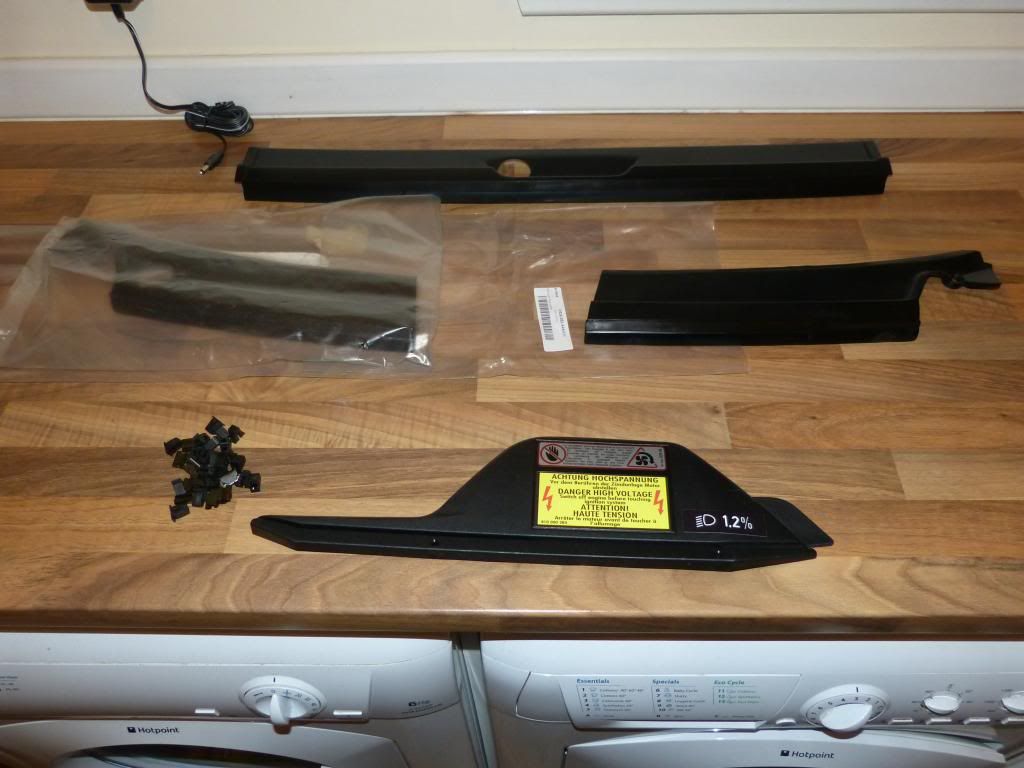

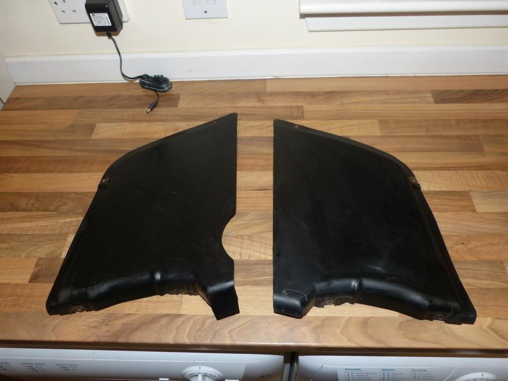

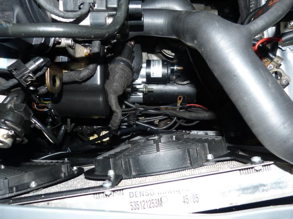

Goldie 2 Posted January 13, 2014 I really do appreciate the feedback, thank you.. I have started with an unbelievably good car that didn't really "need" anything and that is such a good position to be in. This car will never be radically modified, it just doesn't need it.. OE parts with some improvements is the way ahead but it is a challenge, i spend hours looking for bits, part numbers and have a very good and patient parts man at my local dealers. Today i trial fitted the starter but getting the bolts to line up, well they don't so its going to need some persuasion. Here a picture of it in place, it looks nice and will look good once all the cabling is sorted and routed correctly. VW heritage came up trumps with my second arrival from them so have new 2 out of 3 scuttle trims and 1 mint used plus all clips new. Ill do this next. I also got a new radiator cover with new stickers.. Finally here are the air duct things, not perfect but with the screw holes are intact. Some scuffing but that is to be expected. Im only really putting these as I've cleaned the area directly above them and this is to offer some protection. On my old one i took them off after the drivers side was fed to the aux belt.. Ive had to saw off some of the clips, fortunately clips and screws available from the dealers and should be here tomorrow.. Quote Share this post Link to post Share on other sites

Jon_vr6 1 Posted January 13, 2014 When did you order the parts from Heritage Michael? Reason i asked is i ordered before christmas and order processed on the 2nd Jan (prob due to holidays) just wondered what the lead time is on stuff ordered from classic parts via vw heritage. The gearbox/engine has prob moved slightly when you removed the starter so you'll need to use a jack under the gearbox/engine to get it all to line up again. Dont remember having trouble myself but did read that some people had problems. Looking good though fella Quote Share this post Link to post Share on other sites
Goldie 2 Posted January 13, 2014 The wiring for the fan has been modified so is a bit different. Its sat where it is in the picture to allow access to the bolts. It will sit further down over the top of the starter. The sticker i checked against yours Chris and a few others.. I ordered the bits about the beginning of December and i got some stuff before christmas and the others today.. It is a struggle lining it all up and it will have to come off again when it gets to a garage but thats all part of the fun... Quote Share this post Link to post Share on other sites
