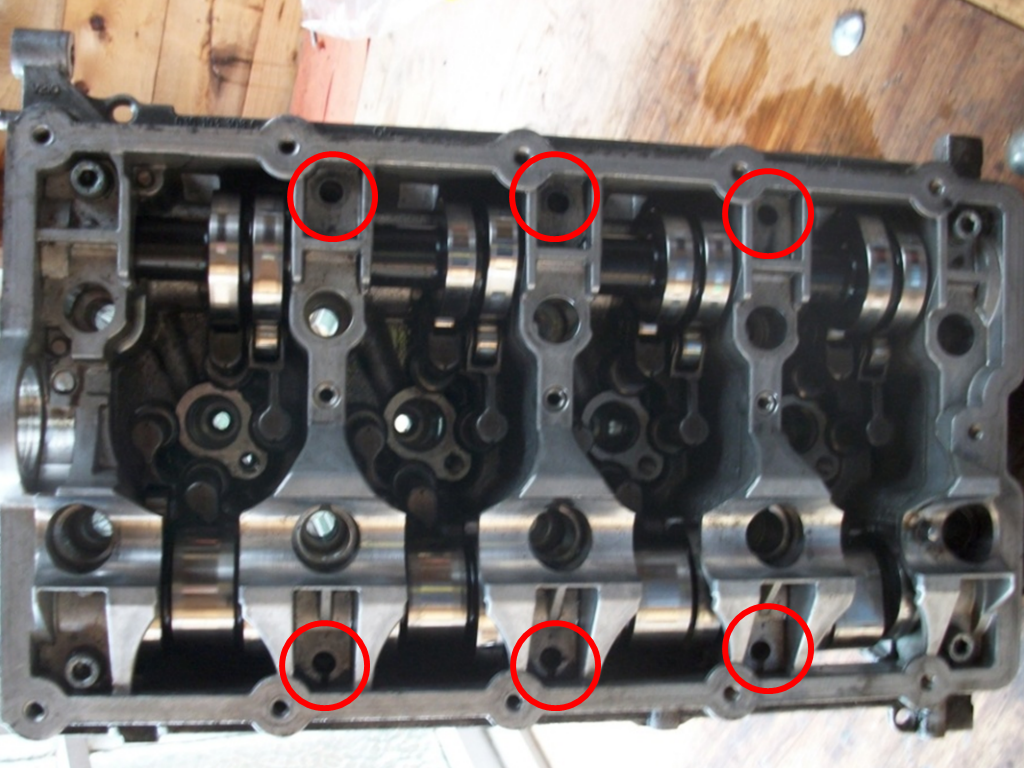

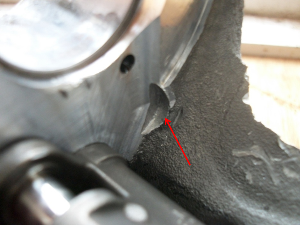

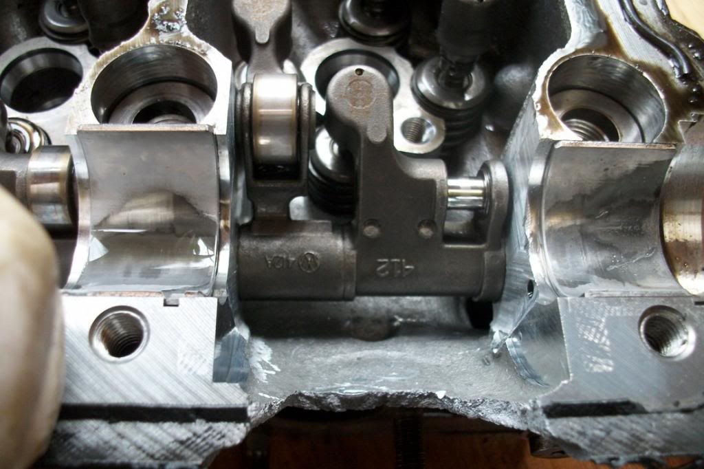

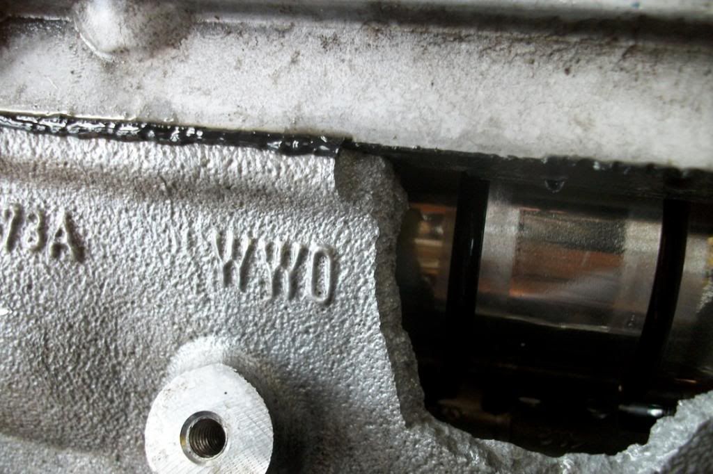

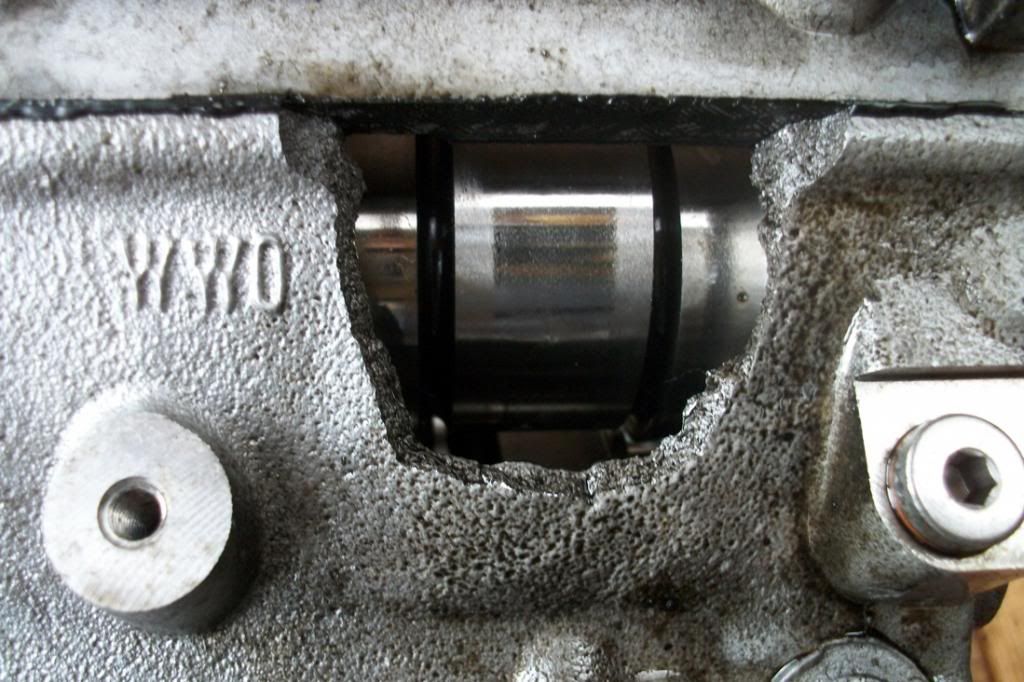

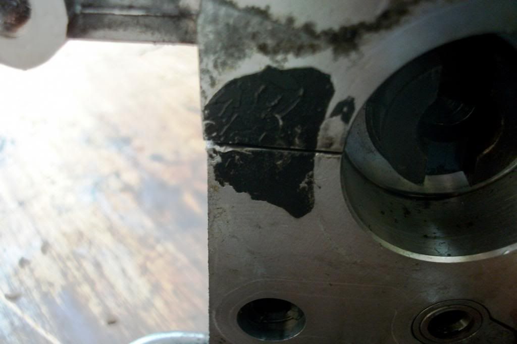

Pickard1 0 Posted January 27, 2013 Ive finally found some time to take a closer look at my 260 pound purchase. The damage wasn't quite as I expected. Here is the hole, I dont think I need an arrow to point it out. This is the exhaust side, so in the car is pretty tight against the bulkhead. After a bit of carb cleaner to clean the oil away you can see that the fracture faces taper outwards (technically called a shear lip) indicating that the fracture progressed from inside to outside of the head. This is where it then got interesting. I noticed that some of the bolts holding on the cam cover seemed to be missing There was also a prize mark where someone had split the cam cover from the rest of the cylinder head. I removed the cam cover. The garage must of had it off as two of the bearing shells were missing. Then i lifted out the cam, to be greeted by this: The observant amongst you might spot that one of the roller followers had disappeared. There was various damage, that seemed to have been caused by the broken segment of roller, but then I noticed this little baby: When the follower was flipped back on itself the mark in the casting was an exact imprint of the follower. It seems that someone had tried to tighten down the top cam cover with the follower flipped back out of position. The cam would have been sitting on the follower incorrectly and had forced the back of the follower through the casting. The force had probably shattered the roller follower as these are normaly made from very hard (60HRc) bearing steel. The fact that the follower had been flipped back the right way shows that they had definitely been in there to try and 'clean up' the evidence, yet had still tried to get my sister to pay. The good news about this is that it seems that the overload was caused by the tightening of a bolt, rather than drive from the crank/cambelt, so I am now a bit more happy with the condition of the cambelt. What confuses me is why did they take the cam cover/cam out for an injector change, surely this isn't part of the procedure? Or is it? Had they maybe dropped a washer or something down there and had to remove the cam to get the dropped part out? Quote Share this post Link to post Share on other sites
