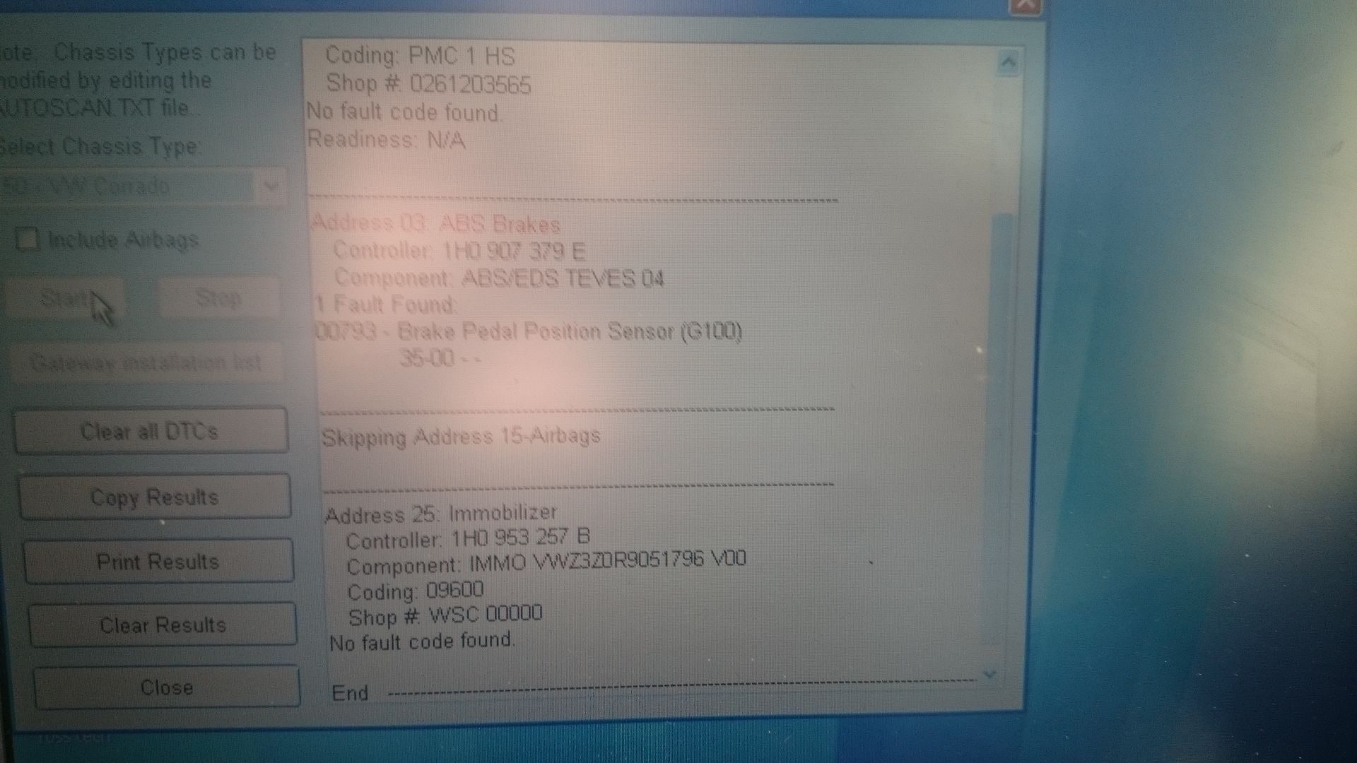

seanl82 23 Posted December 19, 2014 Thought I'd pretty much finished so gave it the first wash and protection since paint. Scuffed my brand new bloody splitter getting onto the ramp before it had even seen a public road. Grrrrr! Then went took it for a quick spin to make sure everything was OK. Apparently not! As soon as I passed about 10 mph, the friggin ABS light came on again! Is this the one on the servo below the master cylinder, or the one behind the dash? I have a spare anyway luckily, but busy until after Xmas now so it'll have to wait. Still awaiting my scuttle clips from Classic parts anyway. This will mean I have replaced the entire ABS loom, the pump, ECU, both rear sensors, and soon the pedal position sensor. The only thing that hasn't been knackered are the two front sensors! Quote Share this post Link to post Share on other sites
Sean_Jaymo 0 Posted December 19, 2014 ABS problems aside Sean, looks great, I've just been out and washed mine and I'm sad to say it's not quite as nice as yours! I've got a spare master servo with a working sensor if you need one? I'm not going to take the risk and separate the pair though. Quote Share this post Link to post Share on other sites
seanl82 23 Posted December 19, 2014 Would the servo throw up this fault if it was duff Sean? I have a brand spankers pedal sensor so it should work. Shouldn't take long to fit and test it but I won't get the chance til at least the 27th now. Quote Share this post Link to post Share on other sites
Sean_Jaymo 0 Posted December 19, 2014 The servo shouldn't throw up any fault electrically. As far as I'm aware it's just the solder that ages in that switch. A nice new one will cure it. Where did you find the new switch? I thought they were obsolete now or have you been secret squirreling away on the Internet? Quote Share this post Link to post Share on other sites
seanl82 23 Posted December 19, 2014 It came up on here a couple of months ago mate. Good price, so I took it! Fingers crossed this is the end of my woes then! I do have another that came still attached to a second hand servo and lines to the abs pump I bought. I'd imagine it still works as it came from a working system. I'll take mine apart then if it's electrical problems that occur and I should be able to refurbish that one as well. Cheers buddy! Quote Share this post Link to post Share on other sites
