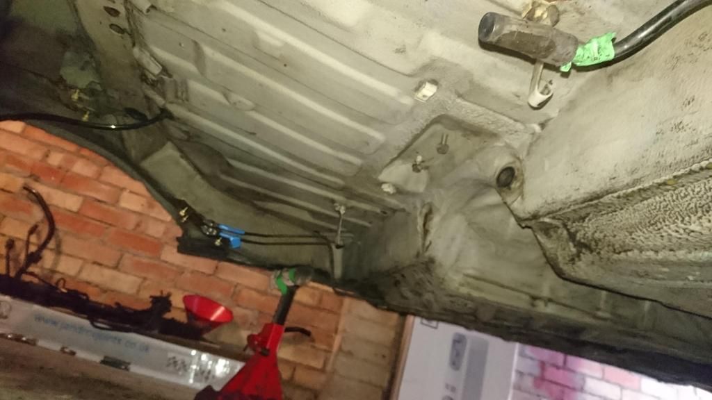

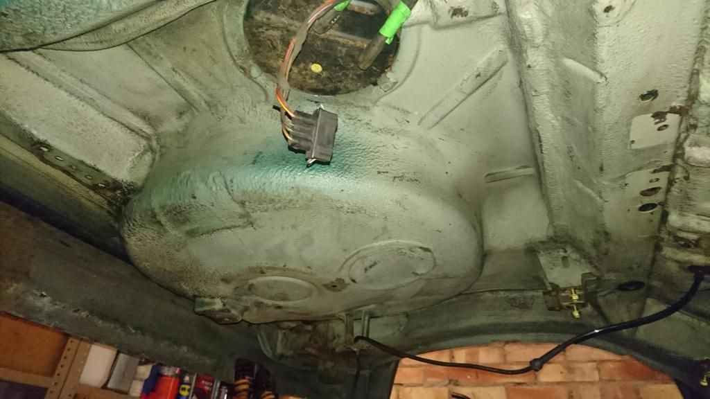

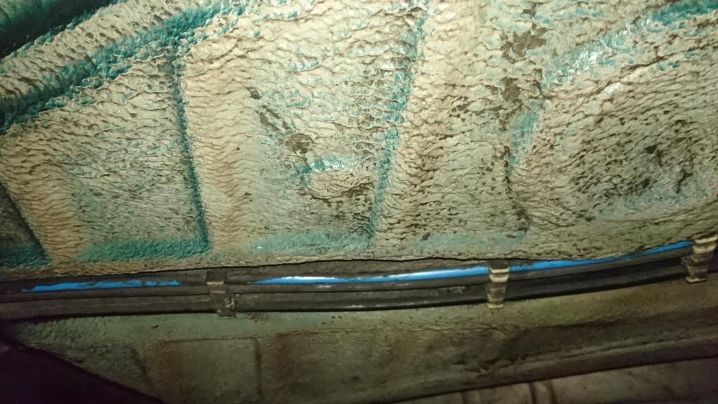

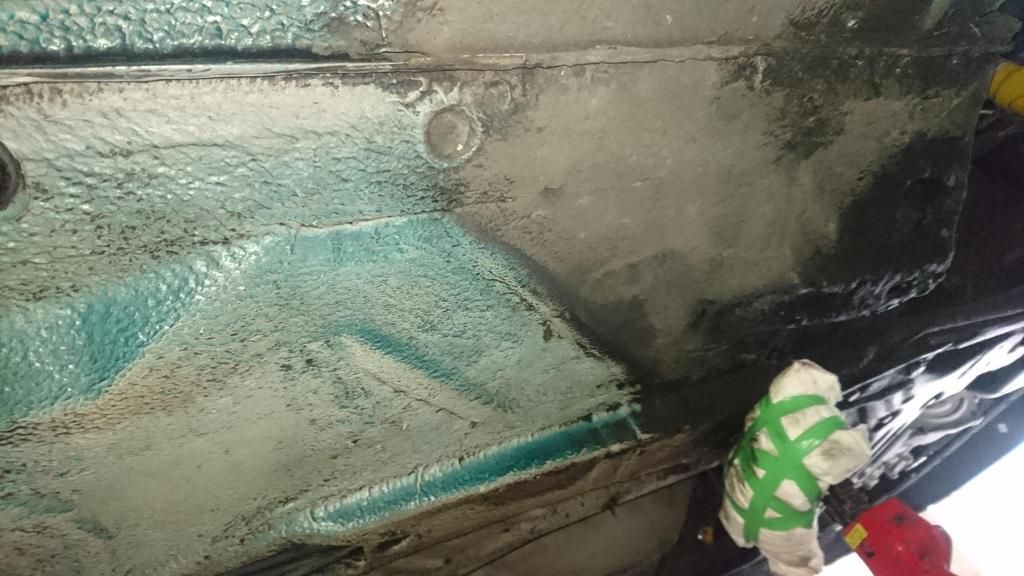

seanl82 23 Posted February 22, 2017 Cheers Rob! :thumbleft: Small update. Had the last couple of days off of work, so with the kids back to school I've had a few hours to crack on with the car and do a bit more cleaning of the underside. I've finished the first pass (pics), and I've since done a second one on the rear end up to the drop where the rear foot wells come down to. First shows a 50/50 side by side after the first pass at the front. I've not done under the fuel or brake pipes yet, as around this area it must have been around 2mm thick with grime so got fed up so moved on and made up the brake pipes from the bias valve back. Happy with how they turned out and the flares are pretty good for a cheap tool. Had to improvise with a few bends as the bending tool I have didn't make sharp enough angles but they've come out pretty well, just need to get them fitted up to see how accurate they are now. I've decided I'm going to get the VW underseal now. Despite the price, I want it to be as close a match as possible to the original and there aren't that many areas that need repairs, mainly around a few studs and brackets. 1 tub should be enough though so I'll get stripping back with a wire wheel, treating then painting it before putting the underseal on around Easter when I next get time on it. Quote Share this post Link to post Share on other sites

seanl82 23 Posted February 22, 2017 Cheers mate. It's messy and pretty unrewarding work but I suppose the MOT tester will get to appreciate it! It's helped identify any nasties that were hidden though, which fortunately aren't many. I upload the pics to photobucket, then link them in. Quote Share this post Link to post Share on other sites
ChrisL 20 Posted February 23, 2017 Looking good Sean, recommend thinners on unpainted areas and turps on the bits underneath that have paint. I'm really interested to know what the VW stonechip is like and if it's the same as the thick rubbery stuff already on the corrado. Quote Share this post Link to post Share on other sites

seanl82 23 Posted February 23, 2017 Looking good Sean, recommend thinners on unpainted areas and turps on the bits underneath that have paint. I'm really interested to know what the VW stonechip is like and if it's the same as the thick rubbery stuff already on the corrado. A bit of substance misuse, but I've been draining the tank and using the old petrol with a nail brush Chris! Its worked a treat to be fair, and I'd have only disposed of the old fuel when it was back on the road anyway. Just need to be careful with any electrics or naked flames! Quote Share this post Link to post Share on other sites
