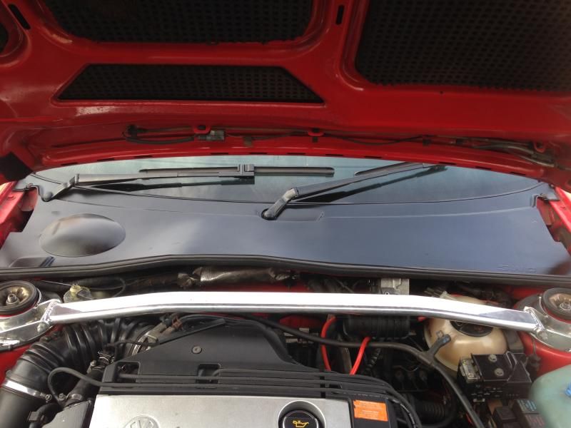

diarmaid16 1 Posted October 22, 2014 Nice job. Looks much nicer finish. Quote Share this post Link to post Share on other sites
g0ldf1ng3r 15 Posted October 22, 2014 very tidy indeed :) Quote Share this post Link to post Share on other sites
loepan 11 Posted October 22, 2014 jamie does that scuttle cover, go all the way over the windscreen wipers or clip underneath it like the existing right hand cover does? damn right it looks better in satin, just purchased a mk2 golf one to adapt thought i had got a bargain, when it was delivered it was the flimsy plastic type one it ended up in two pieces in a fit of rage Quote Share this post Link to post Share on other sites
robrado974 1 Posted October 22, 2014 Looks great , better in satin . we are car nuts , this sort of thing is the norm . Corrado carpet fits in the washing machine just nicely and the dish washer is great for cleaning parts ! Quote Share this post Link to post Share on other sites
sexybourbon 0 Posted October 22, 2014 That does look much better than the gloss i think ill do mine the same , did you just scotch pad it then go direct over it ? Quote Share this post Link to post Share on other sites
Roger Chatfield 0 Posted October 22, 2014 As above, satin looks a lot better, think I'll do mine, what paint did you use?? Rog. Quote Share this post Link to post Share on other sites
GrahamU 6 Posted October 22, 2014 Reading this made me smile which was made better when the wife went 'oh my god' when looking over my shoulder Top job on the scuttle, may have to steal that idea ;) Quote Share this post Link to post Share on other sites
Hairyarse 10 Posted October 22, 2014 That looks great ;) Quote Share this post Link to post Share on other sites
kdub 10 Posted October 22, 2014 looks good boss. Well worth the sacrifice of a rattle canned floor. Quote Share this post Link to post Share on other sites

Jamie 1 Posted October 23, 2014 Didn't prep it at all other than washed it down with fairy liquid, dried it off and gave it a wipe over with thinners. I used satin black Plastikote but a bit of a trade secret here - I dusted on about three light coats at 10 minute intervals, then put on a heavy wet top coat. Then just before that is almost dry, dust on a very light coat from quite a distance. The idea is that this dust coat hits the almost dry top coat pretty much dry. This will give it a nice factory type texture :) Quote Share this post Link to post Share on other sites
sexybourbon 0 Posted October 24, 2014 Exellent thanks mate ill be doing that then , what does the finished thing feel like for mucky marks and finger prints does it seem like it will mark easy with it not having a laquer Also what front strut brace is that it looks great im after ow for the front of mine Quote Share this post Link to post Share on other sites

fla 9 Posted October 24, 2014 Didn't prep it at all other than washed it down with fairy liquid, dried it off and gave it a wipe over with thinners. I used satin black Plastikote but a bit of a trade secret here - I dusted on about three light coats at 10 minute intervals, then put on a heavy wet top coat. Then just before that is almost dry, dust on a very light coat from quite a distance. The idea is that this dust coat hits the almost dry top coat pretty much dry. This will give it a nice factory type texture :) good tip, thanks! I'm a bit fed up with having to keep polishing mine to keep it looking decent. Would bumper paint also be suitable? Quote Share this post Link to post Share on other sites
Jamie 1 Posted October 24, 2014 jamie does that scuttle cover, go all the way over the windscreen wipers or clip underneath it like the existing right hand cover does? damn right it looks better in satin, just purchased a mk2 golf one to adapt thought i had got a bargain, when it was delivered it was the flimsy plastic type one it ended up in two pieces in a fit of rage Sorry mate missed this the first time. It goes over the top of the wiper spindles - ie you have to take the arms off to fit it. Have to take some trim off the bottom of the screen as well. If you're thinking of buying one mate, unless it's an absolute screaming bargain, I wouldn't bother. Exellent thanks mate ill be doing that then , what does the finished thing feel like for mucky marks and finger prints does it seem like it will mark easy with it not having a laquer Also what front strut brace is that it looks great im after ow for the front of mine The finish is fine Matt. Plastikote is quite a plasticky (hence the name) and very durable finish. The strut brace is a very rare and highly sought after Eibach item :D Hasan - pretty sure bumper paint would do the job just fine :) Quote Share this post Link to post Share on other sites
sexybourbon 0 Posted October 24, 2014 Cheers mate ill use the plastcote stuff then Well the brace looks gash id take it off the car and get rid of it lol ! Ill take it of your hands im not bothered about how it looks lol Quote Share this post Link to post Share on other sites

Jamie 1 Posted October 24, 2014 Cheers mate ill use the plastcote stuff then Well the brace looks gash id take it off the car and get rid of it lol ! Ill take it of your hands im not bothered about how it looks lol Hahaha they aren't just rare they are eBay **RARE** so I'd let it go for around £700 :lol: Incidentally if anyone has a dark coloured car, I reckon the scuttle would look excellent painted body colour Quote Share this post Link to post Share on other sites

EJ Taylor 22 Posted November 17, 2014 She's kind of used to it (coming home to find Lambretta engines in bits on the dining table, Type III interiors drying in the bedroom etc) but she's very house proud and still goes nuts about it :lol: Anyway a pic as requested. It's just a standard SWG scuttle with a bit of satin black to give it a more factory look as the standard gloss finish looks arse looks nice man! think im guna get one going by how good this looks, matt finish deff makes it though! guna go wrinkle black i think :D Quote Share this post Link to post Share on other sites
