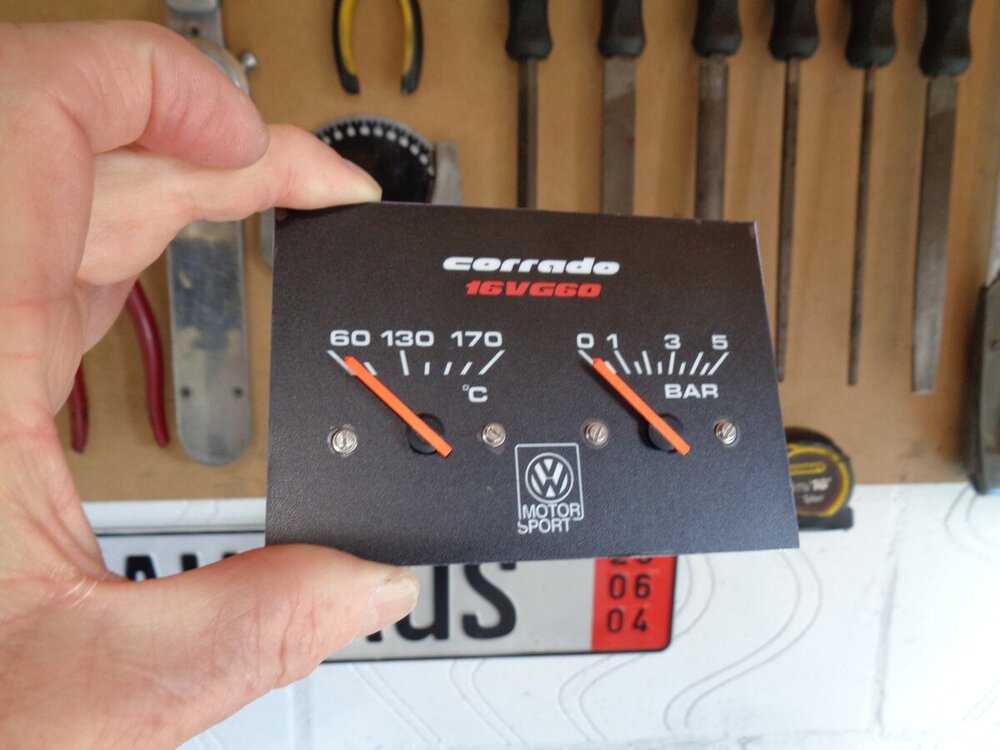

Bauhaus 3 Posted April 15, 2022 14 hours ago, James. said: Good skill. Is that a cassette storage fascia you’ve used ? Yes Mate, the Fisher C box. 2 hours ago, Cressa said: 👍 they do look good. I had to laugh at when you last updated your thread though 😂 Take it you mean the G60 throttle body with a grafted on tps ? the photos for that disappeared during a forum update ☹️ 4 hours ago, fla said: Those look impressive, I'm sure a lot of effort and thought will have gone into them. Thanks, Actually it went a lot easier than expected. 30 minutes ago, fendervg said: Very nice - a true custom build, and you won't be tempted to sell them when you fal on hardship as it's extremely unlikely you'll find a buyer with another 16vG60! 😉 These will be staying with the car or they get sold with the car but not planning on selling car anytime soon. 32 minutes ago, Dox said: You could have saved yourself a load of aggravation and bought a set for £700? superb work btw Yes I could have bought a set for £700 but these cost me next to nothing, the basis for these was the Fisher C cassette box which was already in the Corrado, the VDO oil gauges I had already from my old Mk2 golf which was written off and the printed gauge panel was designed and produced by myself. I will do a write up on how I did these later today. Quote Share this post Link to post Share on other sites

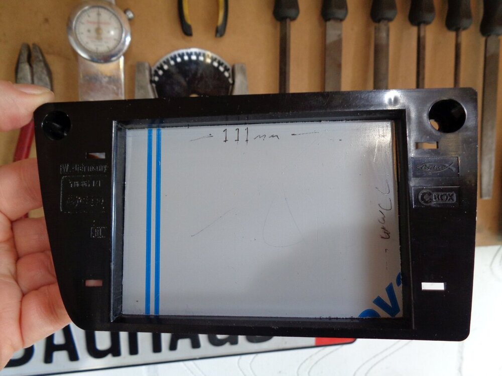

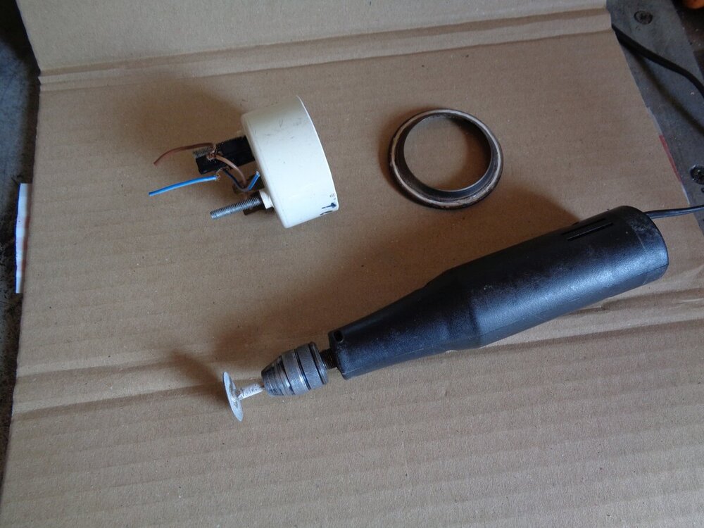

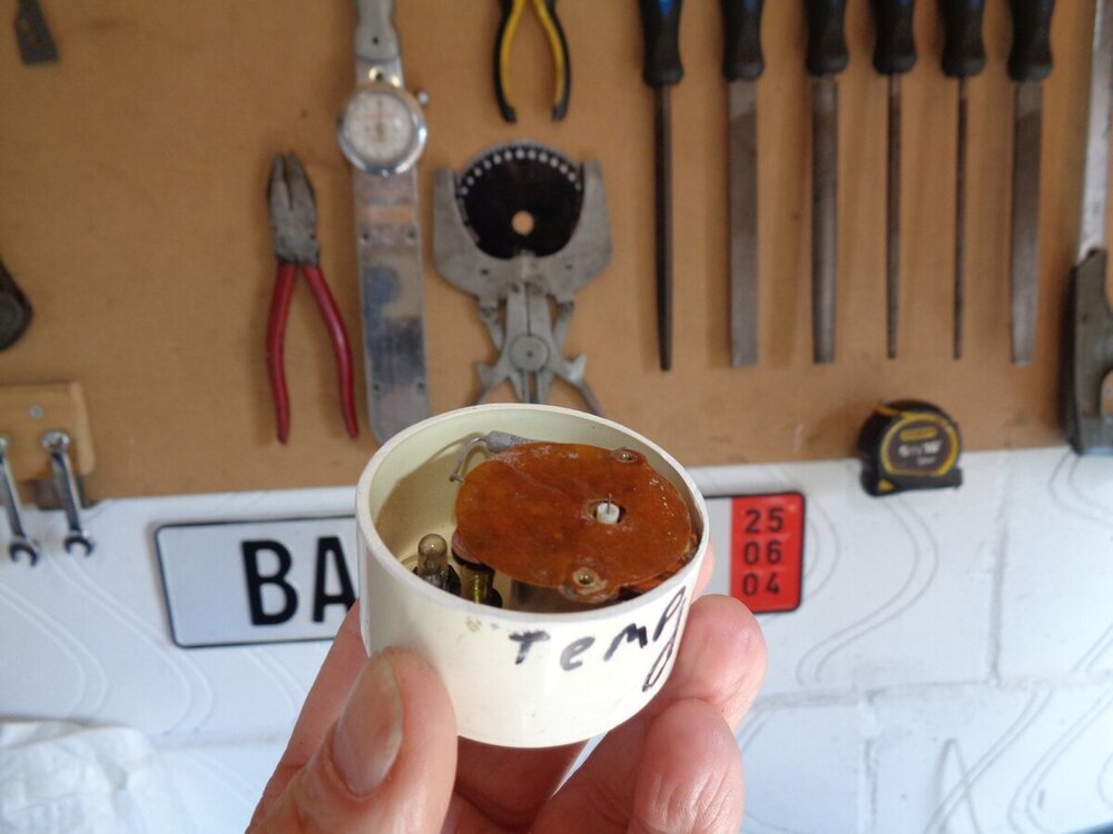

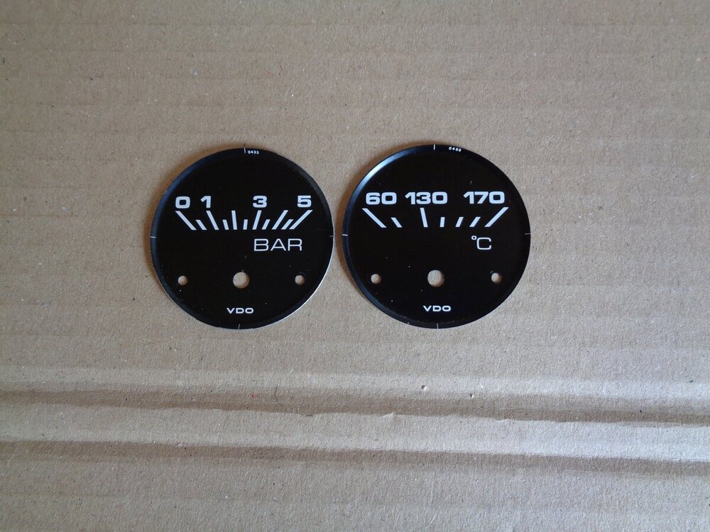

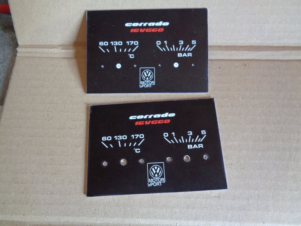

Bauhaus 3 Posted April 15, 2022 Parts needed…. Fisher C box for Corrado VDO 52mm gauges of your choice (mine were oil ones from an Audi 80.. I think) Aluminium or steel thin plate size 111mm x 77mm x 1.2mm 1mm Perspex acrylic sheet A steady hand, good vision and balls of steel. ---------------------------------------- First off strip out the Fisher C box so your left with just the outer framework and front facia ------------------------------------------- Now with your balls of steel cut just below the steel facia of your VDO gauges with a Dremel or similar tool, see pic with the arrow of where to cut ------------------------------------------------------------- Then with good eyesight CAREFULLY square off the plastic in the VDO gauge, there is a convenient ridge inside the gauge to square off to. ---------------------------------------------------- Then with a fork slide it under the needle and pull upwards but be careful and don’t lose the needle. Sorry no pic for this. --------------------------------------------------- Next place the original gauge faces on a piece of paper and scan them to your PC or Mac and use the resulting file as a guide to making the twin gauge face artwork which should be 111mm x 77mm to fit in the Fisher C box. ------------------------------------------------ Print yourself or get a graphic company to print your artwork on white signmakers vinyl and attach it to the Aluminium sheet 111mm x 77mm, (I did two in case of a cockup) Carefully drill the holes for the four screws and the two needles and if your drilling is accurate then the VDO gauges should line up and will mount perfectly, a steady hand and good eyesight is needed to put the needles back. --------------------------------------------------- Last of all get your 1mm thick perpex acrylic to make the window for the gauge housing as per photo Then just assemble all back together, a glue gun is useful for fixing the front screen and possibly fixing the facia to the framework, then your ready to install in the corrado. Job done 😎 Quote Share this post Link to post Share on other sites

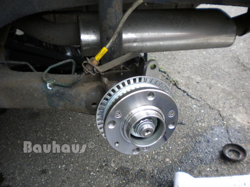

GrahamU 6 Posted June 1, 2022 On 5/3/2017 at 11:04 PM, Bauhaus said: Polo 4 stud rear hub.. this was modified with a golf front ABS ring for traction control. Just looked at your build again and I missed this the first time, that is a great idea and is now on my list for getting the ABS on the rear Quote Share this post Link to post Share on other sites
