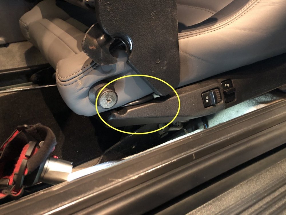

tonedef 9 Posted June 16, 2020 (edited) 1 hour ago, Keyo said: Thanks Shaun . Just the cable end fuse box for the motors - red live single pin and the brown single pni- clearly when stripped from car they just chopped off the fuse box end for convenience I suppose- have already sourced the fuse box connector 161 937 501 that the fuse goes into. All ready have the stock heated loom in place so all good on that. Need part number 701906231 live red + 3A0 922751 brown earth Picture below of the plugs I need if anyone can help- thanks. Anyone know what fuse it should take ? Is it a 20A yellow fuse by chance ? Thanks I’ll have a dig in the garage tomorrow, no promises but I might turn something up. Edited June 16, 2020 by tonedef Quote Share this post Link to post Share on other sites

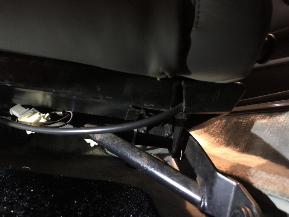

Keyo 47 Posted June 16, 2020 (edited) Pictured of where my motor loom had been cut off. All the rest intact. Edited June 16, 2020 by Keyo Quote Share this post Link to post Share on other sites

Keyo 47 Posted June 16, 2020 I would say that cable hanging out is a new motor put in at some point and they took a crude shortcut prehaps. Quote Share this post Link to post Share on other sites

tonedef 9 Posted June 17, 2020 OK, first things first, I believe I've got your plugs. Red plug is just as you say, 701 906 231, the brown plug was paired with it in the loom I've chopped it from and it looks exactly like the one in your photo but the number is 3A0 972 751 H, I've zoomed in as far as possible on your photo and it looks like it could read that as the number is right on the edge and you can't really see the base of the 2. Unless you're anywhere near M1 J30 on a running in journey, PM me your address and I'll stick them in the post. Next the wiring. Only the heating wire runs up into the backrest as both motors are in the base, the wire you're looking at should run down behind the side trim to the hinge and then come out of the cover underneath to the plugs. I expect yours has broken at the hinge some time and been shortened, you could probably just extend the wire and reconnect it. Quote Share this post Link to post Share on other sites
Keyo 47 Posted June 17, 2020 31 minutes ago, tonedef said: OK, first things first, I believe I've got your plugs. Red plug is just as you say, 701 906 231, the brown plug was paired with it in the loom I've chopped it from and it looks exactly like the one in your photo but the number is 3A0 972 751 H, I've zoomed in as far as possible on your photo and it looks like it could read that as the number is right on the edge and you can't really see the base of the 2. Unless you're anywhere near M1 J30 on a running in journey, PM me your address and I'll stick them in the post. Next the wiring. Only the heating wire runs up into the backrest as both motors are in the base, the wire you're looking at should run down behind the side trim to the hinge and then come out of the cover underneath to the plugs. I expect yours has broken at the hinge some time and been shortened, you could probably just extend the wire and reconnect it. 32 minutes ago, tonedef said: OK, first things first, I believe I've got your plugs. Red plug is just as you say, 701 906 231, the brown plug was paired with it in the loom I've chopped it from and it looks exactly like the one in your photo but the number is 3A0 972 751 H, I've zoomed in as far as possible on your photo and it looks like it could read that as the number is right on the edge and you can't really see the base of the 2. Unless you're anywhere near M1 J30 on a running in journey, PM me your address and I'll stick them in the post. Next the wiring. Only the heating wire runs up into the backrest as both motors are in the base, the wire you're looking at should run down behind the side trim to the hinge and then come out of the cover underneath to the plugs. I expect yours has broken at the hinge some time and been shortened, you could probably just extend the wire and reconnect it. Great news I will send you a pm as your about 2 hrs from me I think as in Brum . I’ll pm you address later and payment . Cheers also great info . Quote Share this post Link to post Share on other sites
