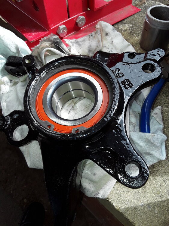

Dox 23 Posted April 23, 2023 14 minutes ago, GrahamU said: just a single circlip 😦 no wonder there was so play I’m sure the VR6 knuckles only have one, the bearing pushes against the cast flange of the knuckle? Quote Share this post Link to post Share on other sites
ABV-VR6 12 Posted April 23, 2023 2 minutes ago, Dox said: I’m sure the VR6 knuckles only have one, the bearing pushes against the cast flange of the knuckle? That's correct! Quote Share this post Link to post Share on other sites
GrahamU 6 Posted April 23, 2023 15 minutes ago, Dox said: I’m sure the VR6 knuckles only have one, the bearing pushes against the cast flange of the knuckle? Ah, I've only worked on G60 and 16v, thought they were the same design just wider, every days a school day Quote Share this post Link to post Share on other sites
Cressa 44 Posted April 23, 2023 27 minutes ago, GrahamU said: Ah, I've only worked on G60 and 16v, thought they were the same design just wider, every days a school day Glad it wasnt just me that thought that.... Although in my defense I had changed the mk2 golf a couple of months ago which had the 2 circlips. But Bentley and the FAG supplied parts suggested 1, which all went together fine. If anyone wants 2 vr6 hubs that have only done a couple of thousand miles, they are Free..... just pay the postage. They still have the inner race on them though 😂😇 I was too idle and have bought new Quote Share this post Link to post Share on other sites

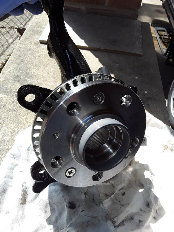

Cressa 44 Posted April 29, 2023 Managed to fit the nearside bearing. Unfortunately I have some rust on the CV joint to deal with, but it is one step closer Always nice to have shiny and painted parts Quote Share this post Link to post Share on other sites

Cressa 44 Posted May 5, 2023 After cleaning them back to bare metal, I soaked them in Hamblit rust remover, degreaser, anti-rust primer and then some plain Halfords black Enamel spray. All finished off with a lacquer coating. Let's see how long this lasts.... Quote Share this post Link to post Share on other sites

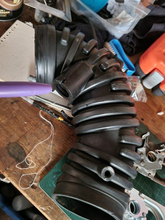

Cressa 44 Posted January 1, 2024 (edited) Happy New year everyone. I'm still no further in this coming out of the garage. I still start her up every week and allow it to get hot and thebfans come on. Whilst doing this yesterday I noticed what looked like some kind of fume/smoke slowly rising up behind pcv valve area. This I had seen when the muffler Box had previously gone bang.. I have taken the rubber inlet elbow off that has a slight split at the rear. So fitted the old plastic one and all seems good. I'm sure I read somewhere that the rubber is a better fit with a Schrick manifold, but the plastic Corrado one fits fine No fumes so far. This year's mission is when the mk2 can drive out of the way, Karmann can get her alignment done and an MOT . 🤞 Edited January 1, 2024 by Cressa Added the pics Quote Share this post Link to post Share on other sites
ABV-VR6 12 Posted January 2, 2024 Happy new year to you as well and I'm glad to see that it was an easy fix, good way to start the year! Cheers Quote Share this post Link to post Share on other sites
ChrisL 20 Posted January 2, 2024 Good news on the fix, hopefully you can get this on the road this year 👍 Quote Share this post Link to post Share on other sites
