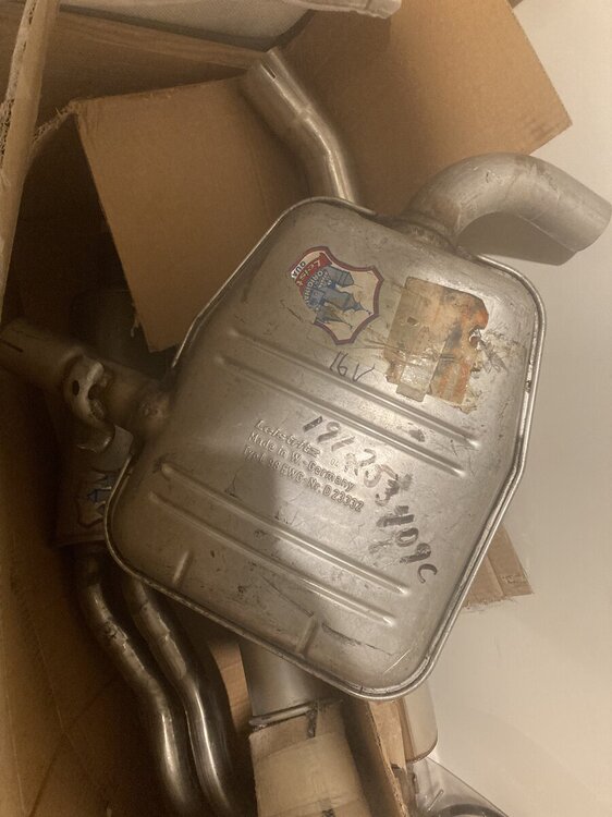

Keyo 49 Posted March 5, 2022 (edited) Yes the factory long life is the best quality money can buy- the oe manufacturer was Leistritz which was later purchased by Eberspacher. Ive been collecting this 16v exhaust for the last few years - some odd nos parts do come up in the States. This is for sale- shows how well its has lasted. https://www.ebay-kleinanzeigen.de/s-anzeige/vw-corrado-vr6-original-abgasanlage-leistritz/1983881640-223-1100 v Edited March 5, 2022 by Keyo Quote Share this post Link to post Share on other sites
ABV-VR6 12 Posted March 5, 2022 Yes, Leistritz was my exhaust line. It only had fine rust on the surface, amazing exhaust system. I had to drop the rear frame to get it out, the middle suit case plus the muffler were in one piece. I sold it but kept the cat. I ordered a 2-1/2" line from techtonics so the engine breathe better. Anyways I'm blown away by the state it is after all those years, it's nuts! Cheers Quote Share this post Link to post Share on other sites
