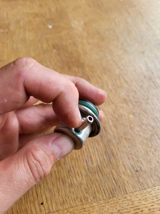

_Matt_ 33 Posted June 3, 2024 Put 100 miles on the car over the last week. Today I'm off work and back home and decided to test the old FPR by putting it back in the car, going for a drive and waiting 15 mins to restart it. It cranks and cranks. Swap back to the bosch 4bar and it the car starts straight away after 15 mins sitting. The only minor issue with the bosch item is that the diameter for the vac line is smaller than the oem fpr. I'll get some smaller diameter vac line to compensate. Oem fpr in the picture. Quote Share this post Link to post Share on other sites

fendervg 33 Posted June 4, 2024 Sounds like the residual pressure was not holding, so the pump would have to build up the pressure again during starting. Quote Share this post Link to post Share on other sites

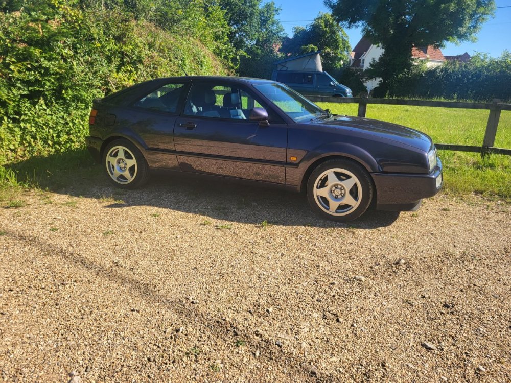

_Matt_ 33 Posted June 25, 2024 Looked good in the sunshine on the school run this morning. Obligatory corner spot away from everyone else of course... it is a pub car park hence the camper in the field. Quote Share this post Link to post Share on other sites

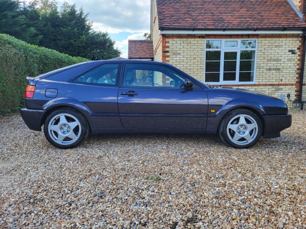

_Matt_ 33 Posted January 20, 2025 And that's another one Sold. Rob the new owner will enjoy it for more than me, plans to 10k per annum on it and take it to Europe. In fact I think he has done more driving with it in one day than I have done for my entire ownership. I had started talks with Rob before Christmas and sent him about 30mins of video talking through the car, but decided yesterday morning to let it go and after seeing a few Corrados without success he left his house almost straight away and came up with his Son and took it there and then. Great bloke and very easy sale. That was my last Corrado, awesome cars but I just fancy something more modern, useable in all weathers without concern for salt etc. Cayman 981 S I think, or a 911 (early 996 with aero kit would be great). Also bought a Tesla Model 3 and a Tesla Model Y at the weekend. All change! I gave Rob some parts but still have a stash of fog lights, indicators, headlights, headlight lenses, new scraper seals and lots of other bits to work my way through. Will be listing on ebay but obvs if anyone wants anything let me know. Would prefer lights are picked up in person. Quote Share this post Link to post Share on other sites

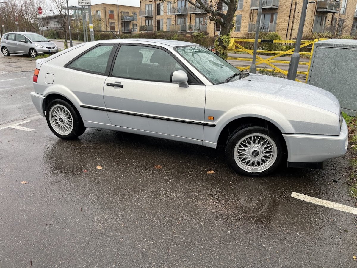

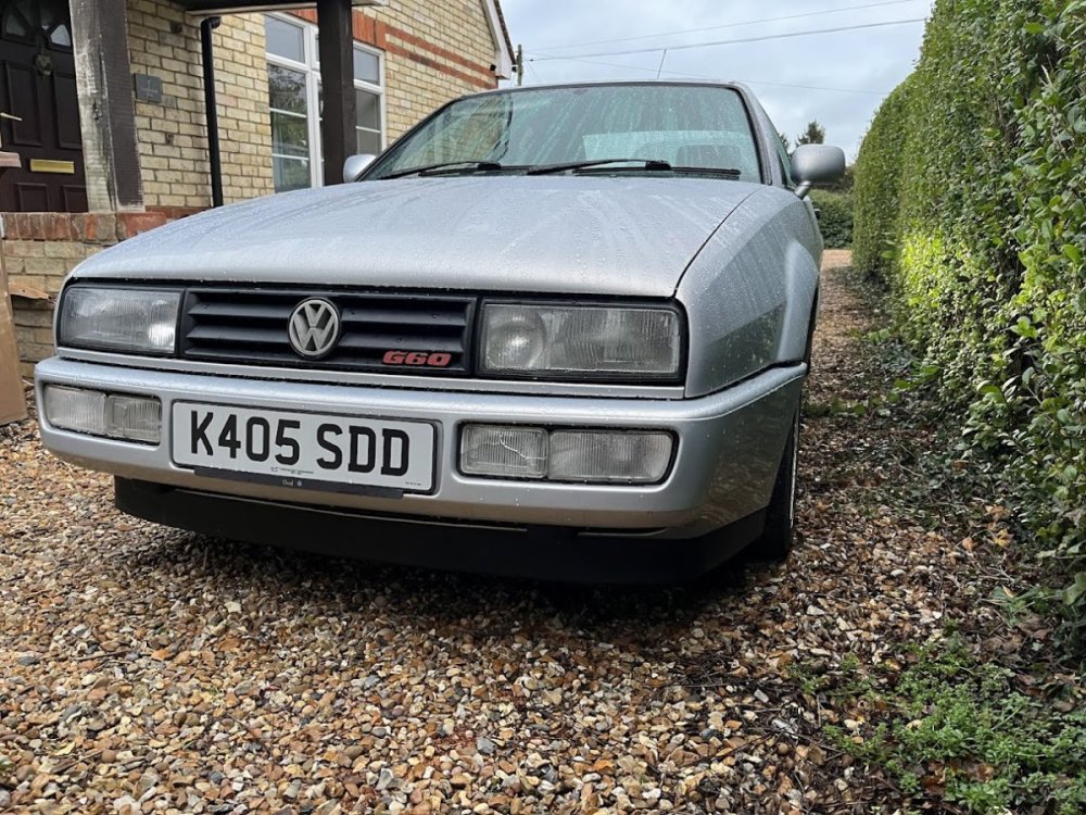

_Matt_ 33 Posted November 26, 2025 Back on track after a few months of weakness with no fun cars 😃 G60, it was on eBay and Car and Classic, higher miles - 149k - but well looked after. One of its owners was apparantely an aircraft engineer and everywhere I look I can see a job I would have done but it is already done. It came from Somerset and I am the first owner to take it away from within 10 miles of it's supplying dealer. It is mostly stock, all I can see so far is Bilstein yellow dampers on standard springs, powerflex rear bushes, a jabba charger rebuild (assume their standard one looking at the price) and a stainless 2 silencer cat back exhaust that has been made to look like the original. The seller was a great guy and we built up a good relationship during the buying process.... which was fortunate as when I went to transfer the remaining money over to him on the day my bank flagged it as fraud and the banking app wouldn't let me in. We waited around for a couple of hours for a "fraud officer" to be allocated to the case but the issue was unresolved (until the following Saturday morning). He let me take the car home on trust, as although I could see the money had left my account before the bank locked access to it, he had not had the money in his bank. This is something we know we should never do when selling cars and the risk was on him. He obviously knew the car was awesome and I would never have messed him about anyway so I am pleased he trusted me to let that happen. It was 3 hour drive home and my friend drove the car home as I was in my EV, it didn't miss a beat. And awesome it is indeed. I quickly looked at the sills when I collected it and was happy but when I got it home and crawled underneath it is even better: It is immaculate and original and easily the best one I have had condition wise (twilight one really needed the axle and frames refreshing due caked on rust, which I did do), this one hasn't been refurbished but is just clean and spot of lanoguard will preserve it. Even the rear tow area is rust free and clean. All my other ones needed wire brushing and sorting out to tidy up that bit. Body work is great, just one bit of rust to tend too in the corner of the rear screen. Like the blue hinge to the silver. Even the drivers door has not dropped and closes as perfectly as the passenger side. And my purple one had a tiny bit of up and own play in the steering wheel but this one is solid. Interior is black leather and original and doest not rattle too. Some pics, also some of the TT for those intersted. For couple of grand paid the TT is a hell of a lot of car for the money (recon dsg box 9k ago, £1500 of suspension and brake work done last year, chains well within in tolerance on the computer but even if I had to do them later down the line I wouldn't be too upset given the price I paid, serviced every year since new). I have stripped the arch lines etc and cleaned/inpsected + lanoguarded, no rust. I also replaced the rear shocks and springs as one had snapped and both shocks looked tired. Had the wheels refurbished back to silver. It's also got a custom exhaust on it that had been made to original specs but stainless. Pics: Quote Share this post Link to post Share on other sites
ger040 4 Posted November 26, 2025 7 hours ago, _Matt_ said: Back on track after a few months of weakness with no fun cars 😃 G60, it was on eBay and Car and Classic, higher miles - 149k - but well looked after. One of its owners was apparantely an aircraft engineer and everywhere I look I can see a job I would have done but it is already done. It came from Somerset and I am the first owner to take it away from within 10 miles of it's supplying dealer. It is mostly stock, all I can see so far is Bilstein yellow dampers on standard springs, powerflex rear bushes, a jabba charger rebuild (assume their standard one looking at the price) and a stainless 2 silencer cat back exhaust that has been made to look like the original. The seller was a great guy and we built up a good relationship during the buying process.... which was fortunate as when I went to transfer the remaining money over to him on the day my bank flagged it as fraud and the banking app wouldn't let me in. We waited around for a couple of hours for a "fraud officer" to be allocated to the case but the issue was unresolved (until the following Saturday morning). He let me take the car home on trust, as although I could see the money had left my account before the bank locked access to it, he had not had the money in his bank. This is something we know we should never do when selling cars and the risk was on him. He obviously knew the car was awesome and I would never have messed him about anyway so I am pleased he trusted me to let that happen. It was 3 hour drive home and my friend drove the car home as I was in my EV, it didn't miss a beat. And awesome it is indeed. I quickly looked at the sills when I collected it and was happy but when I got it home and crawled underneath it is even better: It is immaculate and original and easily the best one I have had condition wise (twilight one really needed the axle and frames refreshing due caked on rust, which I did do), this one hasn't been refurbished but is just clean and spot of lanoguard will preserve it. Even the rear tow area is rust free and clean. All my other ones needed wire brushing and sorting out to tidy up that bit. Body work is great, just one bit of rust to tend too in the corner of the rear screen. Like the blue hinge to the silver. Even the drivers door has not dropped and closes as perfectly as the passenger side. And my purple one had a tiny bit of up and own play in the steering wheel but this one is solid. Interior is black leather and original and doest not rattle too. Some pics, also some of the TT for those intersted. For couple of grand paid the TT is a hell of a lot of car for the money (recon dsg box 9k ago, £1500 of suspension and brake work done last year, chains well within in tolerance on the computer but even if I had to do them later down the line I wouldn't be too upset given the price I paid, serviced every year since new). I have stripped the arch lines etc and cleaned/inpsected + lanoguarded, no rust. I also replaced the rear shocks and springs as one had snapped and both shocks looked tired. Had the wheels refurbished back to silver. It's also got a custom exhaust on it that had been made to original specs but stainless. Pics: Looks a good one - best of luck with it My own is a K reg also 1 Quote Share this post Link to post Share on other sites

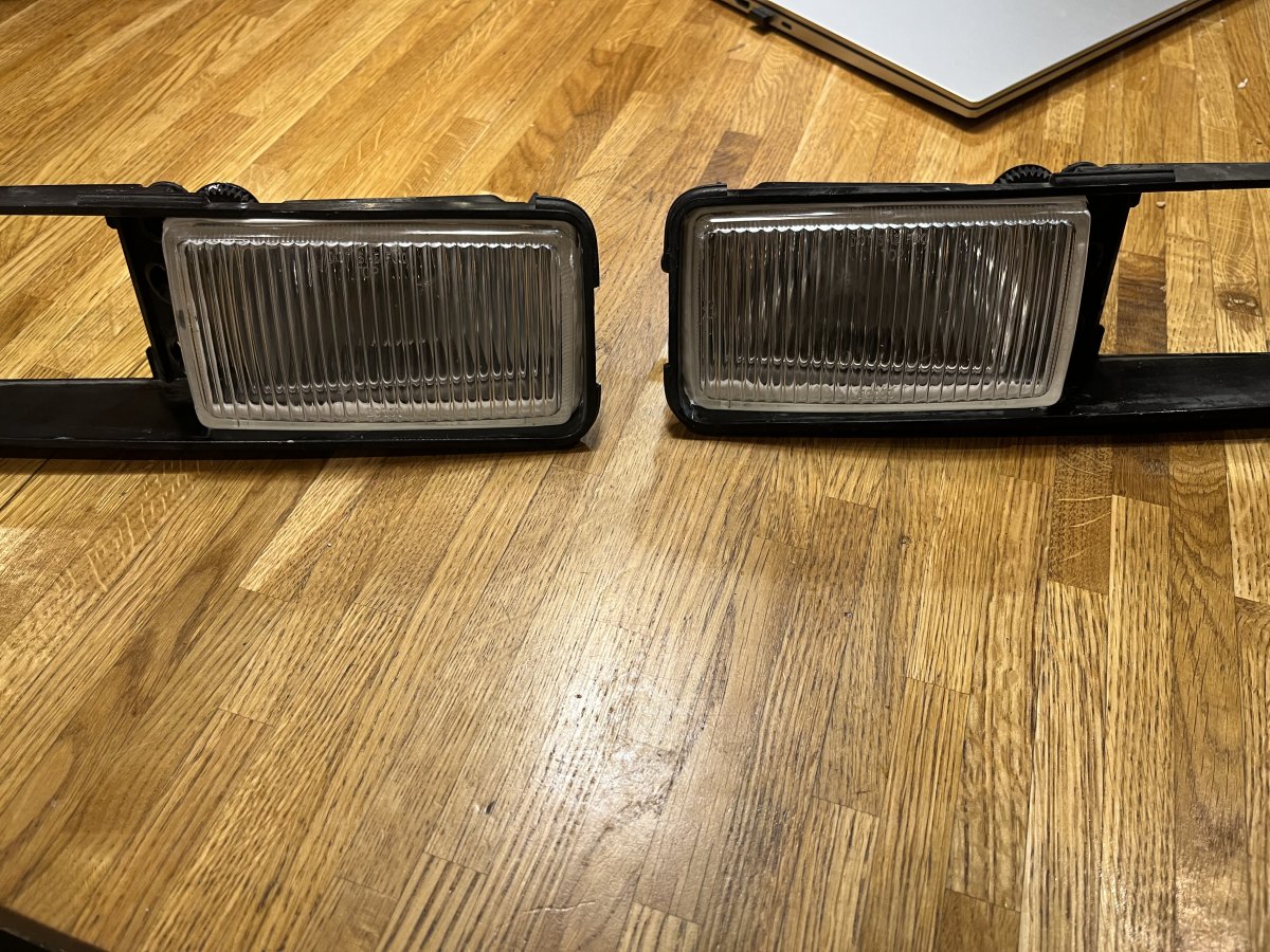

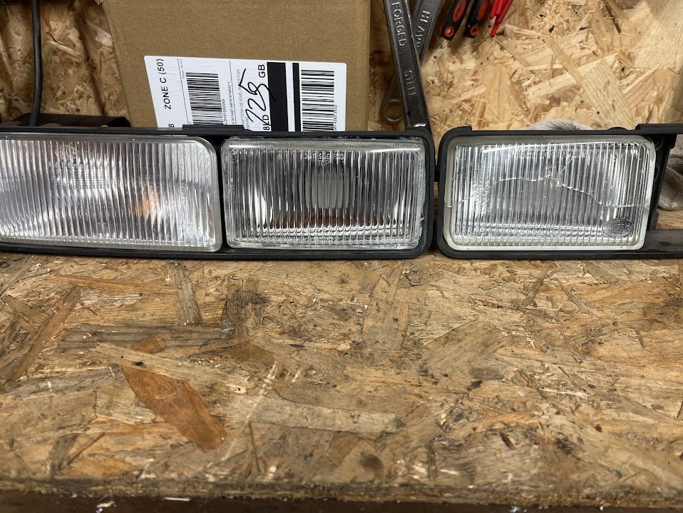

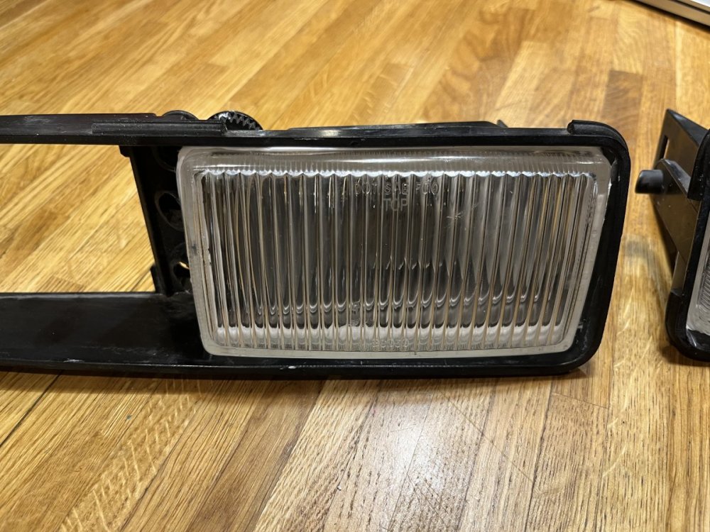

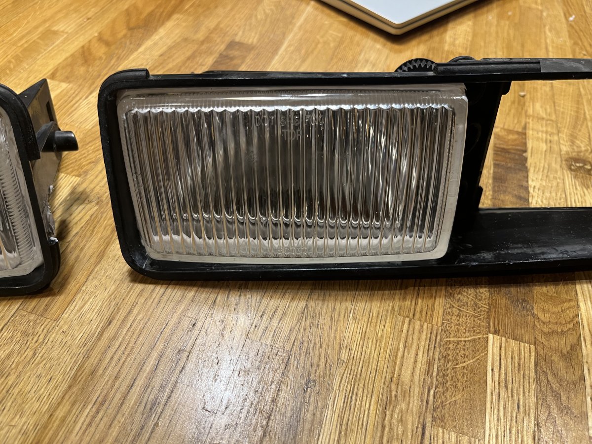

_Matt_ 33 Posted Friday at 11:15 AM No updates yet other than to say I am booked onto the Corrado European roadrip for 2026 with 7 others. The Corrado goes to Stealth in March for a service and any preparations required. Should be a good 2026 for the car. I am working on the fog lights at the moment and replacing with some plastic resin items found on etsy. Will update shortly with findings. They are copies of a lens that is similar to the Corrado fog (The Europarts lenses (63211468127)) but not exactly the same. The Europarts lens needs modification to fit, which the seller has done on the resin copies. https://www.etsy.com/uk/listing/1856402752/corrado-mk2-foglight-lenses-remake-set-l Here is pic before bonding it, it will look better with the correct white sealent. For £60 I thought i was worth a try... Quote Share this post Link to post Share on other sites
_Matt_ 33 Posted Sunday at 07:29 AM Bonded in, looking good enough for me. Quote Share this post Link to post Share on other sites
