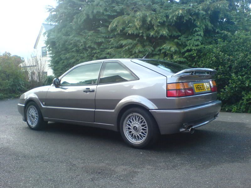

g60ff 0 Posted March 2, 2007 I love my weitec kit, for the money i doubt you can get better, bit rough on some roads but then the roads round here resemble the surface of the moon! The handling is excellent. Crappy phone pic but gives an idea of ride height... [align=center][/align] Quote Share this post Link to post Share on other sites
