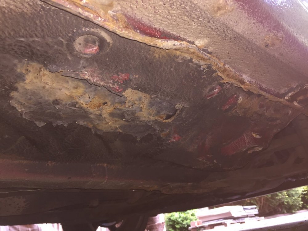

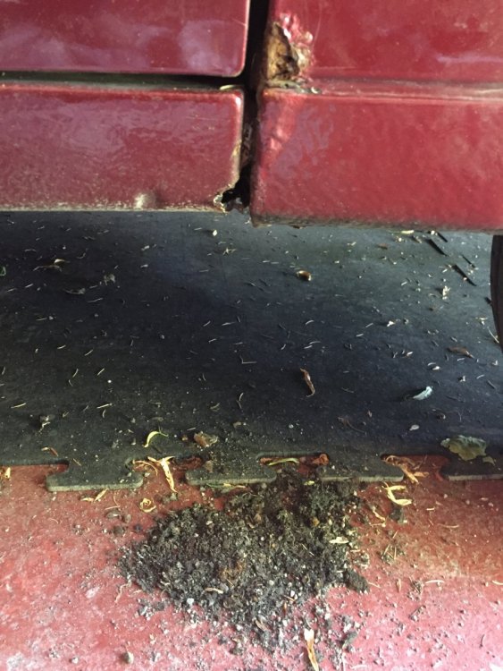

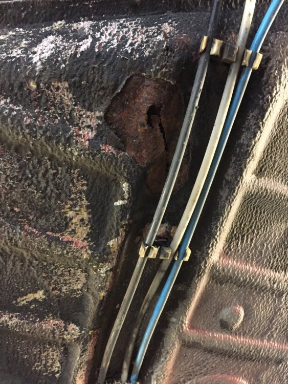

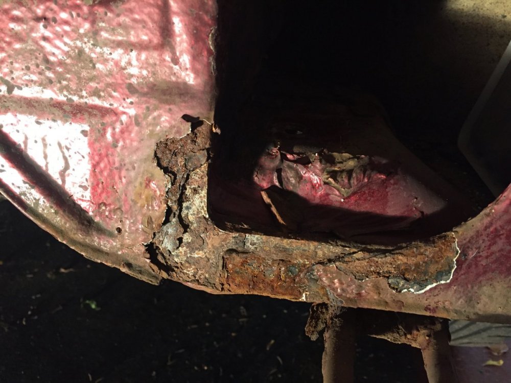

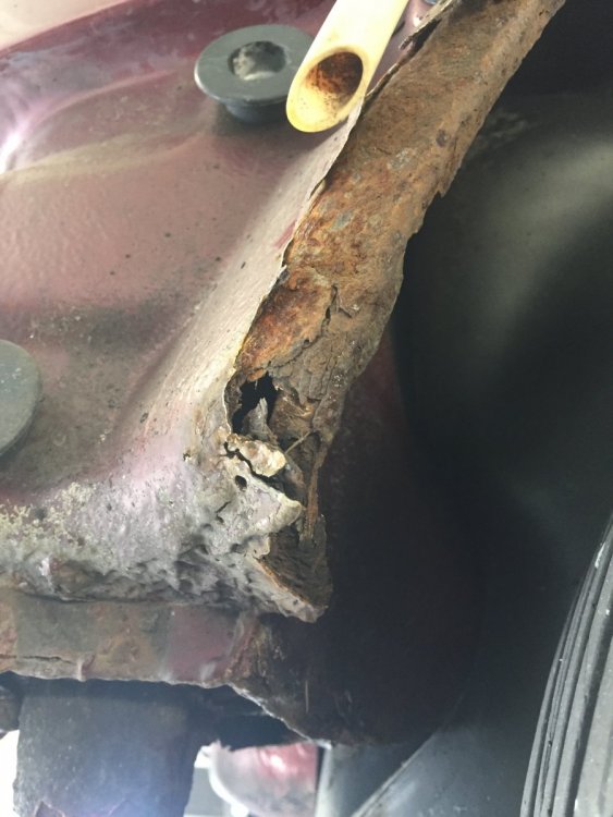

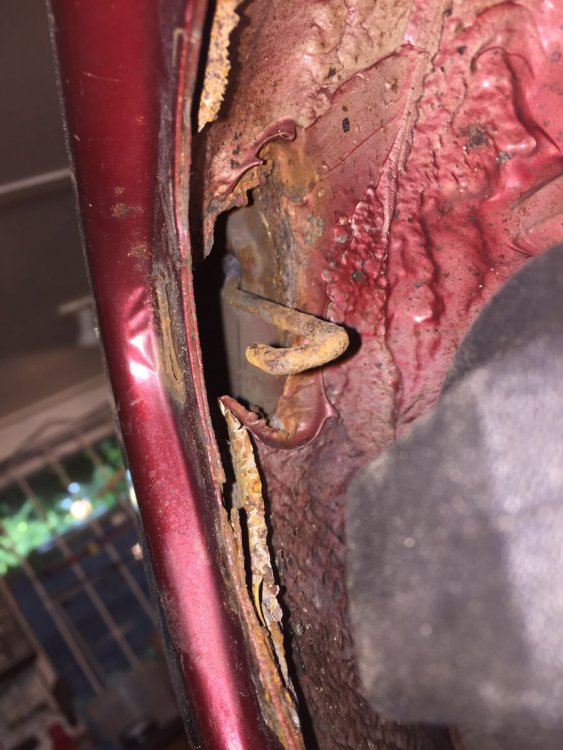

James. 9 Posted May 13, 2020 Stay with me... It’s fair to say I’ve wrung every pennies worth of enjoyment out of the old 8v. It’s been an incredibly faithful servant to the family. Taking us on holiday, being used as a daily driver and over the past few years as a work horse whilst I restored an old house. So this week, with the other Corrado finally out of the garage, and an extra few hours on my hands, I backed the 8v in, with a view to hopefully breathing new life into the ageing paintwork. Remembering how the 8v required a small amount of welding for the previous three or so MOTs, I thought it prudent to check the underside before any top half work is carried out. I started with the rear drivers arch as this had an amount of grot that required priority attention. The next two hours removing the rear bumper should have been a warning. First three bolts withdrew with relative ease. The fourth crumbled like flakey pastry. After half an hour with the grinder and another half with the drill, the bolt head gave way. Upon removal, the rear apron was found to be heavily rusted around the mouth of the bumper mounts. I worked my way around the car. Stopping at the holes along the fuel lines. The fuel line mounts that have rusted loose and the front cill that contained half a cup of grit and dirt. Wanting to gain clarity on the cill, I became ever more frustrated at being unable to remove the front bumper bolts, and therefore the front wing. The final straw was finding that the mud collecting in the inner fold of the filler neck was acting as structural. Admitting defeat, I retired indoors. So what am I getting at ? The answer is I don’t know. I don’t know whether to laugh or cry. Laugh at all the joy we’ve had together, or become upset at thinking is this the end for the 8v ? Values have risen to the point where the car may be worth saving. I desperately want to keep it and not break it, but the welding bill alone could reach four figures (my welding equipment is in storage, where I can’t get access). Anyone been in this situation ? Any advice is warmly welcomed. . Quote Share this post Link to post Share on other sites
tony_ack 0 Posted May 15, 2020 Oh no, it doesn't look too great, and I know how crushing it feels when you are hoping that the rust you see doesn't go too deep, only to find horrors underneath when you finally bite the bullet and start stripping it back. I'll be honest, it doesn't look too great. I was in a similar position to you a few years ago, but it wasn't quite as bad. I considered breaking, but in the end was determined to fix it. Like you, I was worried about the cost of repair, and even considered doing it myself, despite not being able to weld. I finally got a bit of money aside and got a quote - it wasn't as bad as I thought. I got the welding done, new sills, repairs to the rear apron (not as bad as yours, but a couple of holes higher up, and also a hole in a similar place to yours under the bumper on the rear quarter. I painted myself which wasn't the best job, but enough to get through last winter. I don't regret it one bit - if you can already justify the cost against the rising prices of the cars, then you're almost there. But I fixed mine for the same reason you want to fix yours - the car has been through a lot with me over the years and I wanted to keep hold of it as long as I could. Quote Share this post Link to post Share on other sites
seanl82 23 Posted May 16, 2020 It's not something anyone wants to say, but the fact it's so bad in the visible areas means its likely to be not far behind in others (underneath the underseal). I think your next step is to attempt to strip back the underseal all the way along the sills, any areas that are split even if just slightly - paying particular attention to jacking points, mounting studs and the areas with visible rust. Grind or peel it all back until you get to clean primed factory metal, as it'll need welding to that point anyway and will make for a much more accurate quote for welding. If you strip the interior, carpets & sound deadening etc, it'll also keep costs down too. The painting is likely to be where you'll be hit hardest financially. It's a hard one as 8v are toward the bottom end for values, so the amount of work required probably doesn't make it financially viable. That said, the emotional attachment you obviously have with it is what will determine the outcome and is something only you can decide. Stripping everything back and out to find the full extent of it, then getting a few quotes should give you a better idea. Have any mates or work colleagues with a Mig? Even local Corrado owners who may be willing to help will keep costs down too. Best of luck with it whatever you decide mate. 👍 Quote Share this post Link to post Share on other sites
