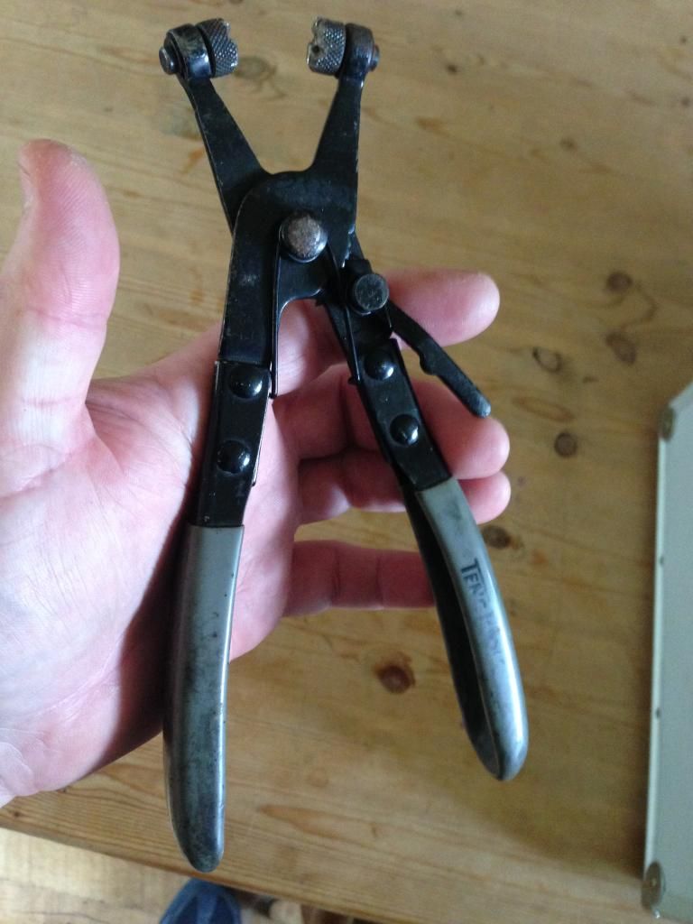

borachris 0 Posted August 19, 2014 For some reason web links aren't working on my phone so I can't see what the other guys are recommending but probably similar to my teng one, I had a cheap version years ago but it fell to bits, this one has been abused for 7+ years and still works! You can also get a remote one on a wire that's handy for hard to reach places but the one I've seen was limited to small-medium size clips. Quote Share this post Link to post Share on other sites

borachris 0 Posted August 20, 2014 Yeah the ratchet bit comes in handy, one handed operation if you use it with your thumb ;) The only problem I've ever had is when I released the big maf clip and it wouldn't quite open up enough to go back on, I had to squeeze the clamp with my hands whilst the wife put the tool back on, that was an experience lol Quote Share this post Link to post Share on other sites
