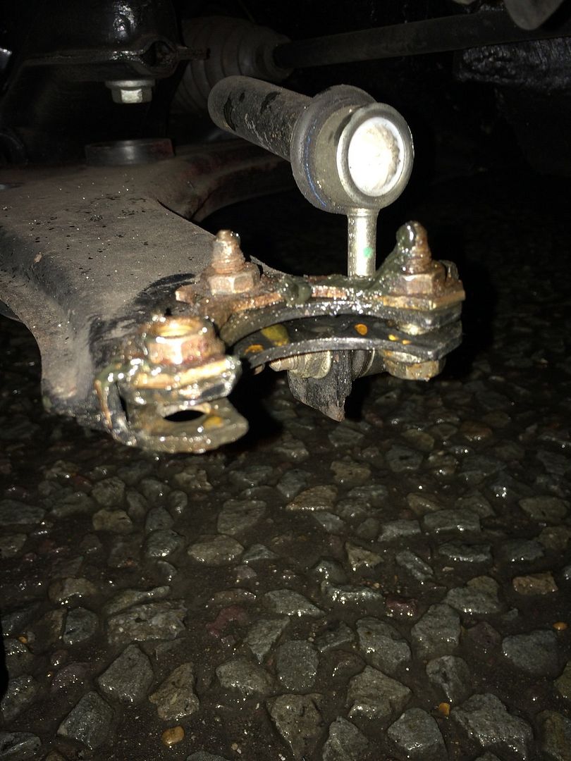

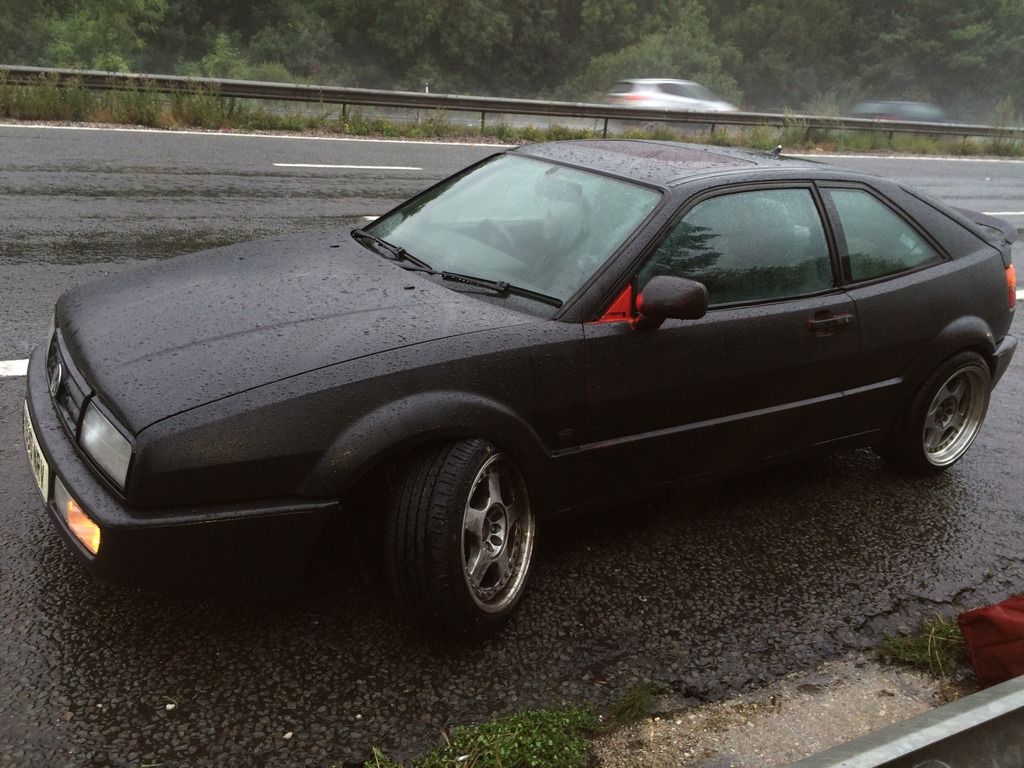

Bs6VR6 10 Posted July 25, 2015 (edited) Well, had an interesting Friday night. On our way to hot-rod hayride yesterday, M4 is heavy and the rain is lashing down. Traffic ahead is slowing and eventually stops. I go to pull away and feel a horrendous clunk from the front left, can tell straight away something catastrophic has happened. Get out and passenger wheel is hanging off lodged under the arch. Driveshaft hanging there. Thankfully two guys in a pickup managed to pull the stricken car from he middle lane and onto the hard shoulder. 3 hour wait in horizontal rain to be collected. Reason? It appears the lower balljoint had not been correctly attached. Of the three bolts that hold it to the wishbone the front was missing. But here is the strange thing the other two were still in place? Also no damage to the balljoint? Only had the tracking done 4 weeks ago, my only idea is the idiots didn't have the balljoint correctly inserted into the wishbone and as a result it was effectively only being pinched in there by the prong at the front. Where the hell do I stand as it's made a right mess of the front left corner, wings screwed. Not sure about track rod. But cv joint is now knackered. But more importantly if this had happened at speed we could all be dead. I'm fuming but want to know where I stand before I call them. Anyone offer any insight. I'll try and upload a picture shortly. Max, Edited July 25, 2015 by Bs6VR6 Quote Share this post Link to post Share on other sites
lilfuzzer 1 Posted July 25, 2015 Not sure how you stand mate gutted for you. So much work you have done sorry to hear this happen Quote Share this post Link to post Share on other sites
Yandards 0 Posted July 25, 2015 First of all as you say lucky it was at low speed. Looking at the pictures and I am guessing the balljoint bolt holes on the centre and rear are ok it seems that they were not through the balljoint holes themselves and have been like that for quite some time - in fact looking at the anti roll bar link bolt thread (which is obviously new) they are much older. Not sure what work aside from tracking you had done and if it was just toe in/out or a full camber/caster check too - which it should have failed. Dig out any receipts you may have as a starter for ten as they may well argue they did not disturb the balljoint - they should have spotted it though. Quote Share this post Link to post Share on other sites
Bs6VR6 10 Posted July 25, 2015 Hi, all components were new or bought within 6 months, all 3 of the 13mm bolts, the top plate, balljoint everything. It was a complete set up. They did everything, as it was all put together new and I had no way of setting it up in the garage. I had to farm out the setting up, So a complete geometry set up from scratch apparently to original VW spec. But I remember at the time they didn't charge me full whack as they were unable to get all aspects as per the spec they had on computer. They blamed it on the fact it was lowered. Now the adrenaline and shock have worn off I'm fuming,left with a potentially massive repair bill, endangered all three of us plus whoever else was on the motorway, and logically the only conclusion I can come up with is that the balljoint was not correctly bolted and effect my only sandwiched between the wishbone, lethally dangerous!! I've done nearly 800miles since the tracking so this could of gone at any time at any speed. Shudder to think! Cheers Chris, appreciate the sympathy, just raging now but want to ensure I have them bang to rights befor I call! Quote Share this post Link to post Share on other sites

Bs6VR6 10 Posted July 25, 2015 There arranging a tow truck to collect the car and take it in. I cannot get my head round how it even happened though. The two bolts were still in and tight. No damage to any of the holes in the lower ball joint. Passed 2 MOT's with no mention of any issues from front suspension. And I've done nearly 800miles with no issue. No noises bar the dust shield and no funny feeling suspension. Handled beautifully. I'm just baffled. Wheel is back on now anyway and apart from outer cv and wing doesn't appear to be any damage to anything else. Still feel very shaken up. To be fair Its kinda the last straw really. Thinking I'm gunna get this all fixed and then put her up for sale. Ive got too much going on at the moment to be throwing endless money at the car. Will be a total bargain to someone as the amount of work and parts bought is huge. See how I feel once it's fixed I guess but can't even stand to look at it at the moment. Max, Quote Share this post Link to post Share on other sites

Bs6VR6 10 Posted July 26, 2015 With a bit more time to think about it I have this horrendous realisation that the issue was with our installation of the lower balljoint. They would of possibly had to loosen the bolts to do adjustments, but ultimately responsibility has to lie with me as I fitted the components. Really sucks to think of the damage it could of caused, and I'm more than a little embarrassed I could of made such a stupid mistake. Having reassemble the wheel since the incident I'm not even sure how I could of installed it incorrectly as its such a simple part but I clearly did. Although the fact that it wasn't picked up by either the tracking place or the two subsequent garages that did the MOT's is worrying. I'd of thought if it was installed wrong then this error would of shown itself in the numbers during the tracking. But alas it wasn't. Still racking my brain as to how it wasn't spotted and lasted 800miles with no noise, weird steering feel. As much fun as playing with cars is, it's really brought it home how meticulous you have to be, and how severe the penalties for complacency can be. Max, Quote Share this post Link to post Share on other sites
Gti_Jamo 10 Posted July 26, 2015 The thing is with it all bolted up like that then any issue wouldn't have been easily spotted. The bolts were in place as was the ball joint. The tracking was also likely set up to compensate this anomaly in the suspension geometry. Count your blessings though, as that could have been a whole lot worse. Looks like you were one heavily loaded right hand bend away from a serious disaster. Atleast it's your own doing and not a shoddy repair by a proffesional or previous owner. My corrado when I bought it was a death trap, body filler holding the front subframe together. Quote Share this post Link to post Share on other sites

Bs6VR6 10 Posted July 26, 2015 Could this of been part of the problem then? I've just checked on partsbase as you had me worrying but the vr6 has the plate with three captive nuts and it does indeed go on top with the bolts coming up from below. The garage who did the tracking also commented on this but I'm 100% sure he bolts come from below. The wishbone has if I remember two little tags to locate the plate in. Regarding which bolt to do first, all I can say is just triple check all three bolts are located through the relevant holes in the lower balljoint. I was sure it was right, and three garages didn't spot it, so clearly it can be put together in such a way it appears correct but is in effect only pinching the balljoint in place. Thanks for the support guys, I know mistakes can happen but it is still embarrassing to have done it and scary to think how bad the consequences could be. Both me and the car have had a very lucky escape. Quote Share this post Link to post Share on other sites
VW_OwneR_85 2 Posted July 26, 2015 im fairly certain you can put the bolts through the top or bottom, jamo makes a very good point about putting them through the top which i will do from now on, the only reason i put them through the bottom was because you have easy access to tighten them, its just one of them things where it needs to be fully shipped before you bolt it and tighten Quote Share this post Link to post Share on other sites
