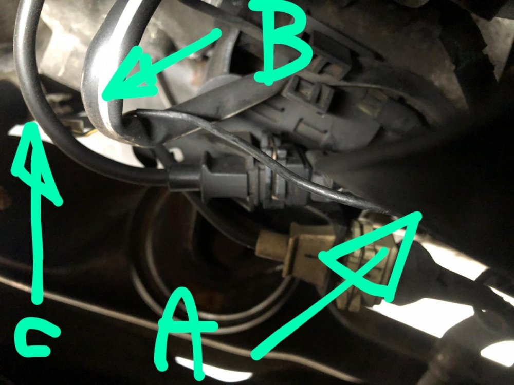

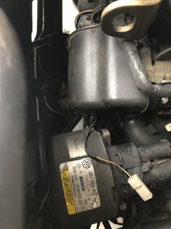

When looking to clean the connecting plug, I noticed the black yellow cable in the first picture above is just hanging, & I can’t see where it fits. Can anyone confirm where it goes please?
A) cable leading to connection for engine speed sensor
B) black yellow spade connector joined to this cable, before it gets to the connector block
C) end of loose (yellow black cable) spade connector.
the image with the fan housing shows a close up of the connector.

Ok - I’ve spoken to a mate who has just popped his head under the bonnet (a running Corrado) and confirmed this is a lone cable, not plugged into anything!

I believe the yellow black cable is only used if you are lucky enough to have the VDO gauges as this is for the oil pressure sensor that would be fitted.

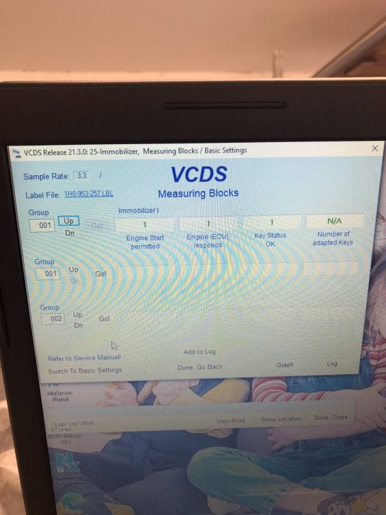

it’s got an aftermarket immobiliser fitted, made by Directed Electronics... as far as I can tell it’s operating the same as it did when it ran, and the vagcom isn’t showing any issues when you dig into the immobiliser measuring blocks.
the fun will continue 🤦‍♂️🤣
I don't believe an aftermarket immobilizer would show up on VCDS as it has been stuck on afterwards.

Your factory immobiliser is Immobiliser 1 - which is what you see in VCDS - there is a transponder in the key: Immobilizer - Ross-Tech Wiki (ross-tech.com)
Where this immobiliser is a problem, the car starts and cuts out after a second or so...
