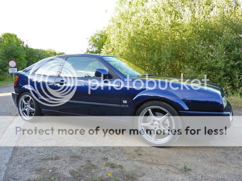

Got my car mot today hasnt turned a wheel in six months and it flew through with no advisories
LOVE MY CAR :D :D
Car Passed MOT
Fitted front splitter
Fitted side bump strips
Fitted that little bit of plastic that goes between the air box and head light plastics.
Fitted the front near side Tow Eye cover I was after, Thanks strimmer :D
