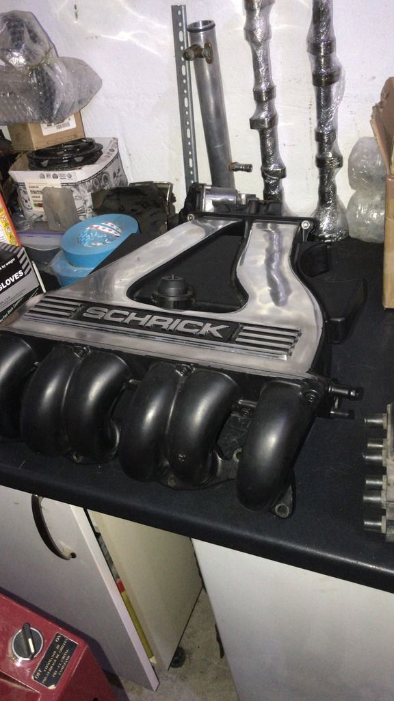

Cressa 44 Posted January 1, 2019 Took the upper inlet manifold off to get to the leaking rocker cover gasket. This car is being spoilt at the moment. I just need to decide whether to paint/polish or blast it.....and to get the injectors refurbed whilst I'm at this point. Quote Share this post Link to post Share on other sites
Tjninny 10 Posted January 1, 2019 Took the upper inlet manifold off to get to the leaking rocker cover gasket. This car is being spoilt at the moment. I just need to decide whether to paint/polish or blast it.....and to get the injectors refurbed whilst I'm at this point. Thinking of getting my injectors refurbed as well - any suggestions as to where would be ok? Tim. Quote Share this post Link to post Share on other sites

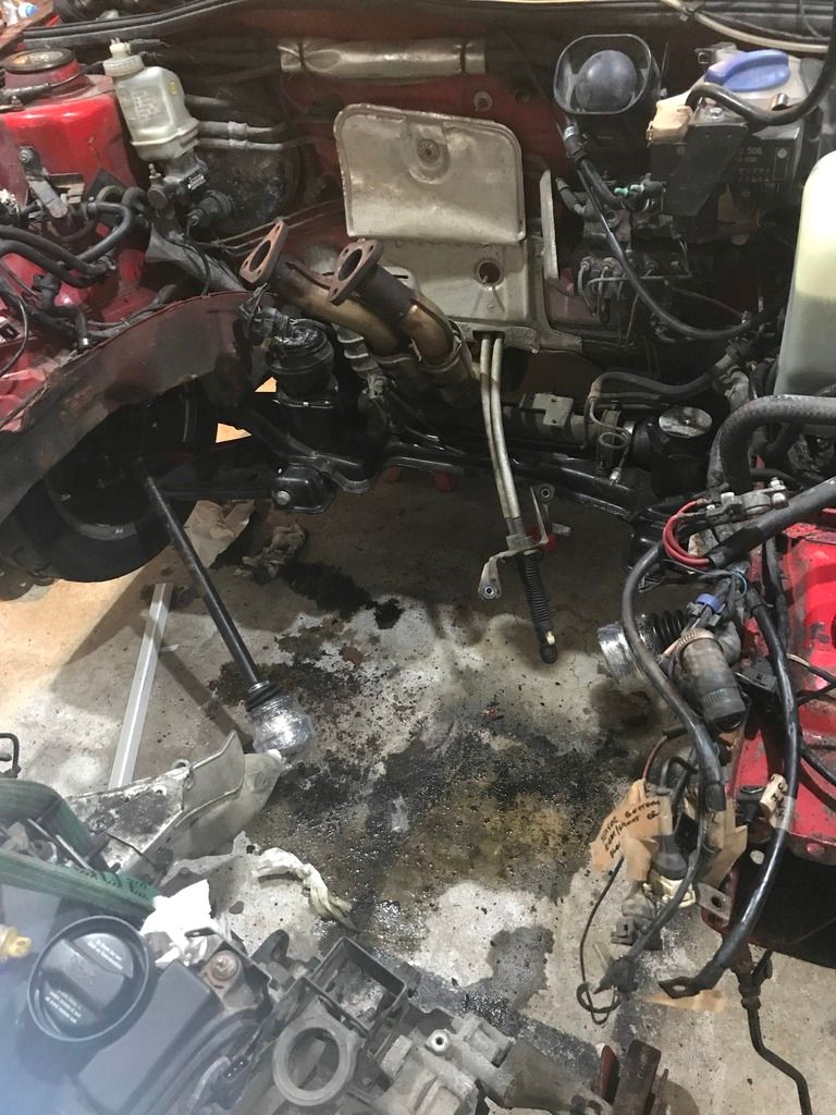

easypops 8 Posted January 1, 2019 I managed to get the engine out of my red VR6, first time I’ve went this far, I half expected it to crash onto the floor the minute it was loose but thankfully it didn’t.......I was ready to run anyway:lol: Photobucket is still a nightmare so only one picture available at the moment Quote Share this post Link to post Share on other sites
Cressa 44 Posted January 1, 2019 Thinking of getting my injectors refurbed as well - any suggestions as to where would be ok? Tim. Looking at previous threads, mr injector seems to get good reviews and also autotronix developments which is near me. I'm hopefully going to call and see them this week so I'll post up what happens Quote Share this post Link to post Share on other sites
Cressa 44 Posted January 1, 2019 I managed to get the engine out of my red VR6, first time I’ve went this far, I half expected it to crash onto the floor the minute it was loose but thankfully it didn’t.......I was ready to run anyway:lol: Photobucket is still a nightmare so only one picture available at the moment Martin, you certainly outdid my little bit of work. Well done mate. What are your plans with it? Quote Share this post Link to post Share on other sites

easypops 8 Posted January 1, 2019 Martin, you certainly outdid my little bit of work. Well done mate. What are your plans with it? Well, I bought this a wee while back so I have to get it fitted, and as it’s OBD2, I need to do that conversion as well :) Quote Share this post Link to post Share on other sites
