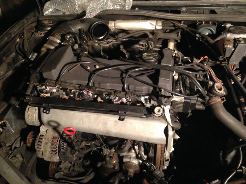

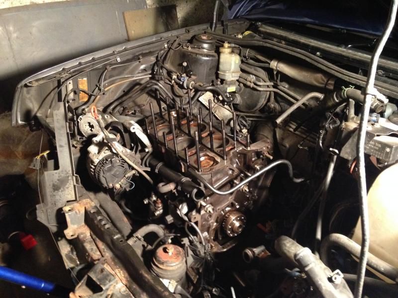

Good start on the strip down. I'd stick some rags down the inlet holes though before something gets dropped in there :)
Rags were inserted just after the pic as well as tape across the exhaust ports thanks for the heads up though
ah cool, the thought of something disappearing into one of them isn't a pleasant one.

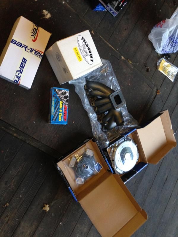

well the parts turned up from bar-tek about a day or two after my last post so shouldnt have been worrying they consisted of a peloquin lsd,turbo manifold,470cc incectors,sachs sinter clutch kit,and a oil cooler kit and some arp head studs

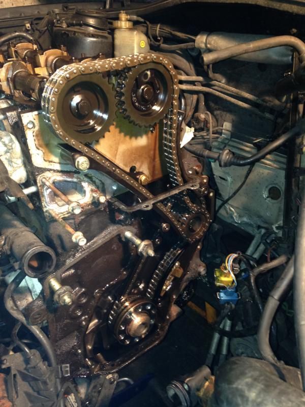

so after that arrived i had intended to get a couple of days on the car in a row over christmas so i could replace the chains and tensioners and install the arp studs and whack the spacer plate and gasket on whilst it was fresh in my head how it all came apart but this wasnt to be as the head was a bit crusty around the water ports so thought it be best to get it skimmed

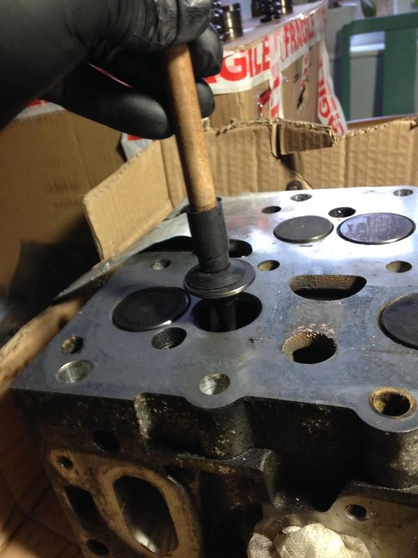

the machine shop gave me the head back and informed me that it needed new stem seals and the valves cleaning up and lapping in so thats what i have been upto this wekend cleaned the carbon off the valves with a wire wheel on a bench grinder at my freinds work he then kindly lent me the stem seal pliers and valve spring compressor to do the rest at home, new genuine stem seals are now in and valves are lapped in just need to refit all the springs etc
some progress pics

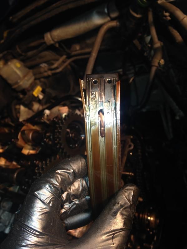

tensioner was about goosed!
state of the head you can see where it has gone crusty from the coolant
head studs in
lapping the valves in
new stem seals going in
all of this is new to me by the way that i have never even removed a head from an engine before but im thouroughly enjoying doing it all and learning along the way

How easy/difficult is it to DIY lap in the valves? I've got a spare head that I wanted to recon before swapping it in for mine, and I'm just worried I'd create a worse seal than before! I want to give it a go though so I can say I've done the whole car myself, minus the head skim and probably honing the bottom end when I get round to that.
You cant really do any damage, boring and laborious done by hand but satisfying all the same
not really difficult just spinning a valve round stuck to a suction cup on a stick as Dox said it's more time consuming than anything

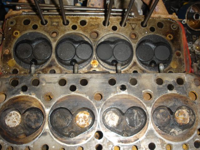

There differnt heads but only pic I can find obviously it looks more like a heart shape
Actually 4leaf clover applies to 4valve heads I think

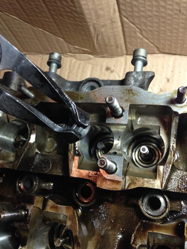

Managed to nip and do a bit after work got the springs and retainers back in bit fiddly but got there in the end

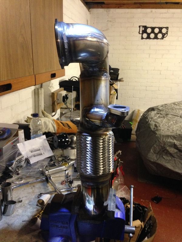

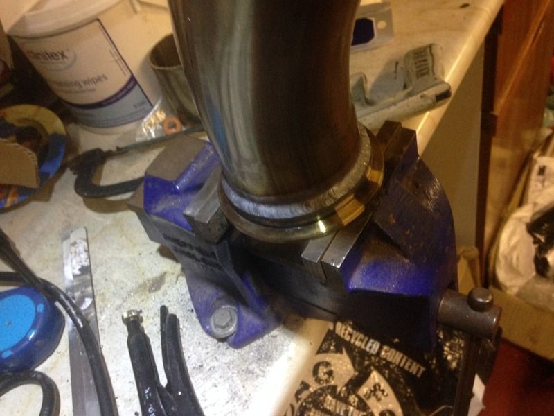

i finished my tig welding course and bought myself a welder but due to not having the box ive only been able to weld up the first 90 degree bend
i can continue with the rest once the box is back on and the engine is back on its mounts got a mate coming to help me fit the box tomorrow after work so hopefully things can start progressing again

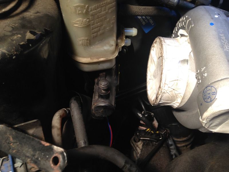

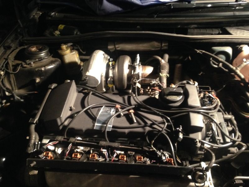

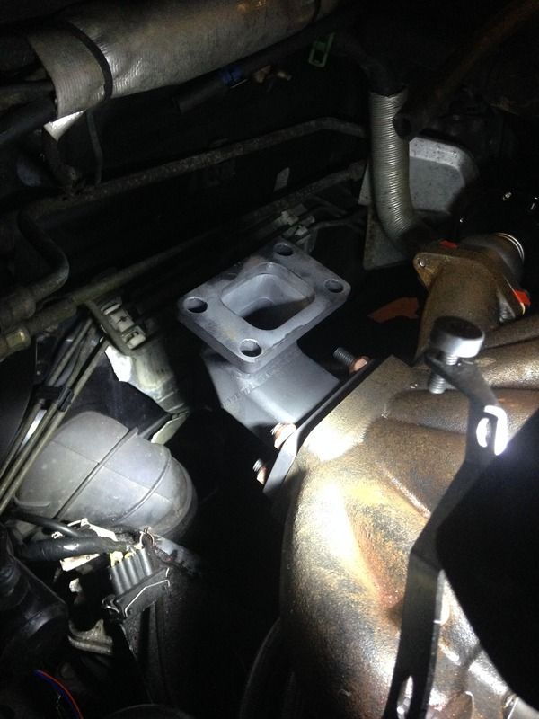

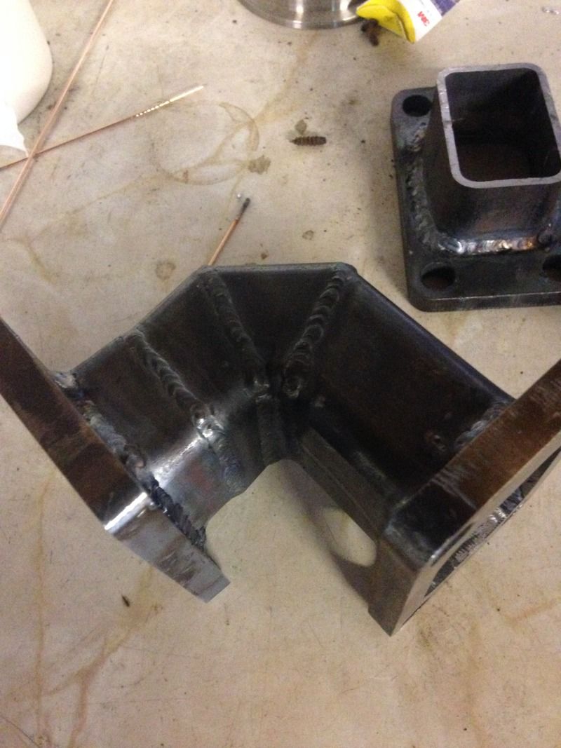

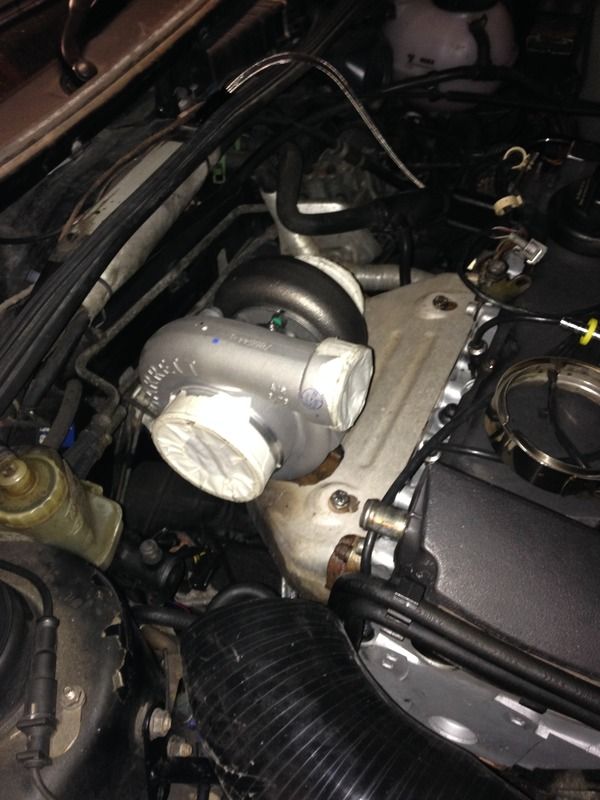

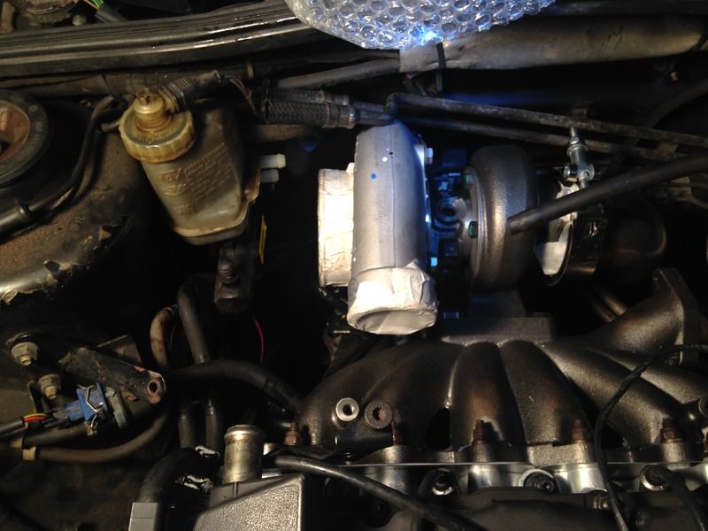

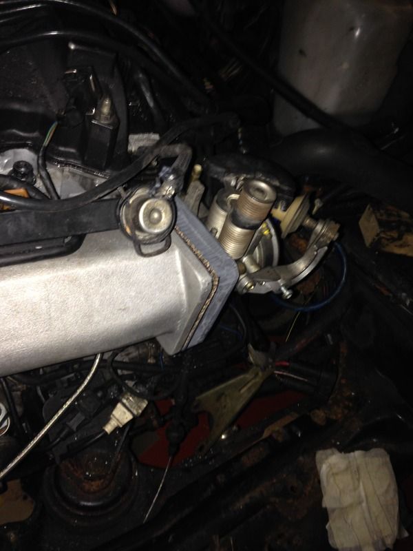

fitted the turbo but the kinetic manifold i bought being intended for lhd meant the turbo inlet was inline with the master cylinder/resevoir someone on the vr6oc suggested making something to swing it up out of the way which i did
made the downpipe and modified the heatshield

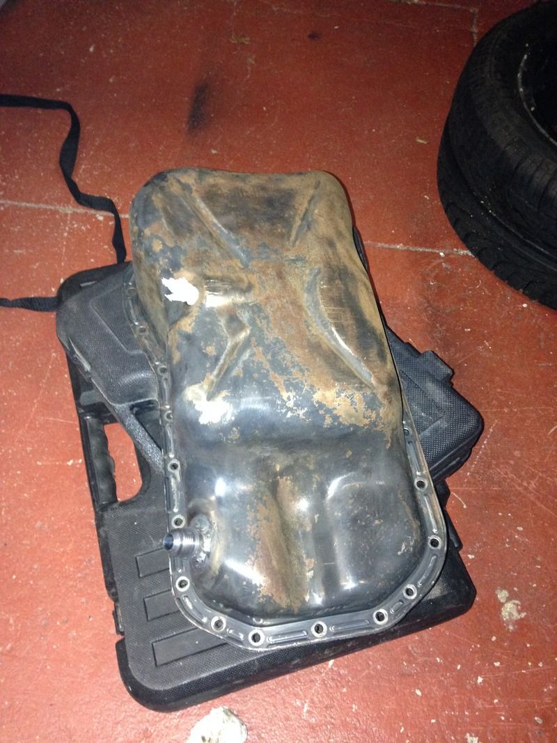

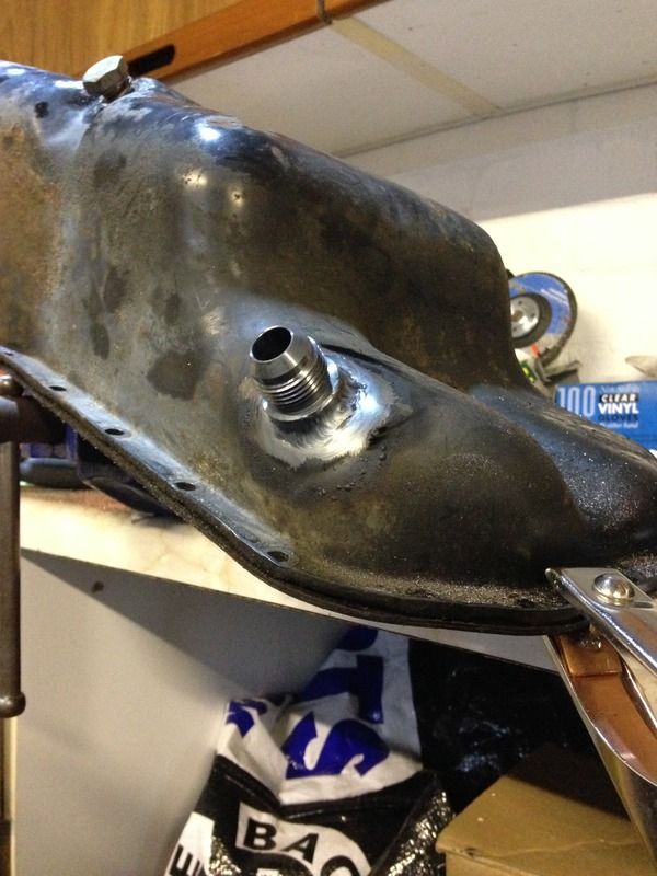

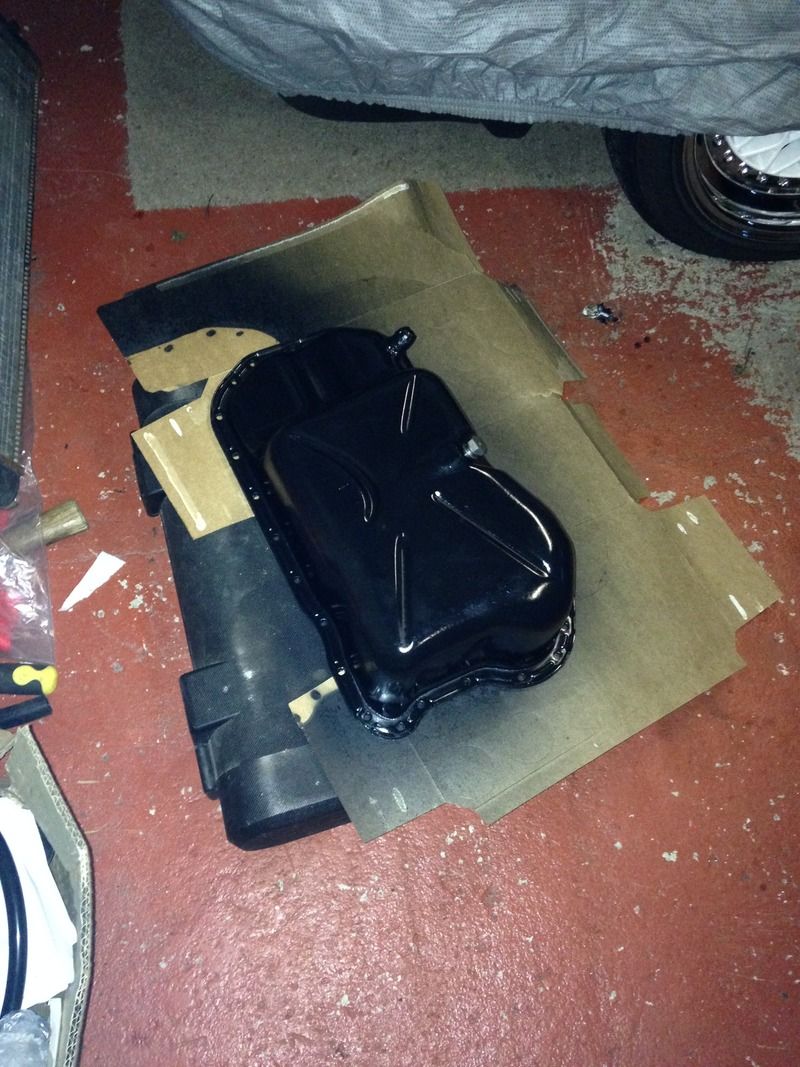

cleaned the sump up a wee bit and welded a an fitting to it for the oil drain

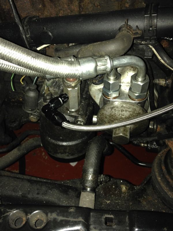

made a oil feed line for the turbo and fitted into t piece
the short runner i bought ended up being for a obd2 car so i made an adapter so my obd1 throttle body would fit
