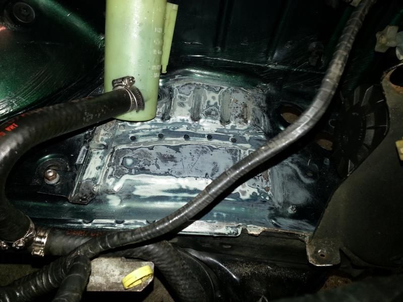

Jim Bowen 1 Posted December 10, 2014 Think this is as clean as it will get, i've gotten really bored of cleaning it now, had to do it all with a toothbrush and rags :lol: Going to repaint the battery tray area, was a little bit rusty so sanded it back. Am now thinking i might leave the rear beam on this time and do it at some point in the future. Otherwise i can't roll the car back and forth and not got enough money now to do it properly.. Quote Share this post Link to post Share on other sites

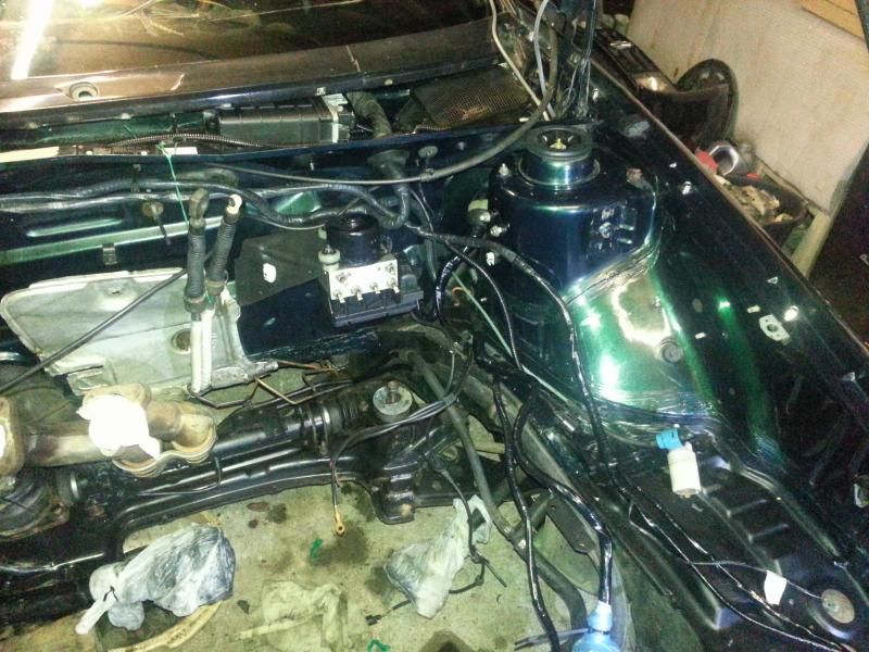

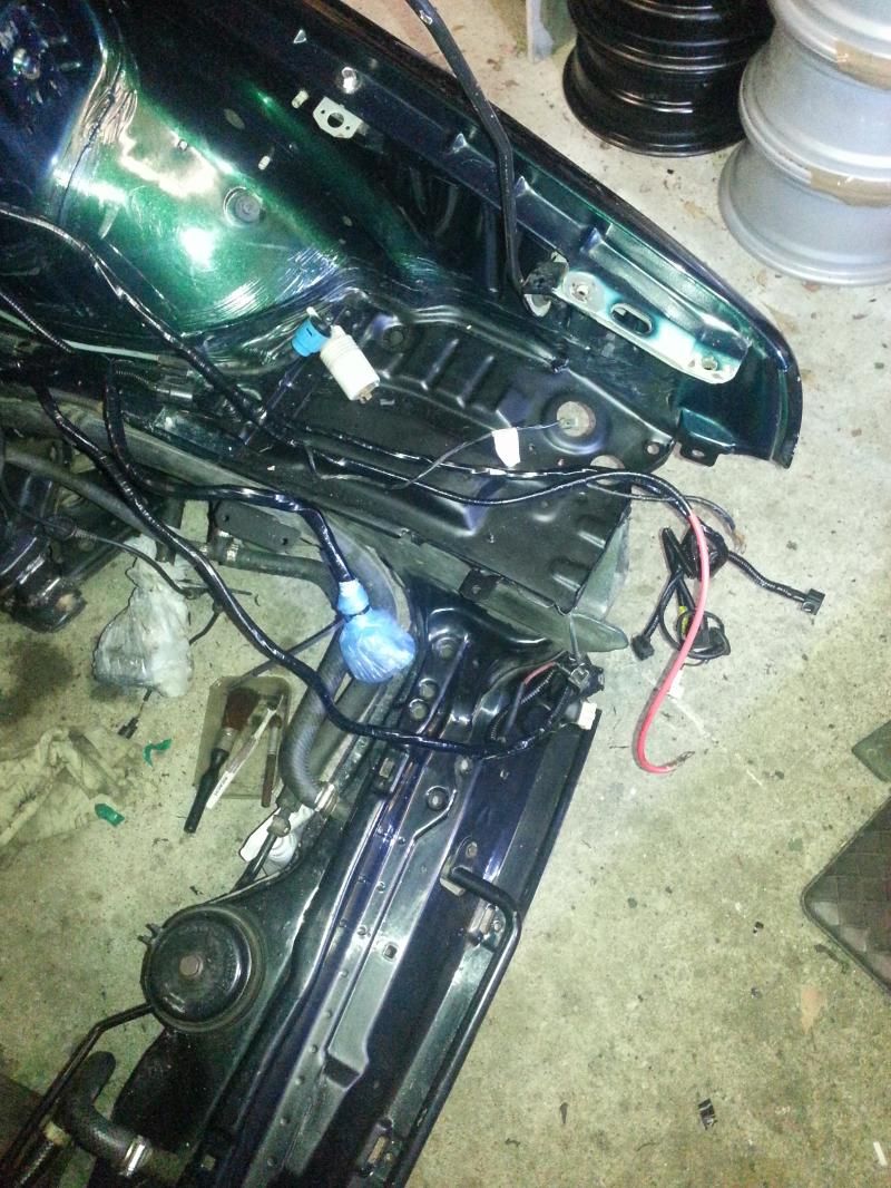

Jim Bowen 1 Posted December 14, 2014 I use eastwood rust encapsulator, its £20 a can though, but seems to work quite well as a primer too. Fitted something! (only the ABS pump for the Teves20 system, also got the loom in place, and tidied up the existing wiring, found a wire that had totally rotted through and also affected two others in the loom, was all for lights (probably explains why i had issues with the upgraded loom), sorted it now though. Front cross member cleaned up Battery tray Decided to buy the plastic ducting for some of the wiring, re wrapping any dodgy old stuff and leaving the stuff thats alright alone. Got battery tray painted up, although i'm waiting for a rubbery bed liner paint to turn up before i put all the wiring back properly. Quote Share this post Link to post Share on other sites

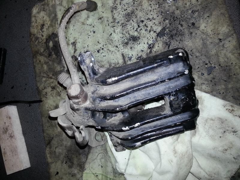

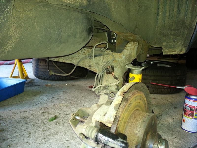

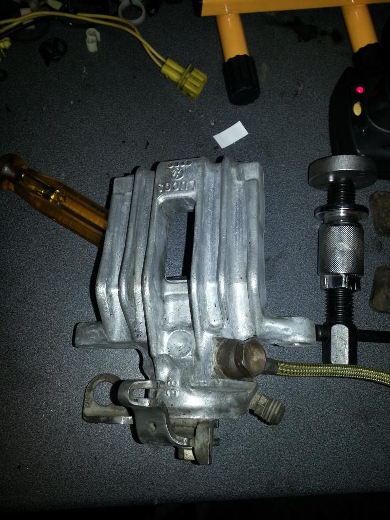

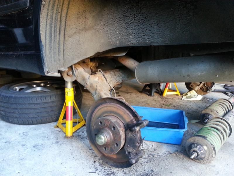

Jim Bowen 1 Posted December 18, 2014 Started on the rear end now, i needed to make the brake lines up for the new ABS, Now i've looked i may as well drop the beam off and refurb everything. Very messy Last time i painted the brakes i must of done a crap job as the paint just flaked off, cleaned the calipers up with a stanley blade :lol: Quote Share this post Link to post Share on other sites
Sean_Jaymo 0 Posted December 18, 2014 Nice one Jim, Luckily you have a nice big garage to work in, I had to make do with a gravel driveway, never again! It's a bit of job to change over the ABS system but worth it I feel. Are you changing over the master cylinder and servo as well? Quote Share this post Link to post Share on other sites
Jim Bowen 1 Posted December 18, 2014 Yeah, changing the whole lot, Got the whole setup out of P3RKS corrado. I seem to be buying loads of parts i don't need but may as well change while i'm there. Just got a new heater matrix and sent the clutch master off to be refurbed, got a new clutch slave as well, and the clutch plates etc. Just ordered new dust shields for the rear. Wasn't planning to do the rear brakes etc but they were in such a mess i thought its only polite :lol: Most the work i've done over the years has been up front, never really touched the rear, think i did the axle bushes once and thats it. Oh and about 5 different suspensions :lol: Quote Share this post Link to post Share on other sites

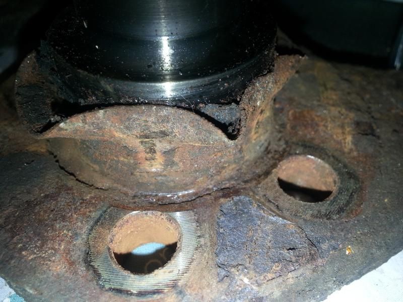

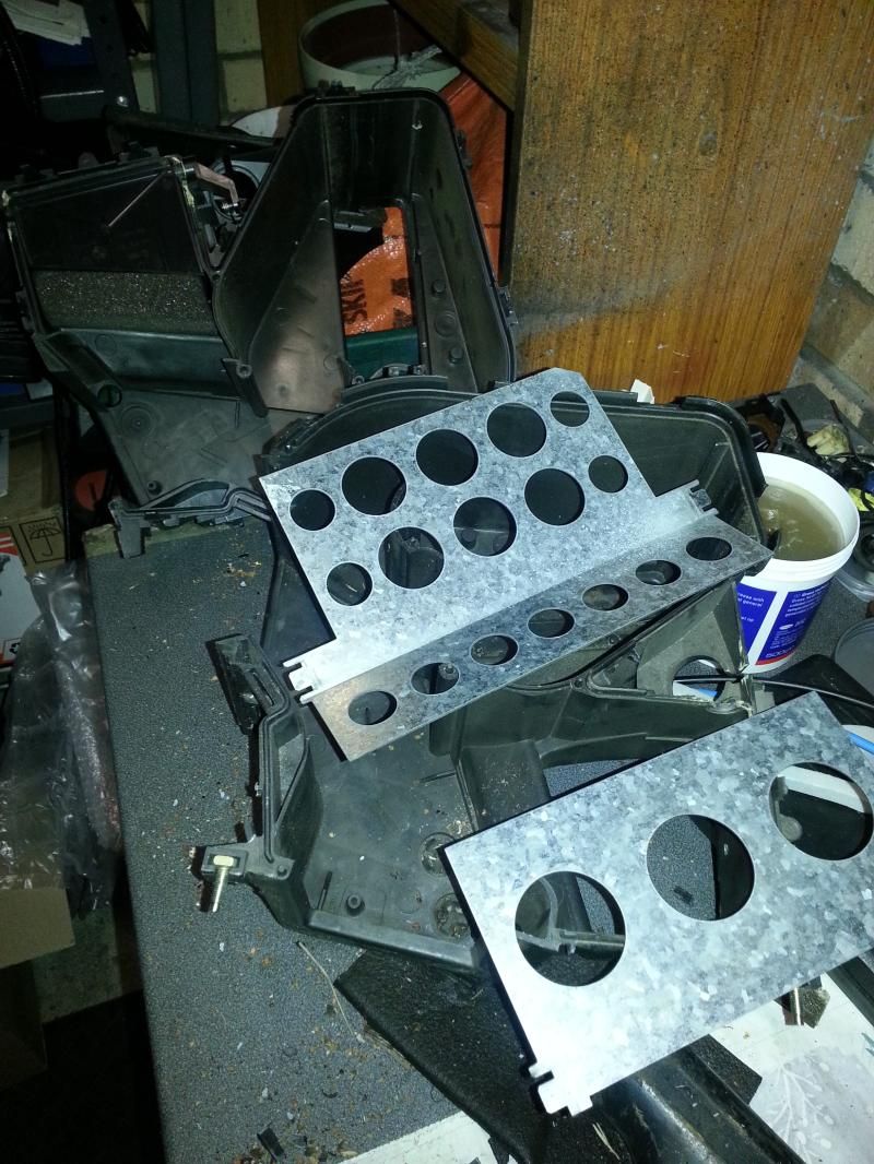

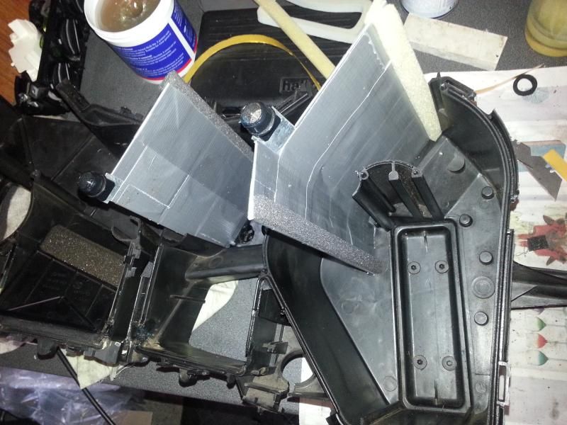

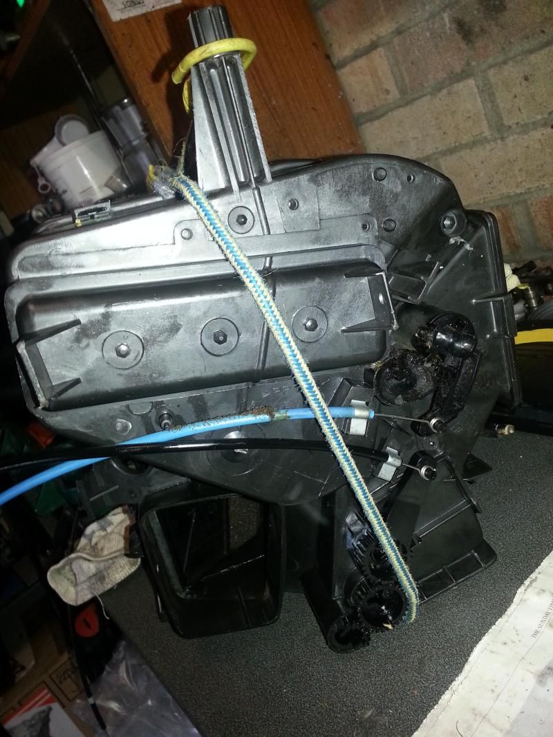

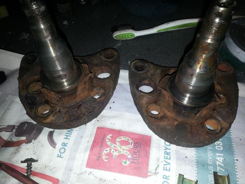

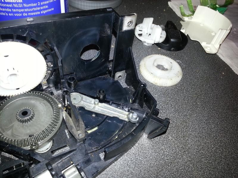

Jim Bowen 1 Posted December 21, 2014 Downpipe was from Techtonics Tuning in the US, they had a black friday deal on so ordered it a while back. I was looking into a 6 branch manifold and from research i would of gone for the supersprint, but was about £700. Spoke to techtonics and they have found with the slightly larger downpipe and standard manifolds is just as good. I only wanted to replace the standard one as its been on the car for 20yrs. Been doing random bits here and they, not really finished any jobs yet but started loads :lol: Took heater controls apart and fixed them, one of the arms was slightly bent and a spring had jumped out of place Then took heater box apart and cleared out all the old crusty foam, stripped it all off the flaps, thats what the metal bits are. Looked for foam to recover the flaps and after deciding not to spend more money i thought duct tape and some foam tape would do the job just as well. The two halves of heater box, i undid the clips with a hammer and screwdriver so had to bond it all back together All back together with a bungee cord to help while the glue dries. Then got rear beam off, wasn't so bad on my own, did it with a friend last time round COuldn't figure out how the bolts holding the stub axles could be undone, the little lip was in the way, so bent that up to get to bolts ^^^^what i do with that lip now? cut it off? i couldn't work it out but definitely gets in the way of the bolts. Quote Share this post Link to post Share on other sites
Sean_Jaymo 0 Posted December 21, 2014 I don't have that lip on mine? Quote Share this post Link to post Share on other sites
Jim Bowen 1 Posted December 21, 2014 Just looking on vagcat and it looks like a part show on the rear axle diagram, part of the bearing prehaps, but maybe it been installed wrong in the past. Quote Share this post Link to post Share on other sites
