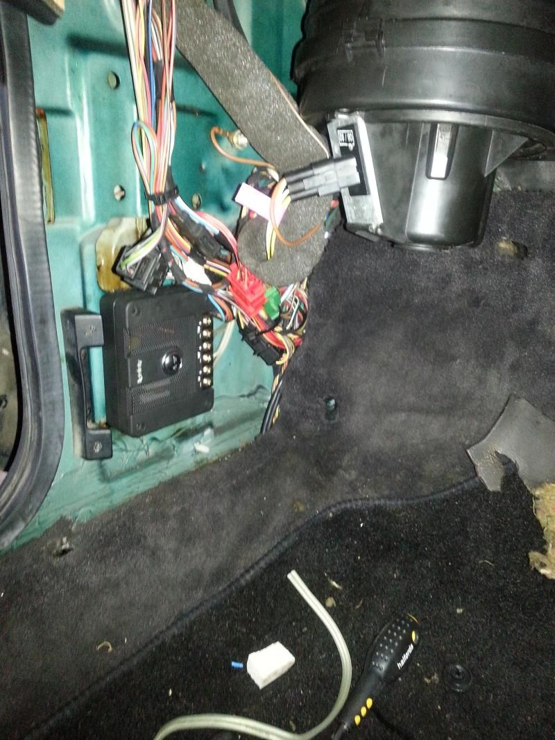

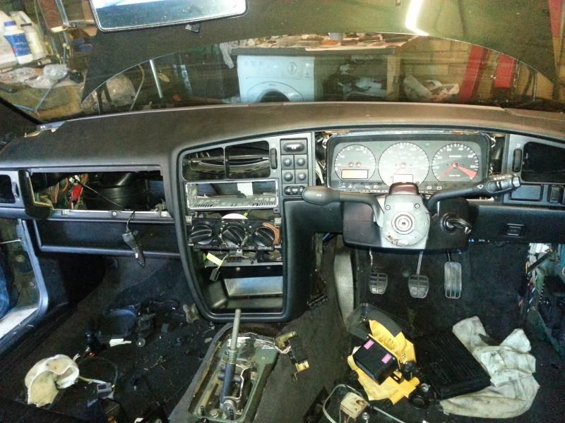

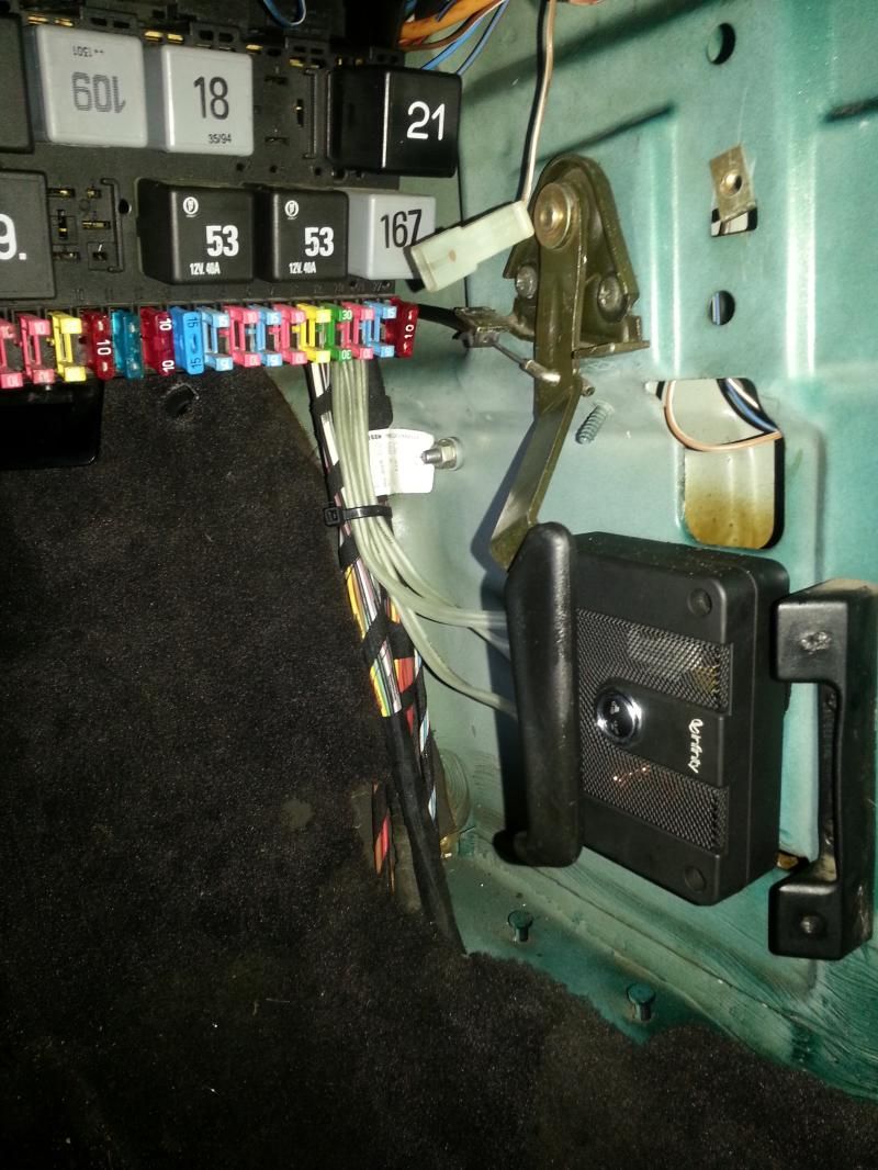

Jim Bowen 1 Posted February 9, 2015 Finally mounted the crossovers, fitted in quite nicely in the end. Then started putting dash back in. Fixed steering column fitted and a DaveA quick shift Quote Share this post Link to post Share on other sites
Hairyarse 10 Posted February 10, 2015 Crossovers are nicely tucked away :thumbleft: Quote Share this post Link to post Share on other sites
sexybourbon 0 Posted February 10, 2015 Looks good mate would they not have fitted behind the doir cards ? Saying that my hertz ones look a bit smaller than yours Quote Share this post Link to post Share on other sites

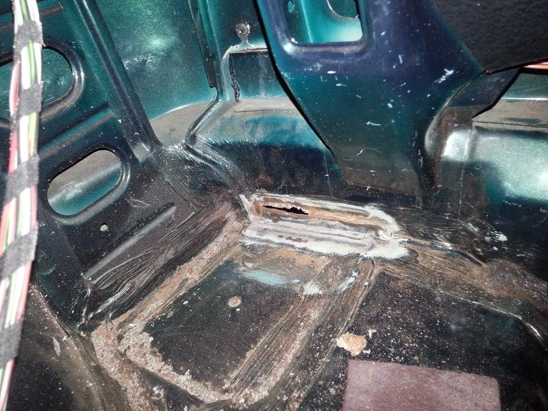

Jim Bowen 1 Posted February 10, 2015 I didn't try behind the door cards, thought about it but it made the wiring easier being behind the kick panels. Pulled the windscreen trim out last night and found the small bit of rust I treated when windscreen was out last year has come back and got a pea sized hole now. Am not sure if i should try and get another new screen and cut out and weld rust properly, or try and get at it from inside the car. Quote Share this post Link to post Share on other sites
fla 9 Posted February 10, 2015 Great work as always Jim. Put a thin shim behind the door hinge if your door is sagging when its back on its wheels. How did you mount the crossovers? I need to do mine its holding me up and you seem to have all the solutions to my ICE issues! Quote Share this post Link to post Share on other sites
Jim Bowen 1 Posted February 10, 2015 Mounting them was a pain, i first tried a double sided foam tape for numberplates, then heavy duty velcro tape, also tried a carpet tape, nothing seemed to stick, i begin to try and drill holes and use the screws supplied but figured out i wouldn't be able to put anything on the back of screw for it to tighten to. I ended up just putting a big blob of silicone on the back of the crossovers and basically glued it on. Quote Share this post Link to post Share on other sites

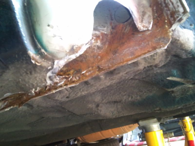

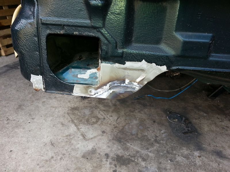

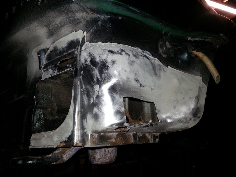

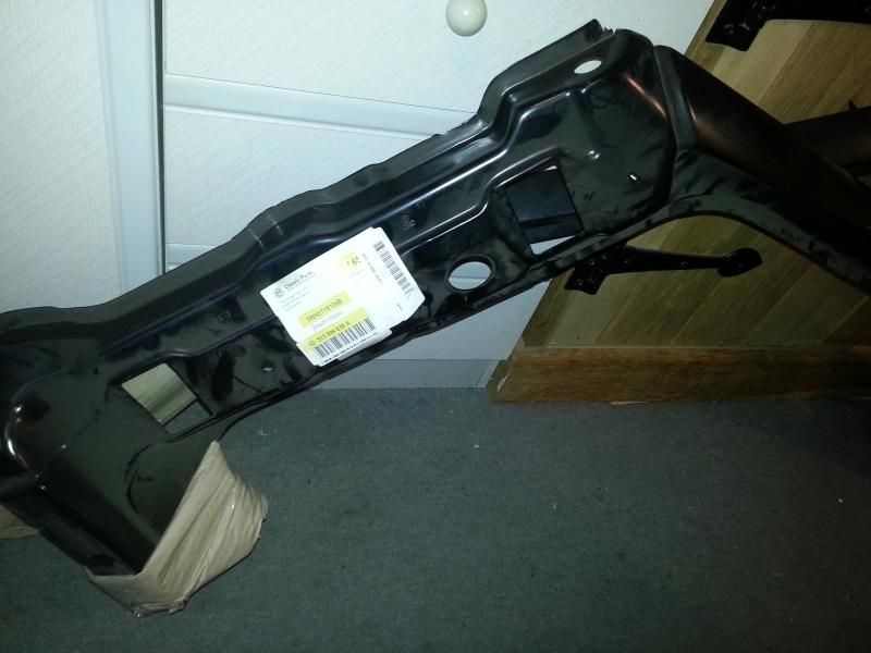

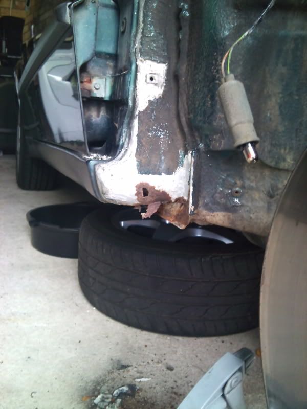

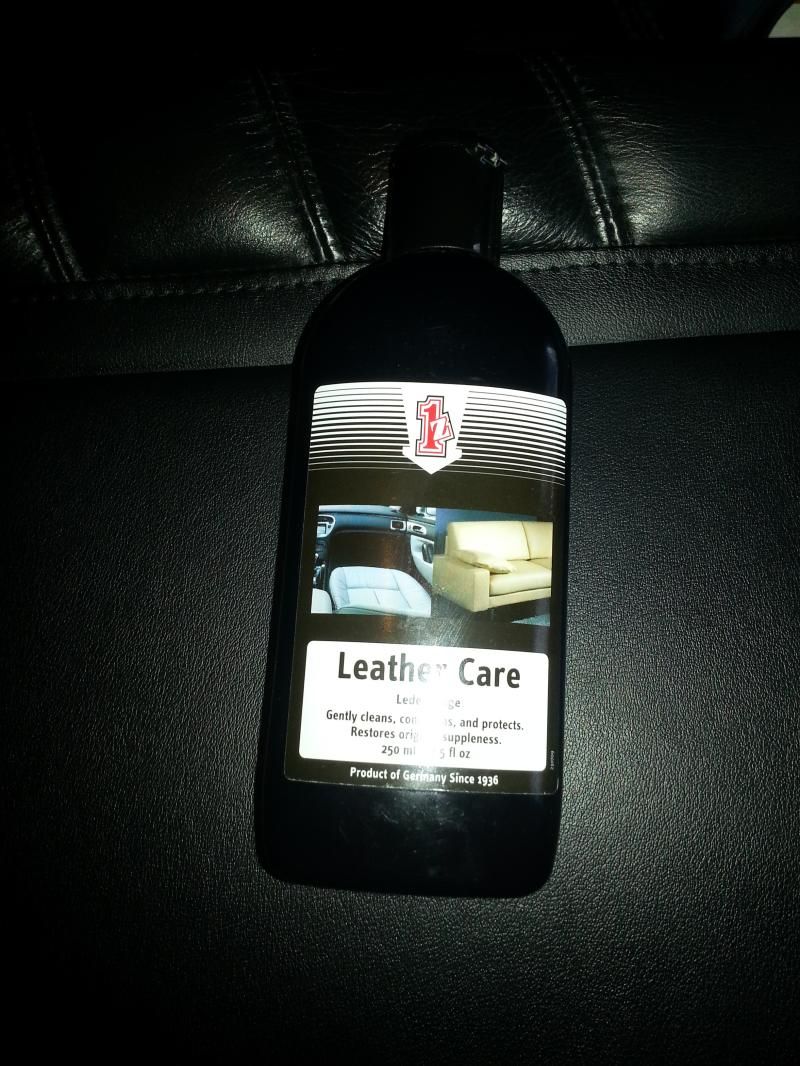

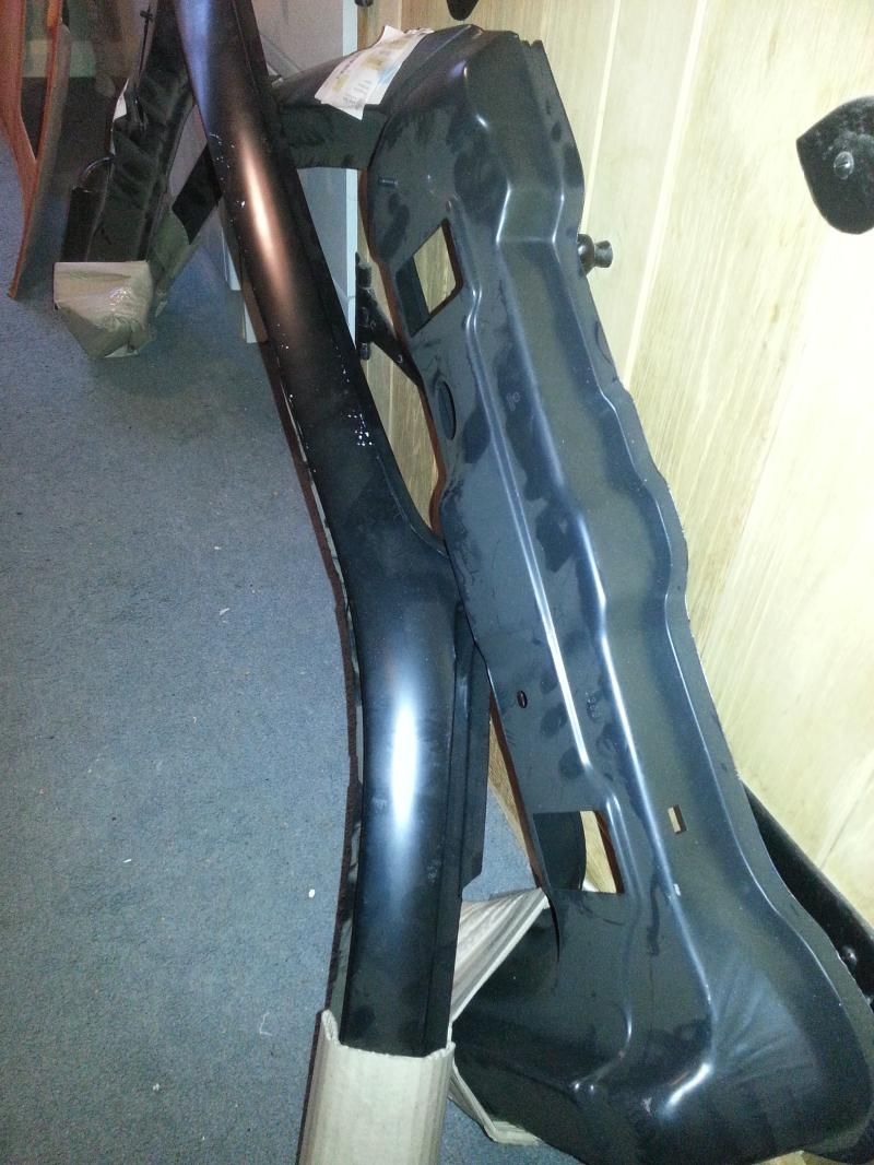

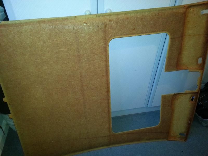

Jim Bowen 1 Posted March 8, 2015 Progress has been slow, been doing a few little jobs. Have been waiting for the weather to get a bit warmer and drier before i treat the rust etc, also trying to find a mobile welder to come and fabricate a bit for the rear bumper mount that has rotten through. Although thanks to a link shared on the forum i managed to get some repair panels for the front of sills that i need. Only actually need a tiny bit of the panel. These are old pics from a couple of years ago. Has already been repaired, but wasn't as good as i wanted so will get done again. Stripped the headlining and finally got all the old glue/foam off, (horrible job) also been sticking the leather back to door cards, had started to come away at the edges. And cleaned them, this stuff seems to be one of the better leather cleaners/conditioners i've used over the years. Quote Share this post Link to post Share on other sites

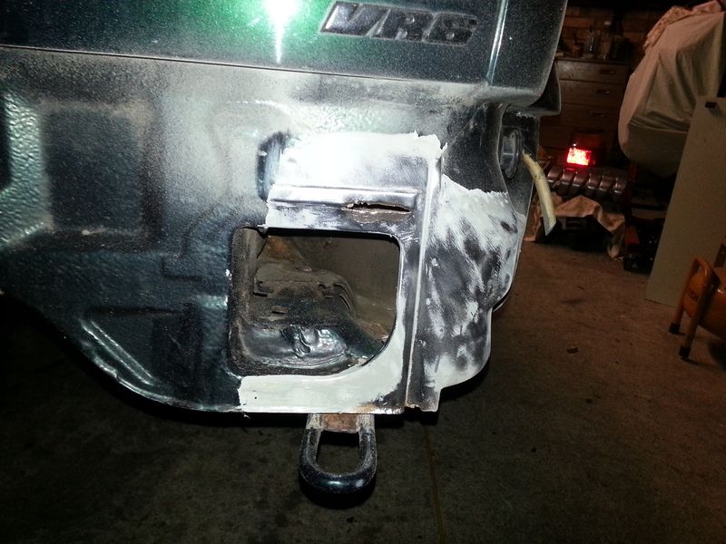

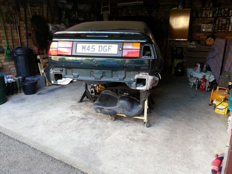

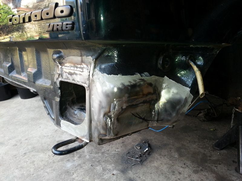

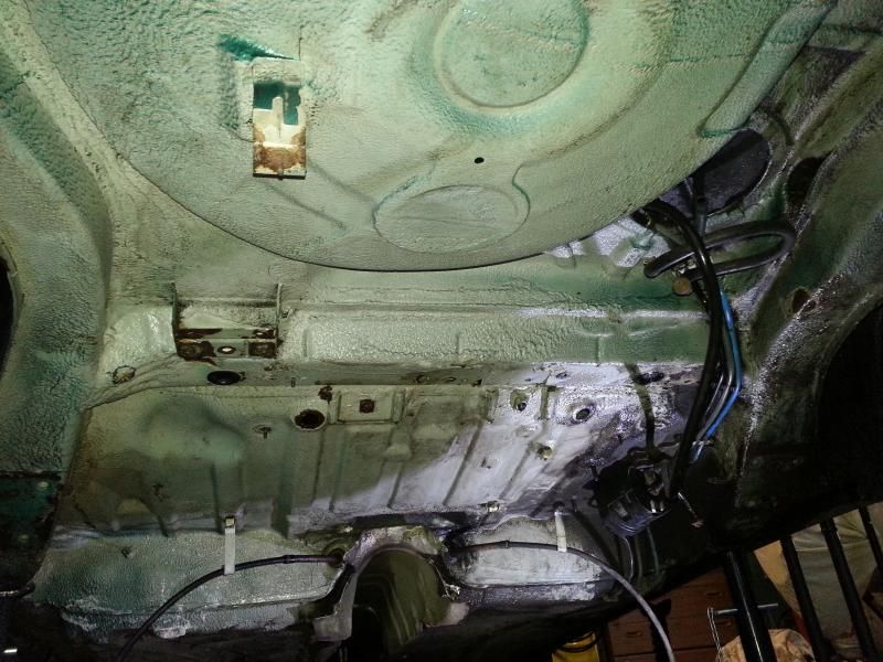

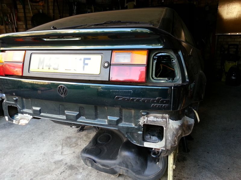

Jim Bowen 1 Posted March 26, 2015 Had a guy come round to do a bit of welding yesterday, this is great as i can now get on and start painting things and fitting everything back on. Think i'll end up painting the whole rear vallance in a black rubber type paint. The worst bit Been plated over, it won't be seen and covered in schutz type Remade the door liner, i just used a vapour barrier we use in building houses, works quite well Still got loads to do, but i hope i can get it done within the next 2 months. Quote Share this post Link to post Share on other sites
