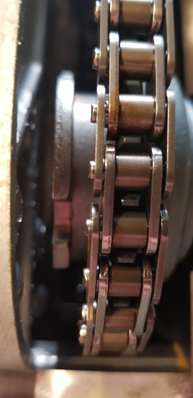

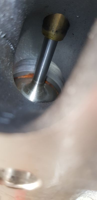

Jim Bowen 1 Posted July 19, 2018 May just do that before i fit the crank pulley, don't fancy having to take that off in the future. Cam sensor was a good shout, totally different and single chain/sprockets too, so timing covers need to come off anyway, the chain tensioner is the old style so will have to change that too. Do these pics work? Cams look like they have never turned to me Found some corrosion on the valve, sprayed some penetrating fluid in there and most of it came off, left fluid soaking in there overnight so will clean it out tomorrow. Hoping i can get away without taking head off etc, Quote Share this post Link to post Share on other sites

Jim Bowen 1 Posted September 2, 2018 Got a Borescope and looked inside the new engine, find a bit more rust on an exhaust valve, will probably be fine but i think for peace of mind I'm going to take the head off and take valves out to clean them up. Already have some arp studs and a head gasket so not really going to cost me anything and means i get to use the arps rather than have them sat in a box Quote Share this post Link to post Share on other sites

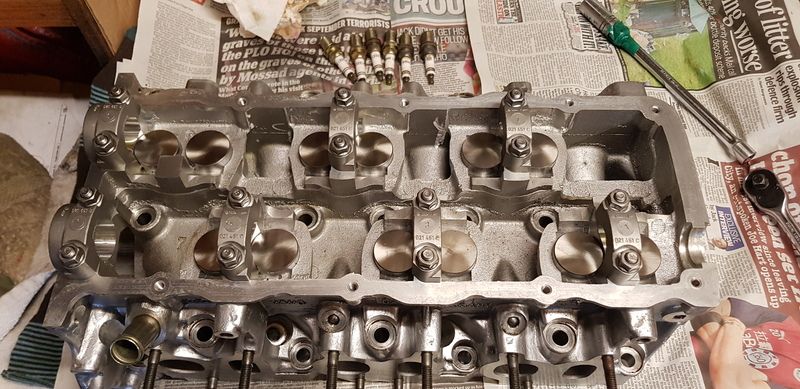

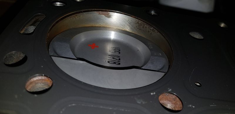

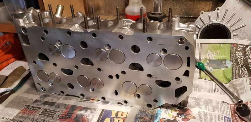

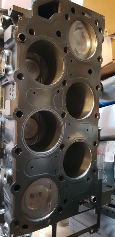

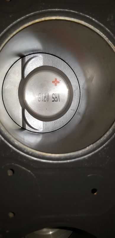

Jim Bowen 1 Posted September 3, 2018 A few pics Bit of rust on top of one cylinder, (luckily its not a part that comes into contact with piston) Am thinking if i take head apart i shouldn't need to renew anything? I've got spare valve seals from a gasket kit i bought in the past. Will i need any kind of lubes for assembling it? Quote Share this post Link to post Share on other sites
dragon green 6 Posted September 3, 2018 Just use engine oil for re-assembly Quote Share this post Link to post Share on other sites
