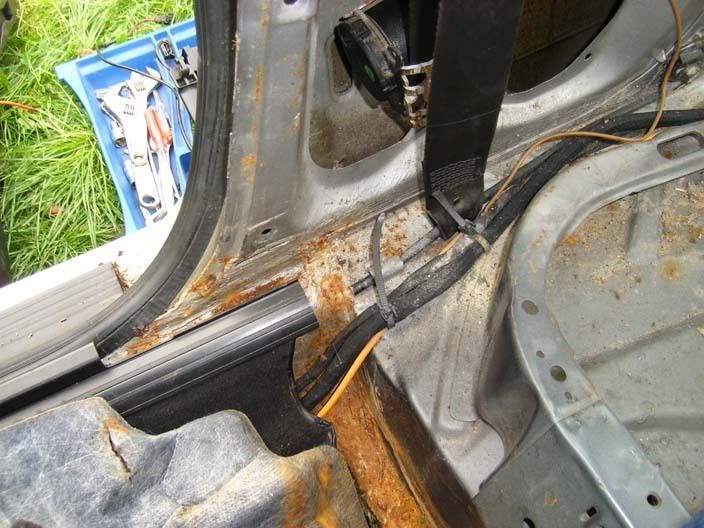

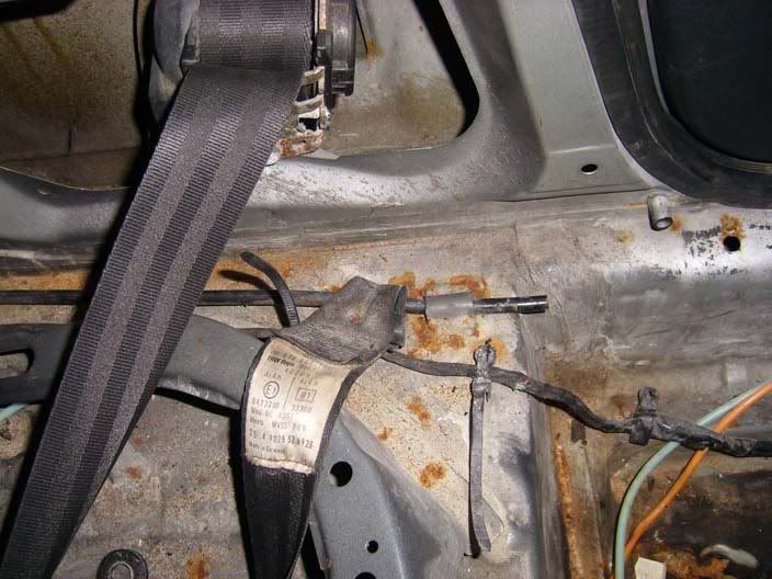

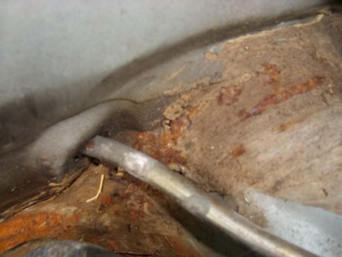

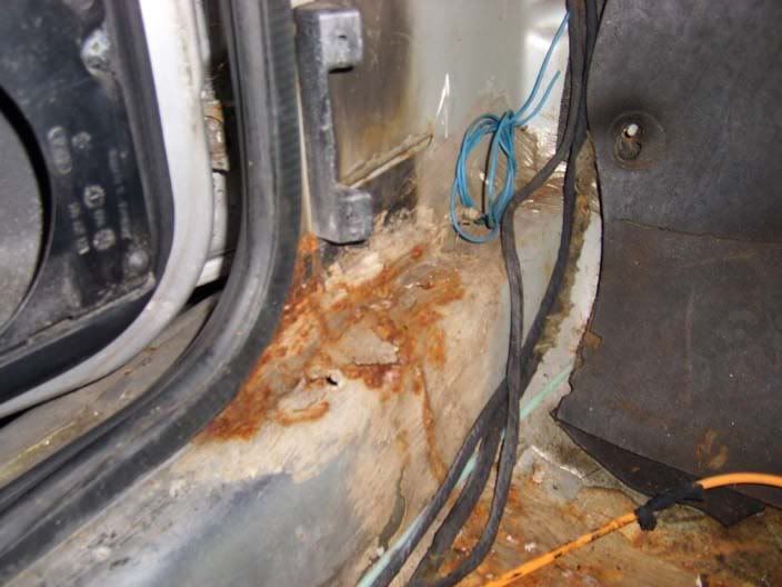

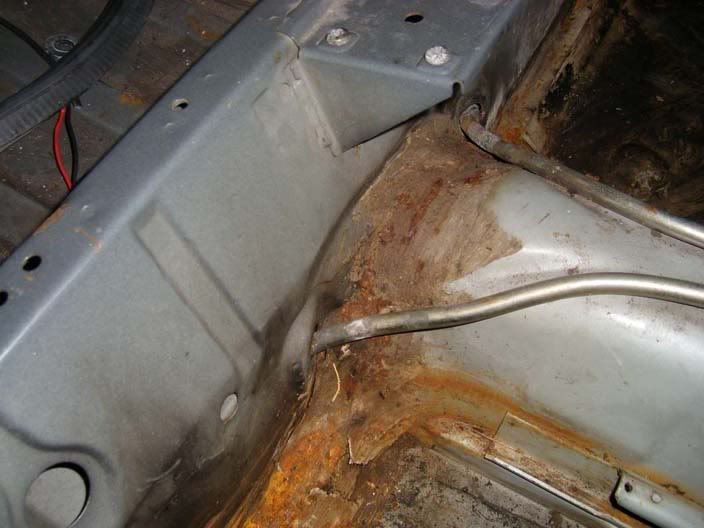

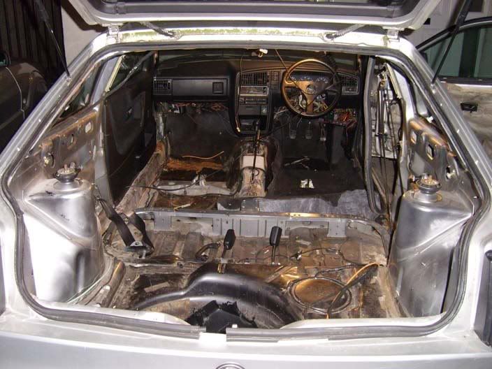

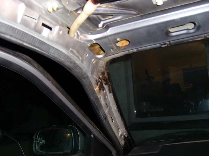

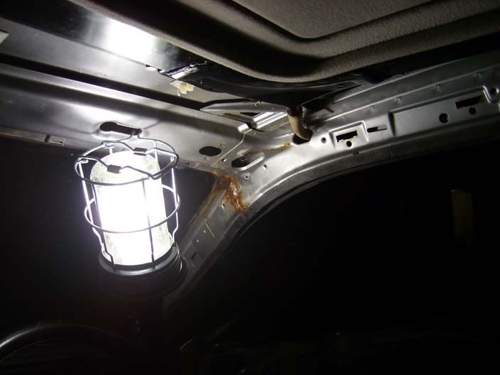

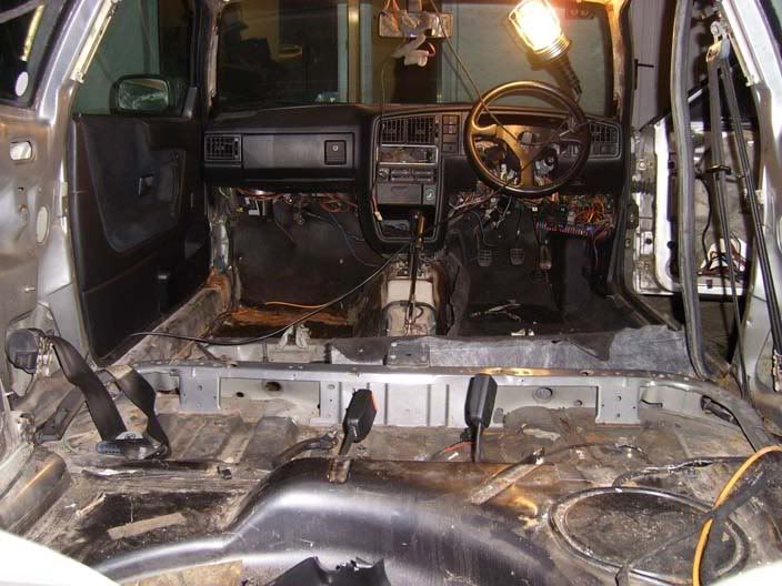

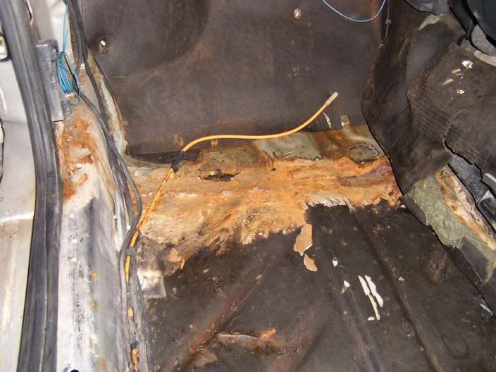

gsbellew 0 Posted October 7, 2006 Stripped my spares Corrado today, I felt bad breaking a 53k miler at first, I dont now. Its amazing and scary to think that this was sold as a car for use on the road. Its a 1990 16v with 53k on it, the pictures do the talking really, note the late spec boot floor :shock: The bloody great big weld line. Weld line at the front of the passenger footwell Welds on the "A" pillars Look at the way the seat belts were mounted :shock: :shock: :shock: I've counted a total of 4 different Corrado's all of different colours welded together to make this car, the entire rear end is from a late car, but still has the correct data sticker attached to the rear panel :?: Quote Share this post Link to post Share on other sites

TomB 0 Posted October 7, 2006 That's dreadful. It didn't look too bad from the first shot, but the late ones really reveal the true horror. I find the weld in the A-pillars particularly distressing... Did you ever drive the car? If so, could you tell? Cheers, Tom Quote Share this post Link to post Share on other sites
gsbellew 0 Posted October 7, 2006 It was a cheap ebay special bought with the intention of using it for spares or if it was better than my current one swapping over to it. I only drove it round the corner off the transporter and into my driveway, thankfully, the welds are splitting and you can see daylight through them in places, so it was only a matter of time till something gave way. Quote Share this post Link to post Share on other sites

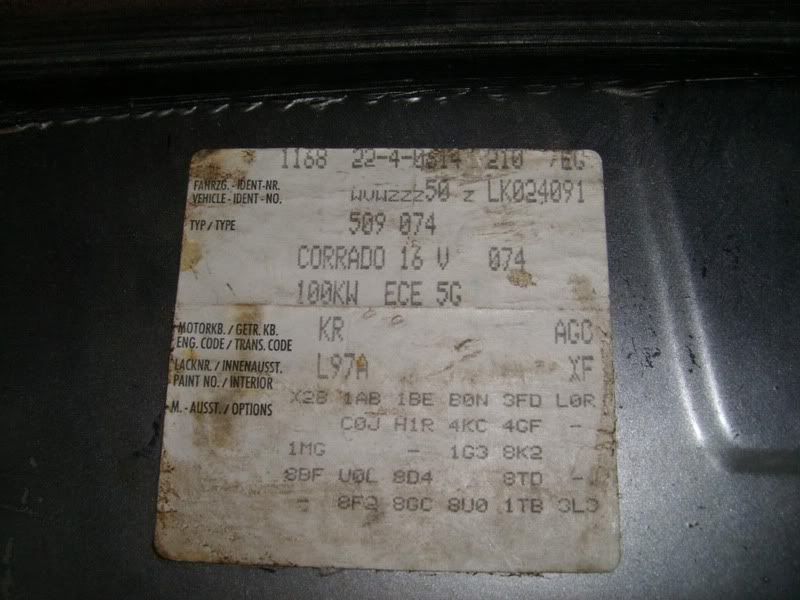

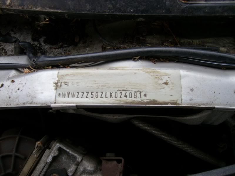

gsbellew 0 Posted October 8, 2006 Yeah there is something decidedly dodgy about it, its such a mix up of different cars that its hard to tell what it is at all. Anyone recognise it or know any of its history? Here are the VIN No's, note that the metal plate under the bonnet is missing. Strange that it has the paper sticker in the boot despite the fact that its clearly not the origianl back panel. Quote Share this post Link to post Share on other sites

G60Jet 1 Posted October 9, 2006 My never had a vin plate, it had the chassie number stamped on the bulkhead to the right of the ecu like in your pic Quote Share this post Link to post Share on other sites
