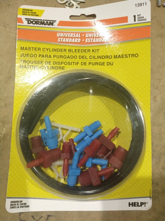

ABV-VR6 12 Posted April 15, 2021 Well done! Sucks for the paint though... I'm in the process of bleeding my new brake system and what Vince told you is right. Look up "bench bleed a master cylinder" on google, there's many way to do it and I'm pretty sure that's what you need to do, specially after what was done and didn't fixed it... Quote Share this post Link to post Share on other sites
ABV-VR6 12 Posted April 15, 2021 You need a kit like this... Quote Share this post Link to post Share on other sites
fendervg 33 Posted April 16, 2021 On 4/15/2021 at 11:51 PM, ABV-VR6 said: You need a kit like this... I just stick a Sealey vacuum pressure bleeder on and bleed the lot - never had any issues, and makes it a one person job. They are not that expensive. You can gravity bleed the clutch master as it sits lower than the reservoir. Quote Share this post Link to post Share on other sites
