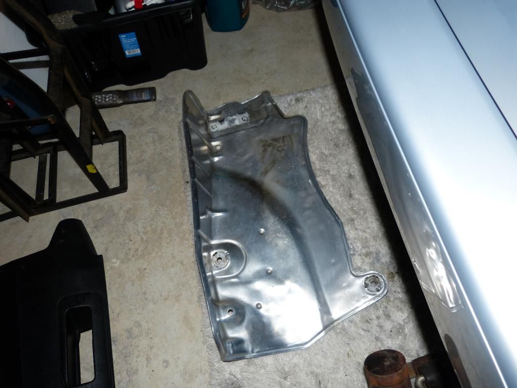

Goldie 2 Posted September 3, 2014 Well its definitely off the road.. Rear silencer off, it will be going to be professionally brush polished soon.. Rear heat shield off and look to be in good shape, hope the rest follow suit.. I split the exhaust after the cat but can i get it off with the rear beam in place, no. Any clues? There just isn't room to move it toward the back of the car without fouling on the beam to lift it clear of the cat.. The pile of bits for powder coating is starting to grow as well, bumpers coming off shortly and the irons will be joining the pile.. Quote Share this post Link to post Share on other sites
Goldie 2 Posted September 3, 2014 For the exhaust? The joint is lose, i just can't get the pipe to slide back enough for the beam.. Ill probably split it at the down pipe and then should be ok, it all needs to come off anyway... Quote Share this post Link to post Share on other sites
Sean_Jaymo 0 Posted September 3, 2014 When I fitted my standard exhaust, I disconnected the left rear flexible brake lines and dropped the beam off so that I could slide the exhaust on/off sideways from the car. Quote Share this post Link to post Share on other sites
Goldie 2 Posted September 3, 2014 Id prefer not to drop the beam as it doesn't need to come off for any work.. Ill have a look at the down pipe tomorrow and see where that will leave me. Can i disconnect the lambda wiring in the engine bay so i don't have to try and remove it from the exhaust? Once I've got that off all the heat shields will be coming off. Back box off for polishing on Friday.. Quote Share this post Link to post Share on other sites
Sean_Jaymo 0 Posted September 3, 2014 If you're replacing brake lines, dropping the beam is easy. There are plugs for the lambda below the brake servo which should make life easier. Quote Share this post Link to post Share on other sites
