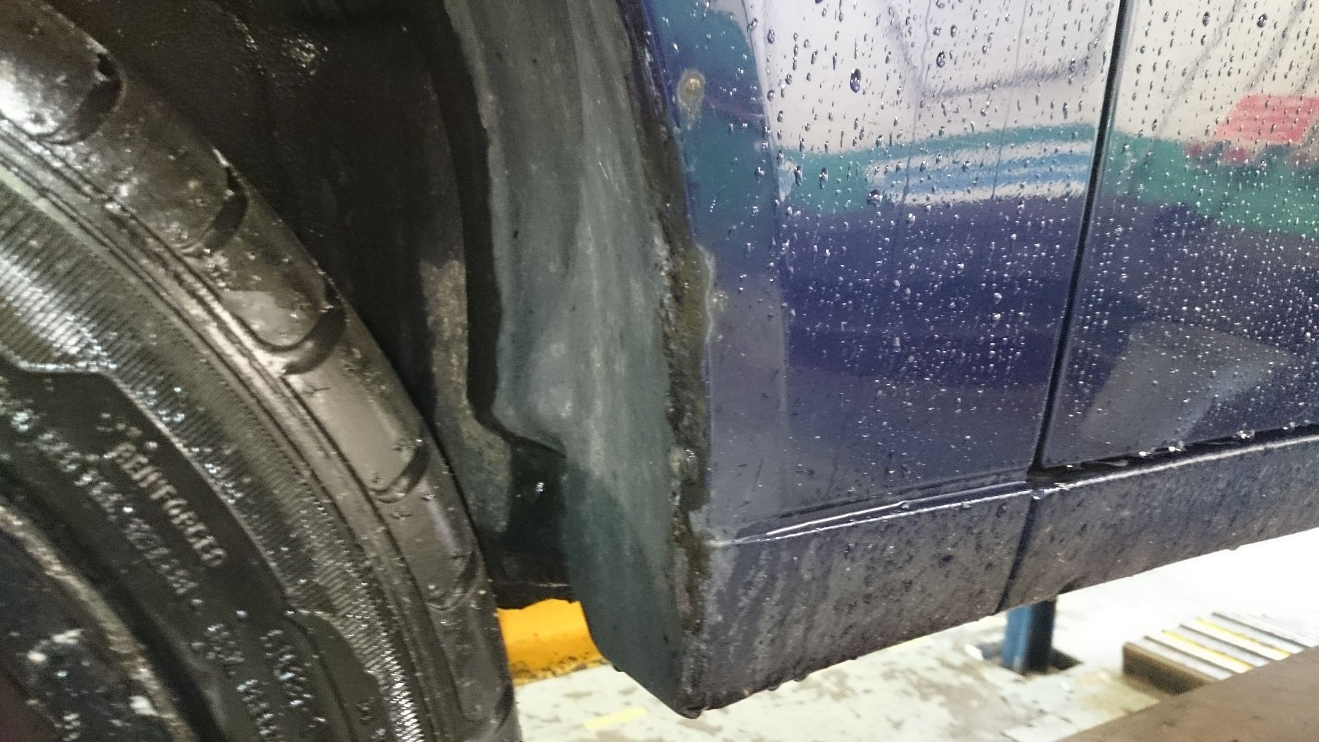

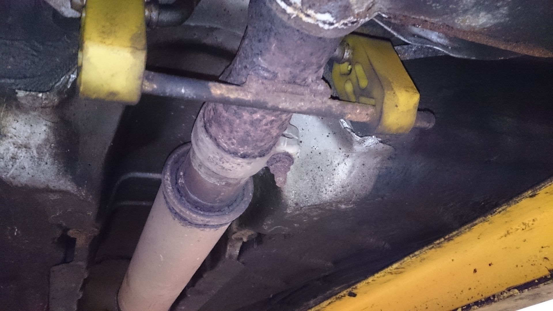

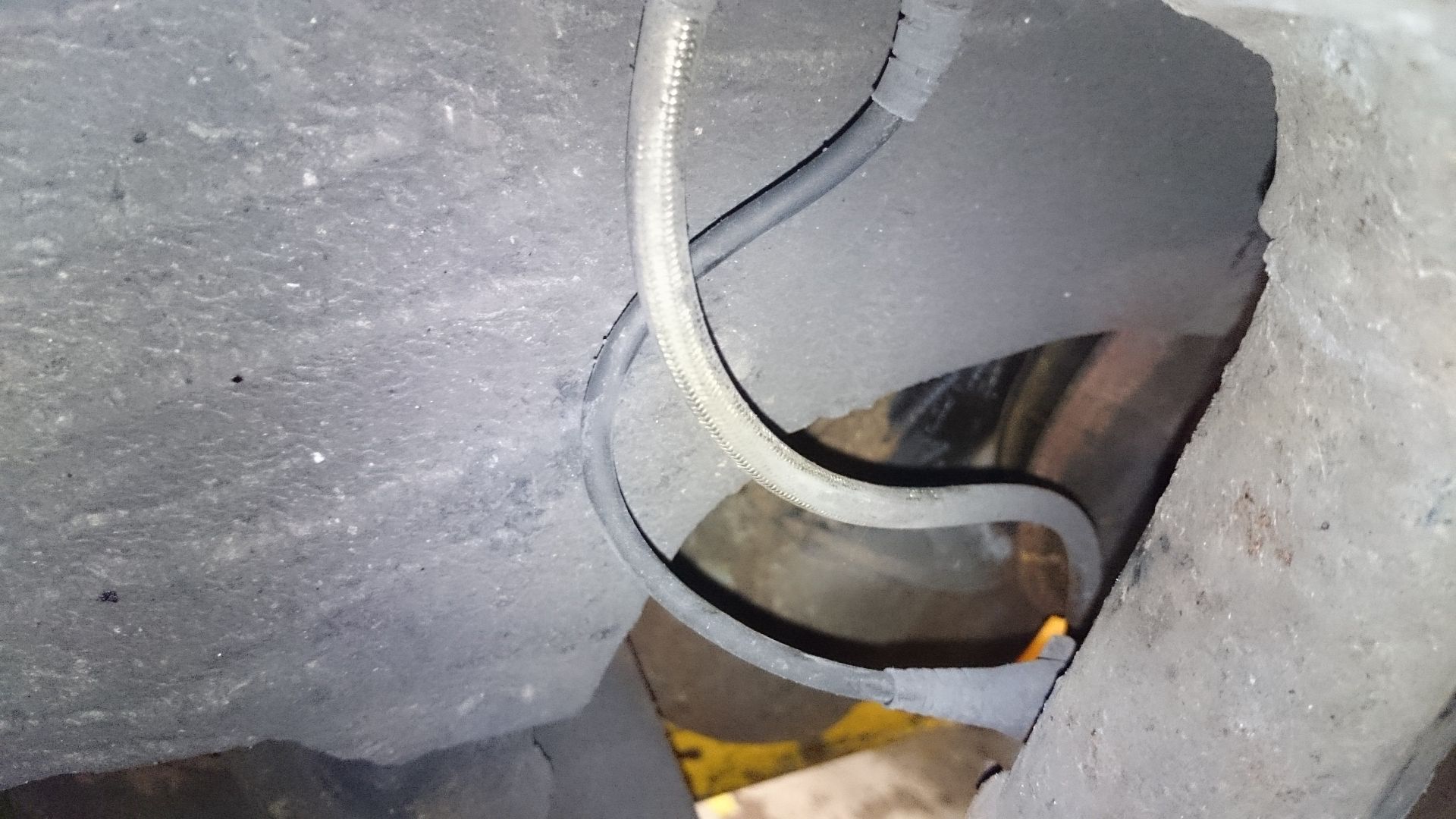

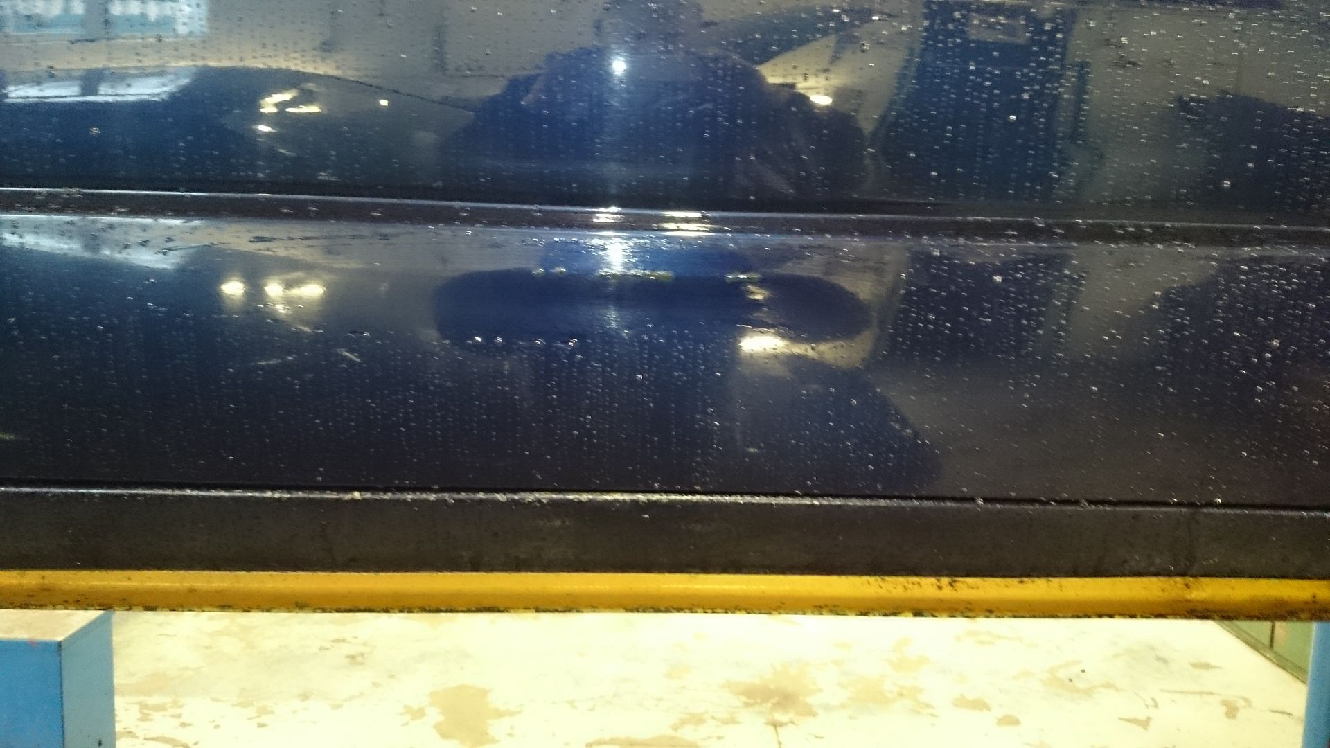

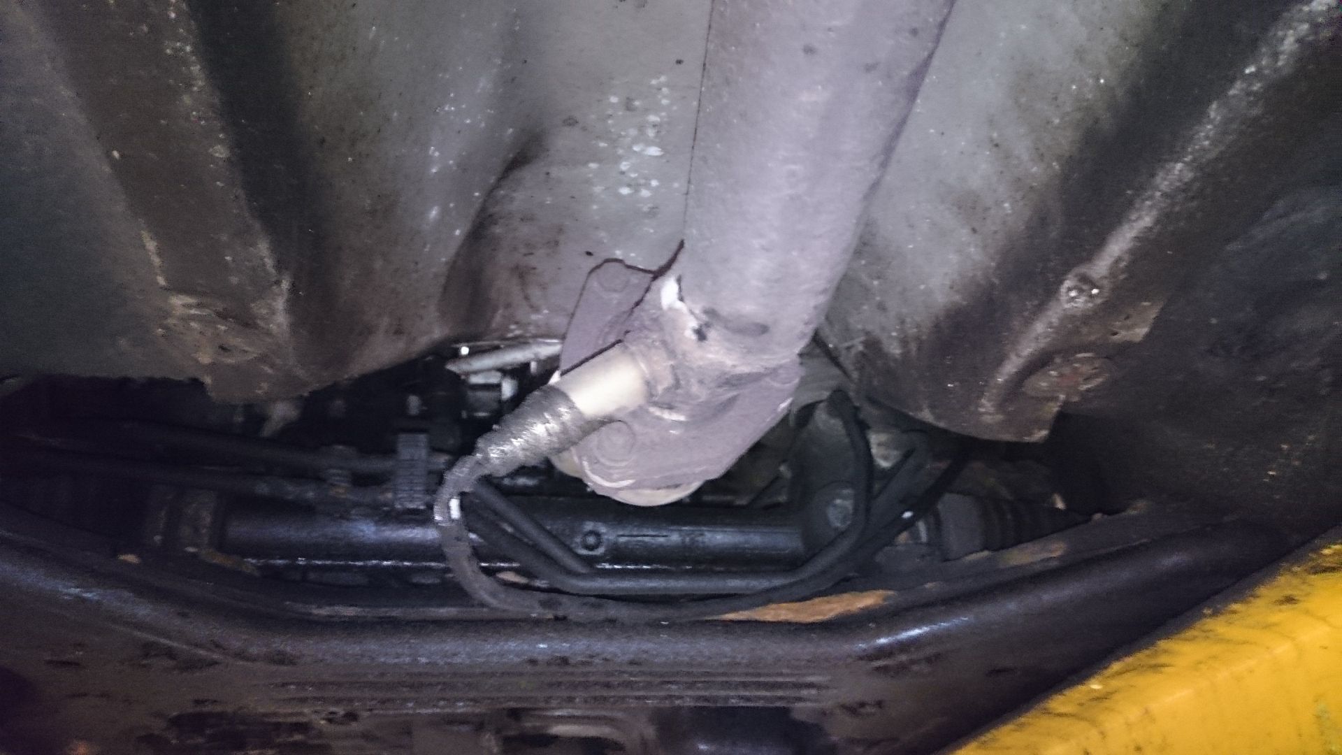

seanl82 23 Posted November 23, 2014 I'll probably get a vacuum bleeder now Sean. With access to air lines, it makes sense and they're pretty cheap to buy looking on ebay. Had another couple of hours on the Aqua today. Manually put it in gear and drove it onto the ramps. Running a little rough, but previous owner mentioned the coil pack needs changing. Got a couple of spares so thats ok. Gotta say, I'm pretty impressed now! Its grubby as hell underneath, and needs a complete new exhaust system by the look of it, but the sills are rock solid! The underseal has been scraped a fair bit where a widowmaker has obviously been used to jack it up but it looks relatively recent and theres no sign of any major rust what so ever. It has a decat which explains why it failed emissions test (I put it down to the major exhaust leak). I mentioned it has the 288mm front brake upgrade, and after a good look and little wipe down, it has braided hoses all round too! I think I'll have them for mine. Another bonus is that the fronts on mine are near new, and the O/S rear was replaced last year so I'll have a full set of braided lines for the price of a single rubber one I expect! ABS and rear spoiler are working correctly too after noticing fuse 16 had blown which is excellent as I thought I'd be chasing another ABS problem. Spoiler retracting is slow, so it needs a bit of maintenance but thats no biggie. Heater dials work on all settings and direction, so the only common problem with it is the sunroof doesn't slide! So, for MOT it requires: - Full exhaust (will get a cheap second hand stainless system) - Ball joints (supplied by PO) - ARB drop links (advisory but cheap as chips) - Sidelight Bulb (Have half a dozen spares anyway) - Legal number plates (Another cheap easy fix) Other bits required: Tidy up in engine bay Detail paintwork Tidy up alarm wiring Replace gear shift cables (before MOT obviously) Maybe replace wings with if a decent set come up in the right colour Thats it! :dance: Some pics. Quote Share this post Link to post Share on other sites
