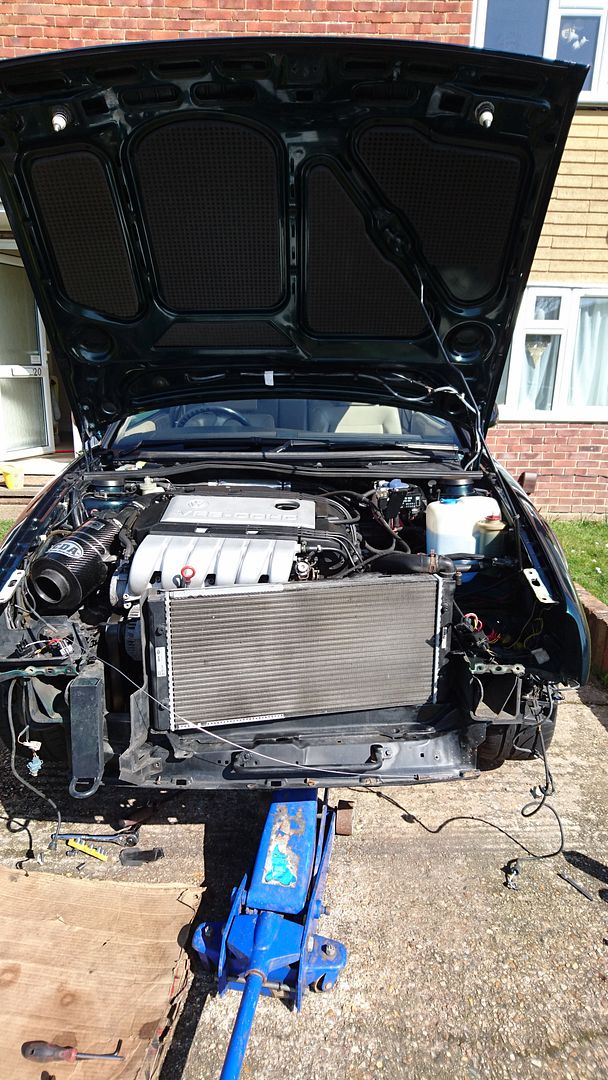

seanl82 23 Posted March 25, 2016 (edited) Had a small water leak for the last few weeks, and couldn't see where it was coming from with everything in place. I suspected it was coming from the rad fan switch, but all I could see were small drips coming from the bottom rad hose. Had to tear the front end down to be able to see it properly though. True enough, it was coming from the switch and it was actually pretty loose. A good half turn was all I could manage but its sealed nicely now. I found another leak as well coming from the drain plug on the crack pipe. I managed to get about half a turn on that too, but its still weeping very slightly so I'll see if I can get another plug and seal for that, as I don't fancy replacing the whole thing if I can help it! My water level light keeps flashing when the car gets up to temp too, even though the level is good. I originally thought it was the new expansion tank that was faulty, but I shorted the sender plug and its still the same. I saw a thread on Vortex that suggests its most likely a dry solder joint on the binnicle, and I've got a spare one so I'll try that tomorrow so if it cures it I'll re-solder it all. The eagle eyed amongst you will have noticed the bonnet foam too. I finally go around to fitting it the other day. Closer pic. Bonnet catch is removed as its very sticky, but I have another with a set of pins which I'm gonna ask Ian (GloucesterOx) if he can re-plate them next week. I swapped out the boot popper too as the original was scuffed, and it didn't work with the key. New one in and lock re-tumbled and all is good. Noticed that the central locking isn't working when opening from the passenger side though, so I'll have to have a look at that next week. I bought a grey parcel shelf from ebay for £16 delivered which I thought was a bit of a bargain which arrived today. I wasn't sure whether to dye it or re-cover it originally, but there are some fag burns in it which has obviously meant I'll have to opt for re-covering. Gonna go on the hunt for a bit of carpet/fabric for that next week too, although I do have some acoustic fabric in very light grey in the shed so I may attempt to fit that first and see how it turns out. From this. To the uncut version. Still having to use the car for work which I'm really not happy about, as I've noticed a very slight crease on my drivers quarter where someone has obviously opened their door onto it. :mad2: You can only see it with the sun reflecting off of it from a certain angle, but I know its there and its p i s s e d me off no end! Got a couple of stone chips on the front end too but I suppose thats inevitable. Hey ho, hopefully it won't be for much longer. Edited March 25, 2016 by seanl82 Quote Share this post Link to post Share on other sites
Harrier 1 Posted March 25, 2016 Nice work Sean, I have a spare crack pipe plug I think, if you want it let me know and I will dig it out. It's at the workshop though so won't be until btw Tuesday :) Quote Share this post Link to post Share on other sites
