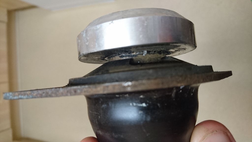

seanl82 23 Posted March 26, 2016 (edited) Had a quick hour on the car earlier. I'd wanted to swap my VT Gearbox mount back to standard for a while. Thought it was transmitting a bit of noise through to the cabin, but after looking at it, I'm not sure. The rubber has come away from the central metal shaft. Makes sense really, as when it was on the RR at Stealth last year I thought the engine was moving more than expected, and it was also an advisory on the MOT last year in being loose but secure. Wasn't an advisory this year though........ Oh well, just means I can't flog it on. Oh, and ordered a replacement crack pipe plug with seal, and rear brake bias valve spring from VW. Collecting them Wednesday. Edited March 26, 2016 by seanl82 Quote Share this post Link to post Share on other sites

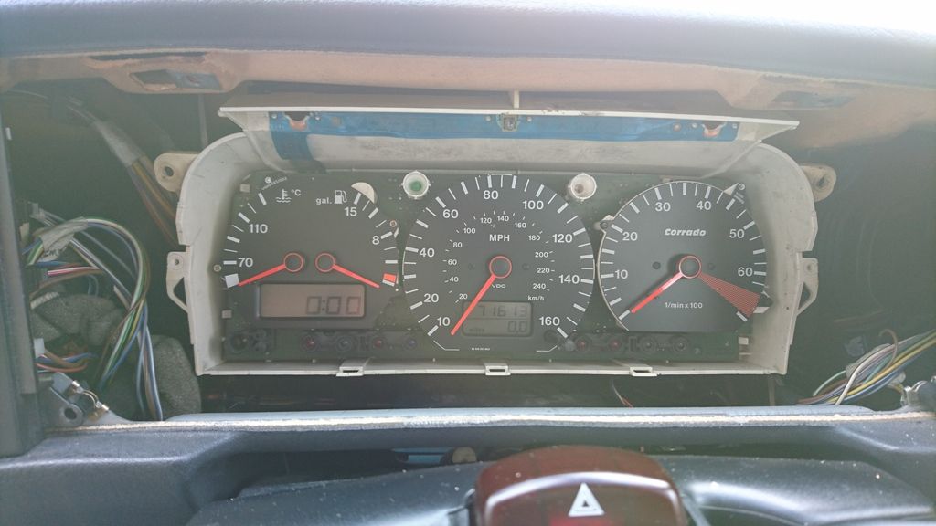

seanl82 23 Posted March 27, 2016 Thanks Sean! Had a few more hours on the car today and I've concluded it's definitely the expansion tank causing the low level light to flash. I ran the car up to temp with a spare set of clocks, which produced exactly the same problem. Wish my mileage was this low really! Anyway, as with the original clocks, if you turn off the ignition then restart the car, the warning won't come back. I had to let the engine cool a fair bit for each process, as it only happens when the water is at 90, and oil is mid 80s. If the light is flashing, it won't reset itself even when the plug is bridged. If I run it up from cool with it bridged though, it doesn't come on. When the bridge is removed it takes about 20 seconds or so before the light starts flashing again. I'll have a bit more time on it next week so I'll check the continuity and resistance of the sender pins inside to see if they differ from the original, and see if it's possible to get some sort of proper fix. I've ordered some beige van lining carpet to re-cover the parcel shelf too. Hopefully the colour is OK, or I'll have to try and re-colour it too. Getting there slowly! Quote Share this post Link to post Share on other sites

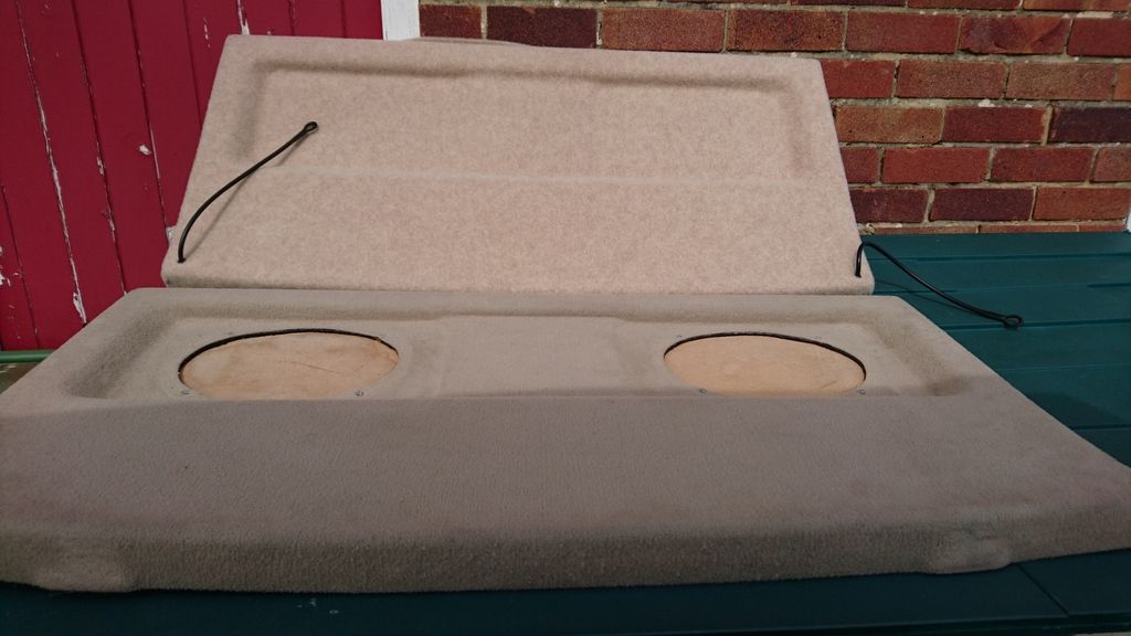

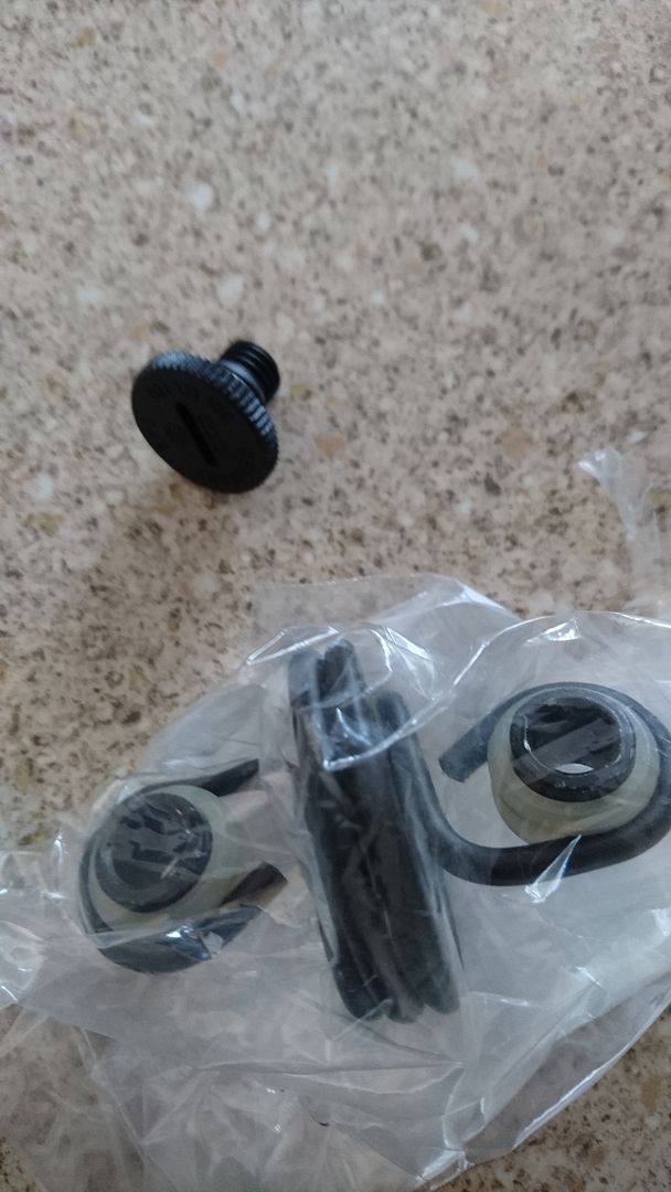

seanl82 23 Posted March 30, 2016 (edited) Picked up the couple of small bits from VW today. New crack pipe plug with seal, and rear bias Vv spring and bushes. As mentioned previously, I'm accumulating parts in preparation for the underside next winter (been saying I'll do it for about 2 years now!), and the bias valve spring are one of those obscure parts that are likely to become obsolete before long, so thought it prudent to get it whilst I still can and its pretty cheap as well. I also received the van lining fabric and glue today for my parcel shelf. Et voila! Colour is obviously pretty off, but it was only £15.99 delivered including the glue so I thought I'd give it a try and I'm glad I did. If you have been searching for what to use to re-cover the parcel shelf, read on. Being beige, they're very hard to come by second hand and they have been discontinued from VW. The only real option I had was to buy a second hand shelf in grey (as they're the cheapest), and re-cover it. The van lining fabric is absolutely perfect for anyone thinking of doing this. Its 4 way stretch stuff so flexible enough to mould into the corners without bunching up and causing lumps. The pile is a little more fluffy, but thats likely to do with the fact the original is 21 years old now. If you can find a supplier relatively local, I'd suggest either going into a supplier with your shelf, or cutting off a bit from the rear bit closest the seats where it overlaps, and seeing if you can get as close a match as possible. Another option is to send the cut-off to various places by post to see if they have something close enough you'd be happy with. This is what I'll be doing next as the experiment was successful. You'll need 1.1 x 0.7 metres of fabric, but most come off a roll that is usually 2M wide and you buy by the metre, so one is more than enough. Anyway, thats one thing temporarily out of the way, tomorrow will see me fit the new coolant drain plug, and one which seems to be very common at the moment in that my windows and mirrors have decided to stop working. They are linked, as the passenger side window sw isn't working either, all the connectors behind the door card are in place (I had the door card off the other day and it definitely worked before), and changing the window control unit for a spare I have didn't make any difference. I suspect it may be to do with the loom either at the door jam, or the connector at the fuse box if both the windows and mirrors are on the same loom, but I'll check the Bentley wiring diagrams later. Will report back with what I find! :salute: Edited March 30, 2016 by seanl82 Quote Share this post Link to post Share on other sites
Jon_vr6 1 Posted March 30, 2016 Thanks Sean! Had a few more hours on the car today and I've concluded it's definitely the expansion tank causing the low level light to flash. I ran the car up to temp with a spare set of clocks, which produced exactly the same problem. Wish my mileage was this low really! Anyway, as with the original clocks, if you turn off the ignition then restart the car, the warning won't come back. I had to let the engine cool a fair bit for each process, as it only happens when the water is at 90, and oil is mid 80s. If the light is flashing, it won't reset itself even when the plug is bridged. If I run it up from cool with it bridged though, it doesn't come on. When the bridge is removed it takes about 20 seconds or so before the light starts flashing again. I'll have a bit more time on it next week so I'll check the continuity and resistance of the sender pins inside to see if they differ from the original, and see if it's possible to get some sort of proper fix. I've ordered some beige van lining carpet to re-cover the parcel shelf too. Hopefully the colour is OK, or I'll have to try and re-colour it too. Getting there slowly! Mine did exactly the same, everytime i started from cold it would flash. If i turned the engine off straight away and restarted it would be fine. Plenty of patten copies available so theres options at least. Quote Share this post Link to post Share on other sites
robrado974 1 Posted March 30, 2016 Nice work on the parcel shelf Sean and good to see you got to the bottom of the coolant light troubles . I think I have failed on my underside refurb , I didn't buy that Spring , bum , that's the one part I didn't buy . Quote Share this post Link to post Share on other sites
seanl82 23 Posted March 30, 2016 Thanks Rob, Its only about £12 including the bushes from VW. Get one bought! :thumbleft: Quote Share this post Link to post Share on other sites
Design380 10 Posted March 30, 2016 (edited) Cheers Sean, Just ordered one, thought these were only available over the pond! Much appreciated - Paul Edited March 30, 2016 by Design380 Quote Share this post Link to post Share on other sites
