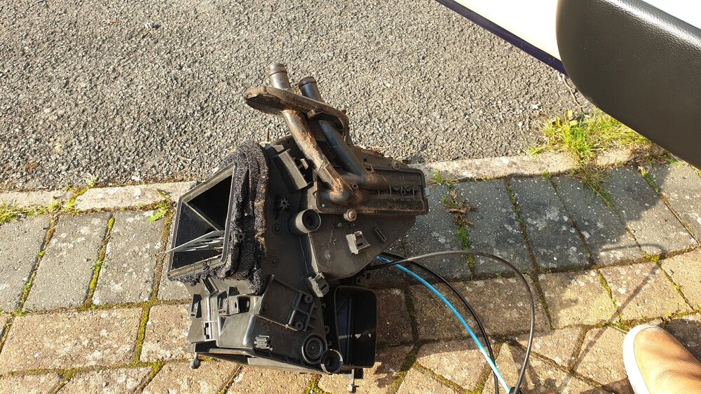

fendervg 33 Posted December 31, 2022 Sticky backed felt from an arts/hobby supply shop was what I used as well, some others have used adhesive foil tape - but you need it to be slightly porous. It really does need to come out for you to take it apart though - buy you can leave the cables attached as you remove it and take the control dials and the heater box out as a unit, if you are worried about the cables. It will make it easier to see how it works and goes back together. Quote Share this post Link to post Share on other sites

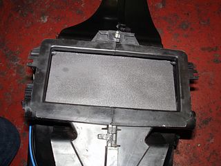

dragon green 6 Posted January 14, 2023 This is a NOS heater box I’ve had in my loft for many years, I tried to take pics to show the foam, and two doors have foam stops !I have dynaliner here, and it is very much the same as OE,I’ve bought a new matrix,and will be putting it all in very shortly.I’ve done the matrix before, (dash out twice) but this time I’m going to try leaving the dash in, I’ll let you know how I get on Quote Share this post Link to post Share on other sites
fendervg 33 Posted January 14, 2023 Interesting - I've never seen the foam stops on any I've taken out, Corrado or Mk2/Mk3 over the years, must be at least hald a dozen, so I guess it must be one of the first things to degrade and fall off - it would stop that banging sound when the flap is open/closed fully. Something to remember when doing the next one Quote Share this post Link to post Share on other sites

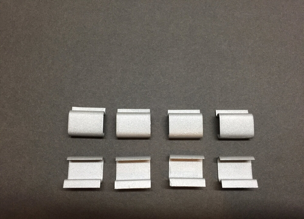

easypops 8 Posted May 17, 2023 (edited) The clips are pictured here mate, sort of sprung offset U shapes. The only danger is breaking the plastic part they grip around. As far as I remember I came in from the side with a small flat head screwdriver 👍 Edited May 17, 2023 by easypops Quote Share this post Link to post Share on other sites
fla 9 Posted May 17, 2023 Thanks for that. The ones I'm struggling with are the plastic triangular ones - just afraid I'll break them. I'll rake a proper pic and post up, but this is the box for ref Quote Share this post Link to post Share on other sites

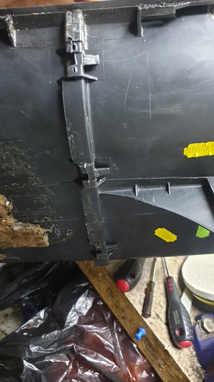

fla 9 Posted May 18, 2023 On 5/17/2023 at 5:06 PM, easypops said: I can’t quite remember plastic triangle ones but when I looked back it’s been a good few years since I did that task Its these ones. Tried squeezing with pipe grips, gentle twisting with a screwdriver and also trying to open the slot into which they've been pushed through, but no luck at all. I'm afraid they'll snap off then I'll be really snookered Quote Share this post Link to post Share on other sites

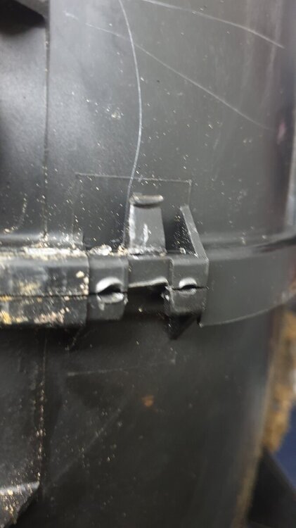

fla 9 Posted May 18, 2023 I've had some unsuccessful goes at these three Quote Share this post Link to post Share on other sites
