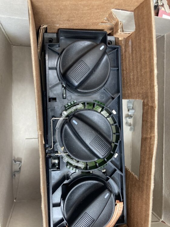

Keyo 49 Posted March 26, 2022 (edited) Fitted these new Heating controls today - you can still buy them new from classics rhd - i must say they are gash compared to the reliable simple old heater controls in the g60 and the mk2 - its a plastic cog hell fest. From what I have learnt I purchased some new silver clips but they would not fit for love or for money so just used the old ones which were still good- proper head sweat job as didn't want to brake the plastic lug the clip houses the cable to - really do not use the new clips you will damage the lug trying to get them on if you carry on- I stopped re thinked went into my loft and got some old ones that worked perfectly. Its still a bit stiff direction dial - only when in speed 3 and 4 bizarre - in the long run the box would need to come out and lube the cogs and felt the flaps so smooth - annoyingly the last owner paid a garage £800 to do the matrix but the buggers only did the matrix and not refurb the box- waste of labour !!! Edited March 26, 2022 by Keyo Quote Share this post Link to post Share on other sites
1xshaunx1 27 Posted March 26, 2022 Mine was a box of bits when I bought the car, proper head job, I feel your pain. Did you do braided front brake lines on this car Quote Share this post Link to post Share on other sites
Keyo 49 Posted March 26, 2022 (edited) On 3/26/2022 at 6:20 PM, 1xshaunx1 said: Mine was a box of bits when I bought the car, proper head job, I feel your pain. Did you do braided front brake lines on this car Yes have some Hel stainless on the front brakes mate . The f ing things cost 260 I think and getting the new clips on so easily could of write the buggers off by braking the chocolate tabs - just glad im learning walking away and re think - old clips were either streched all ready or the new clips are out of tolerance. So Im really warning people use the old clips if you dont want to write off the new heating unit. My other advice is they are that shit a design just leave the direction to window demister and never touch the basterd thing - you know a bit like the fogs never go near that £££££ button ha- or the sunroof. Another hint I knew it was there as broke a coulpe of cars the screw up in the left vent to remove the centre console jelly trim - what a place ha. Edited March 26, 2022 by Keyo Quote Share this post Link to post Share on other sites

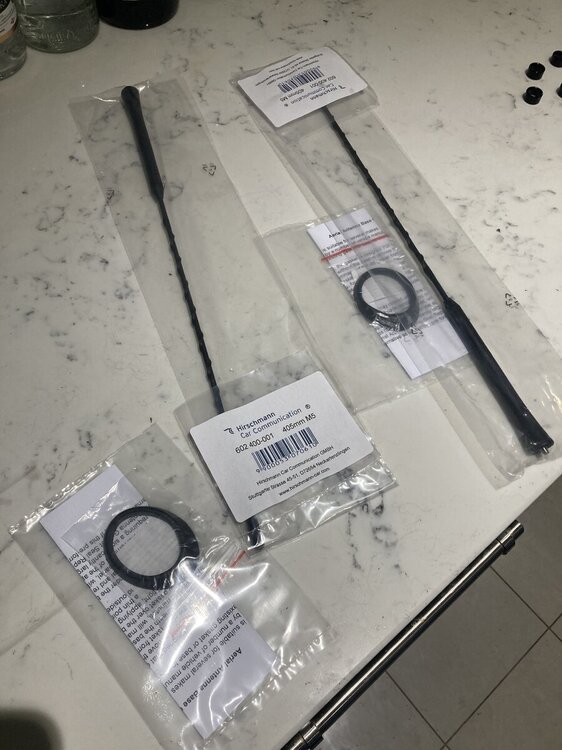

Keyo 49 Posted March 26, 2022 (edited) Im going to do this tomorrow on a couple of the cars . Its the OE supplier can still buy on ebay. Hirschmann. Same seller sells the seals if you look at other items. https://www.ebay.co.uk/itm/171216178792 Edited March 26, 2022 by Keyo Quote Share this post Link to post Share on other sites

James. 9 Posted March 26, 2022 Agree on the heater controls, early always gets my preference. I’ve seen people trying to wrench the direction dial when on speed 3 and wondering why they break 😳. Crazy. Is that a powered aerial I spy ? Quote Share this post Link to post Share on other sites
Keyo 49 Posted March 26, 2022 On 3/26/2022 at 8:28 PM, James. said: Agree on the heater controls, early always gets my preference. I’ve seen people trying to wrench the direction dial when on speed 3 and wondering why they break 😳. Crazy. Is that a powered aerial I spy ? It is chap well spotted its a 191 part number golf mk2 came off an early corrado i broke and still nice and silver underneath- but its going on my Mk2 Im afraid tomorrow as old one is 32 years to old . Quote Share this post Link to post Share on other sites
