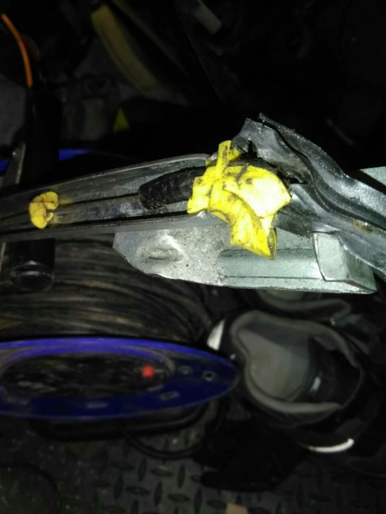

TomB 0 Posted April 15, 2021 Thanks all, so far, I’ve discovered that the driver’s side one is damaged (I suspect by the bending of the door). The yellow plastic guide at the top of the channel has broken allowing the cable sheath to move past it. This is going to affect the mechanism. The cable sheath further down has also broken (although that can be taped up to stop it moving as the cable still runs freely). I think that I’m going to put/leave the manual winders in for now just so I can get it back on the road in a drivable condition to get it to a body shop to fix the rest of it! While it’s there, I can look at repair kits/replacement regulators to fix the electric mechanism and refit that at a later date. Quote Share this post Link to post Share on other sites
1xshaunx1 27 Posted April 15, 2021 I’m sure fla had a fix for this Quote Share this post Link to post Share on other sites
fla 9 Posted April 15, 2021 On 4/15/2021 at 6:13 AM, 1xshaunx1 said: I’m sure fla had a fix for this Thanks Shaun. Yes the easiest thing to do is to get the smallest u-bracket you can find (Screwfix do them i think) and screw this across the top of the channel, underneath the yellow plastic. This holds the plastic portion in place and maintains tension in the cable guide. Best to pull the cable sheath as far up as possible before you mark the holes to drill, then just screw the loop down. Use the base portion, which is usually a slotted billet piece, on the cable side, and put the loop portion on the other side - if that makes sense! Hope that helps Hasan Quote Share this post Link to post Share on other sites
TomB 0 Posted April 15, 2021 On 4/15/2021 at 11:57 AM, fla said: Thanks Shaun. Yes the easiest thing to do is to get the smallest u-bracket you can find (Screwfix do them i think) and screw this across the top of the channel, underneath the yellow plastic. This holds the plastic portion in place and maintains tension in the cable guide. Best to pull the cable sheath as far up as possible before you mark the holes to drill, then just screw the loop down. Use the base portion, which is usually a slotted billet piece, on the cable side, and put the loop portion on the other side - if that makes sense! Hope that helps Hasan That’s really helpful, thanks Hasan. Quote Share this post Link to post Share on other sites
