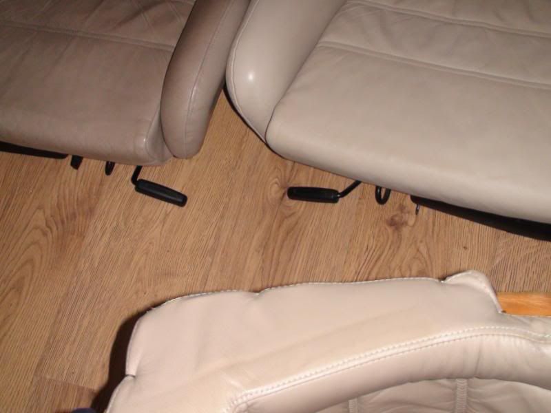

the drivers recaro sat next to the passenger one now looks completly shagged and im looking at it wondering where the hell do i start with it as it is quite a mess in comparison.... im not sure how this one is going to turn out tbh but ive got to do it....
one positive note about all of this is the furniture clinic who supplied me the clourant got it absolutly spot on!!!

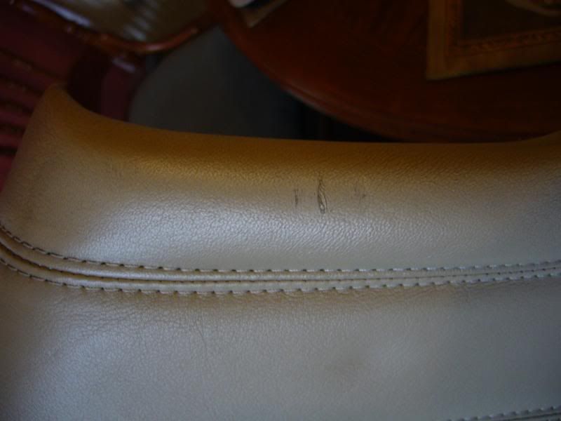

????hows that you might be thinking......... well the rear seat base ive taken out today and the sides never see the light of day, and in all its glory the colour has been preserved....and its a damn good match,ok its still 16 years old and the seat i have just done has ot got any feed on it yet but you can see its almost there much better than i first expected!

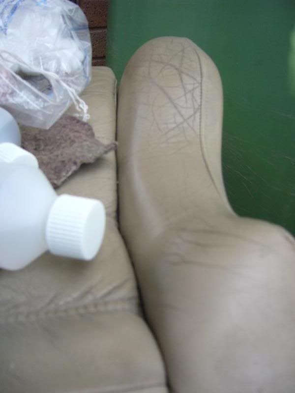

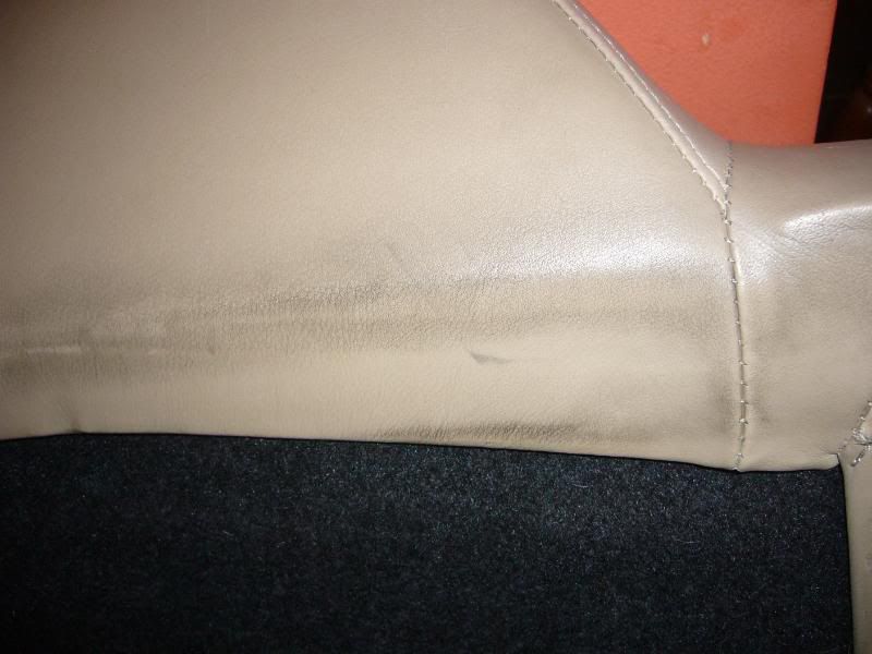

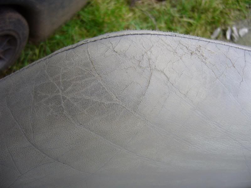

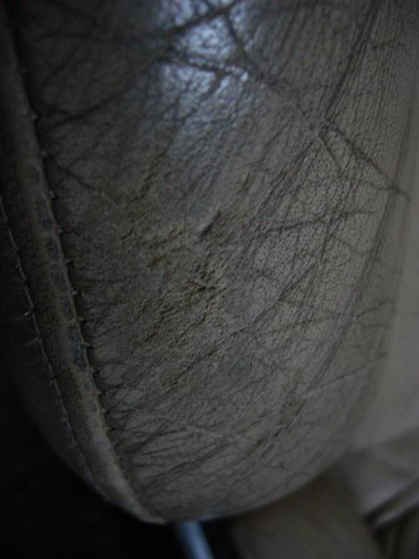

the bolsters on this one are far worse than the other.... but it is the drivers side so i guess should be expected.....

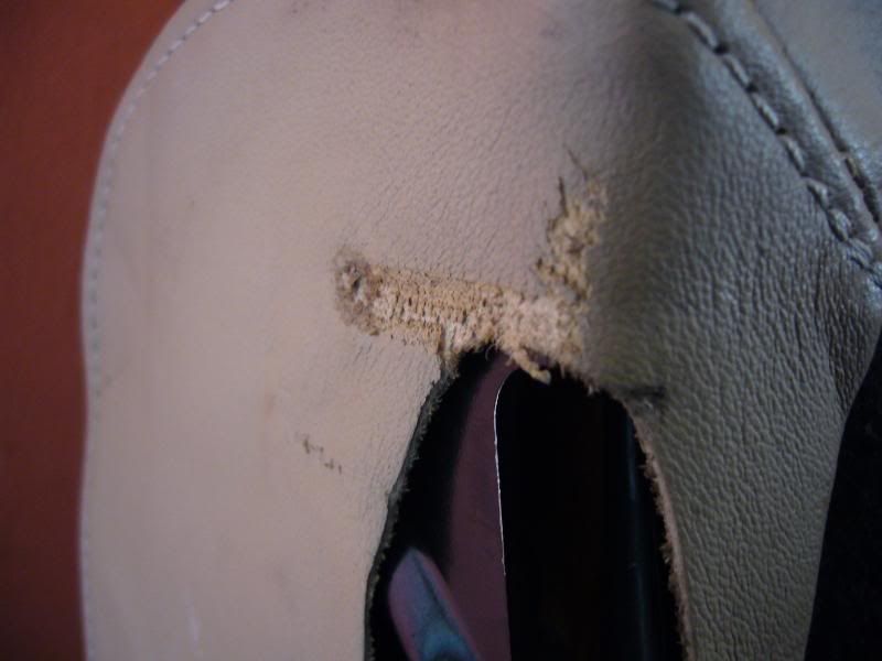

this is something i have got to repair before it makes a hole!!!

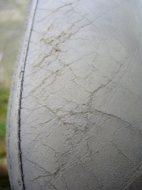

the back of most rados seats are trashed like this one always real dirty and have big scrathces /battle scars....

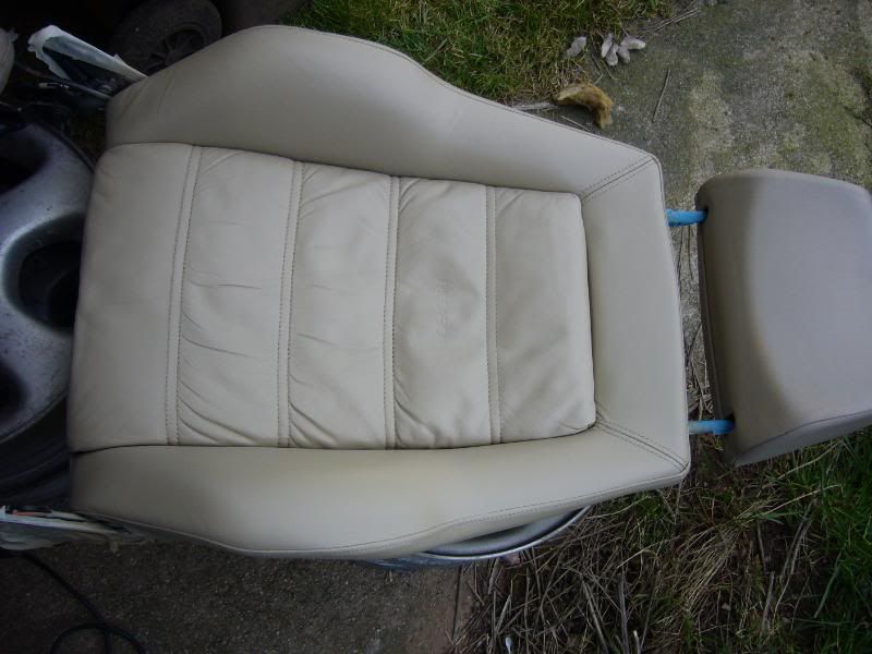

cheers guys , yea done the head rest was a pain as the material ? clip underneath had come undone so it took me ages and ages to get it back on properly looks sorted now though even spent some time cleaning all the seat plastics up so the seat is almost as good as new.....

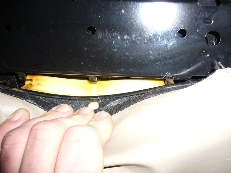

so to start you got to take the centre section out by pushing the metal bar thats held in by these shitty clips....
once thats been achieved you should get something like this to look at

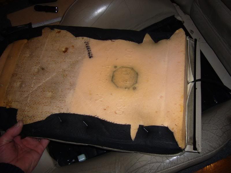

next onto the seat base and do the same take out the staples etc

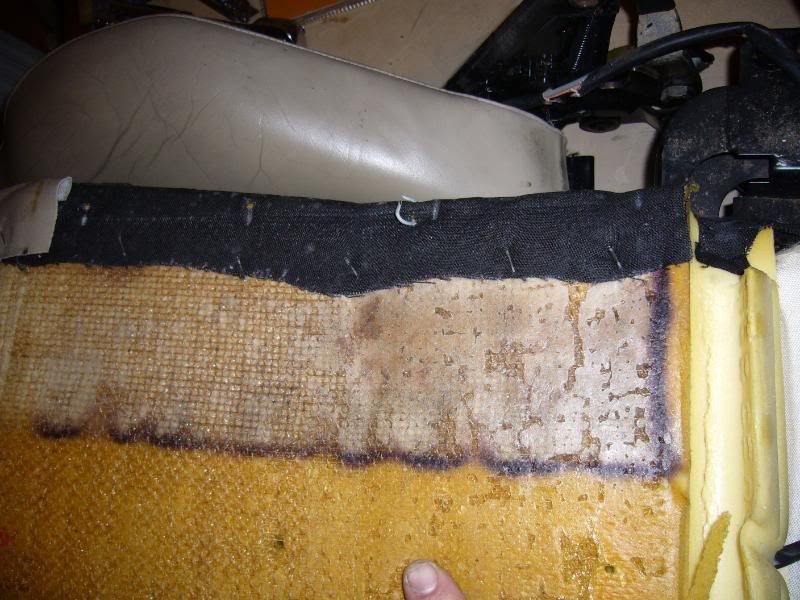

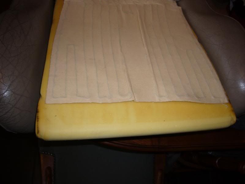

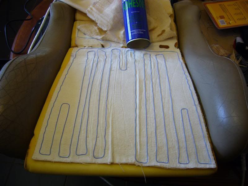

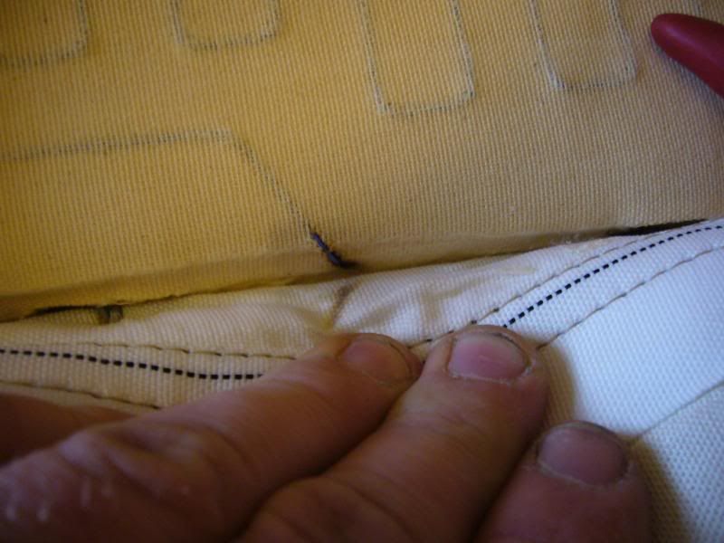

the heater element is sandwiched between this cloth material...
over the years this one has creaped back and squashed up i thought that this might be the cause of the fault??

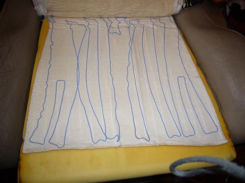

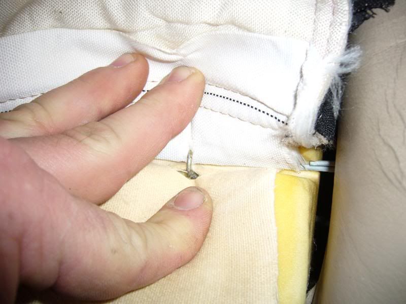

i seperated the cloth to see what the loom looked like
the element looks fine
needed to go deeper

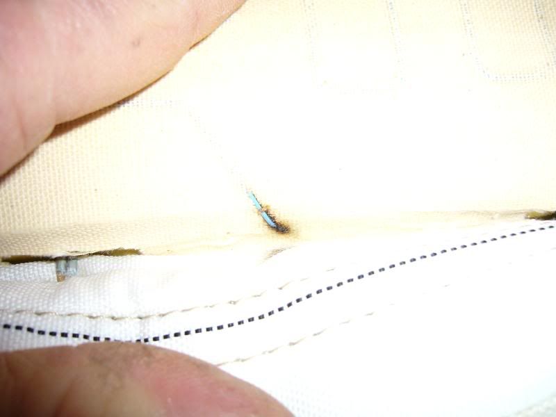

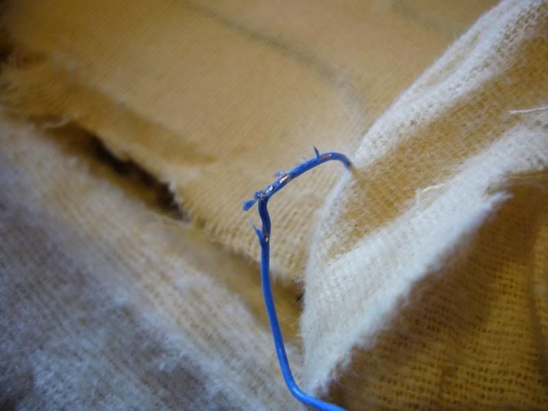

ah whats this??
yep the element has burnt out.....

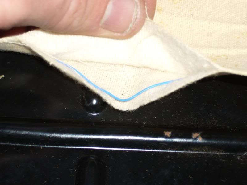

the trick is to test the element where you think its good and work back from there i localised the3 fault but i wanted to see where it exactly broke...
so i went about stripping the wire back slightly to find the break and i struck lucky
here it is if you look carefully you will see the blue wire that has melted between the break making the open circuit...
i then soldered it up and ironed the material flat so it would fit the base again i sprayed it with spray glue and then placed the heater element back out as ti was supposed to be

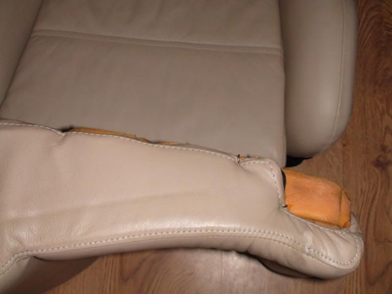

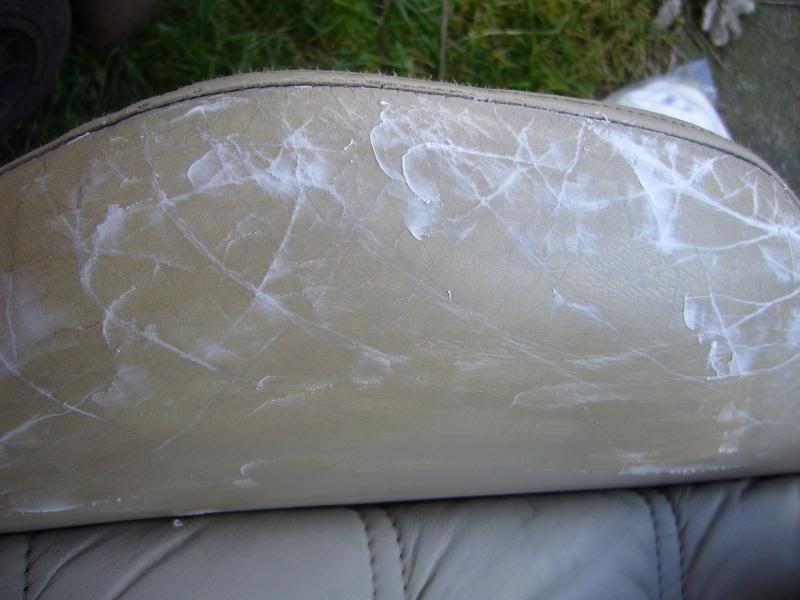

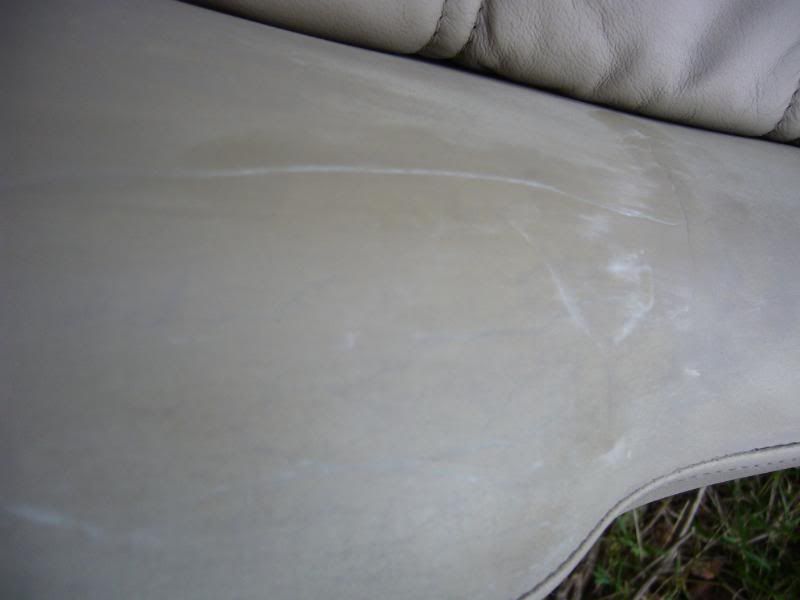

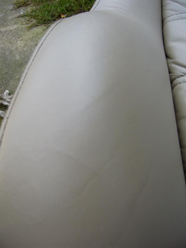

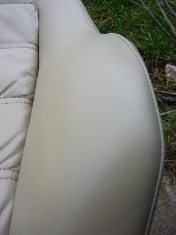

the drivers bolsters were bad much worse when i looked at them in detail and i began to wonder if i could make them better
these pics were taken after i started the prep in no paricular order...
i broke out the filler and went a bit crazy
the bolsters look so much better

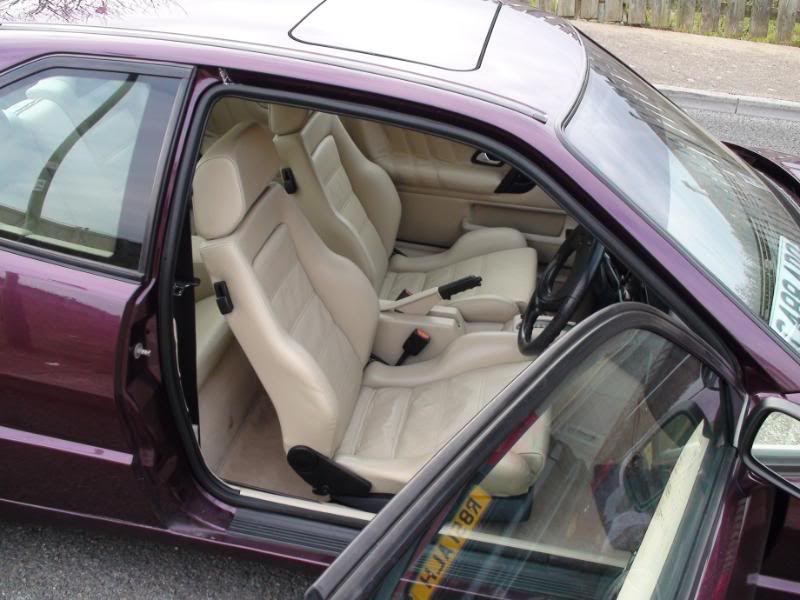

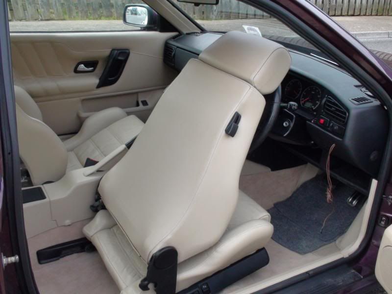

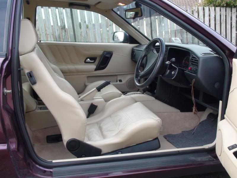

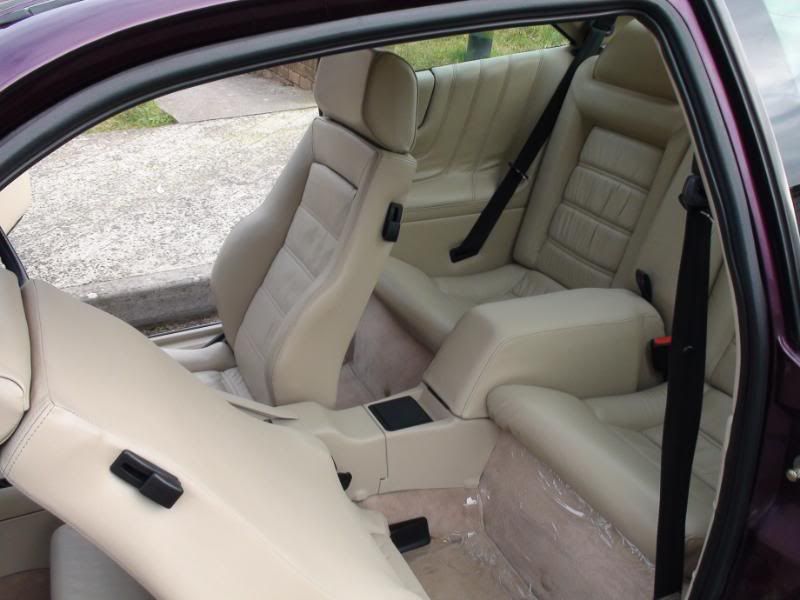

my car looks like one of those magazine features with mega mint interior now and i am so chuffed lol
Pictures of this please :)
il grab some daylight pics tomorrow of the interior i need to put the shelf in etc but 99% complete now it looks awesome i just wish i knew how to dye the carpet beige again and i would have done that too!!
very chuffed with the results

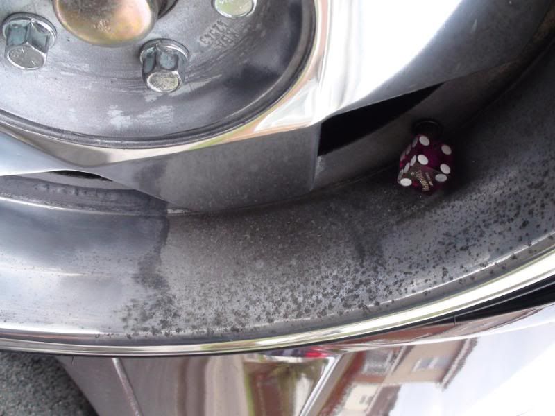

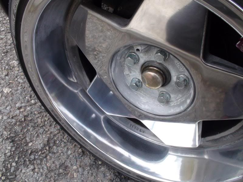

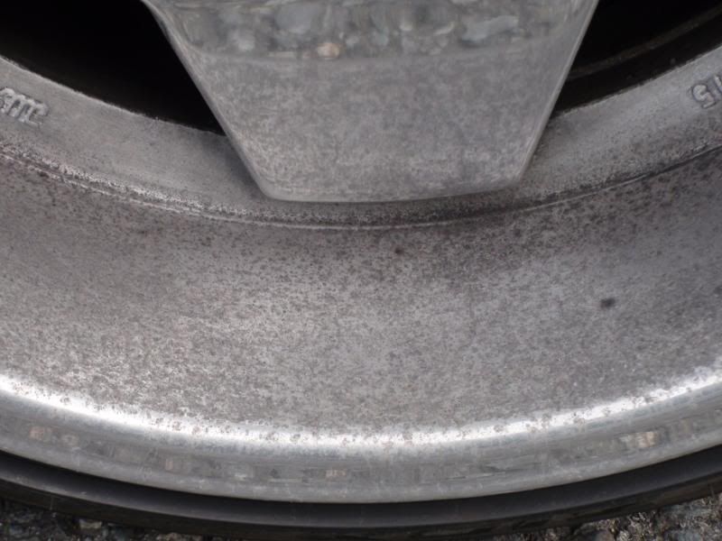

my rims are seriously fecked!! so instead of the interior thing i thought id take a break from it and try and polish my rims, and its working but very very slow progress and its even worse as its so cold outside, we live on a hill and its always windy where we are!! so even worse!!!
as you can see bad state
this is one of those jobs you wish you never started, i dont have a jack at the moment so its not like i can take a wheel off and bring into the house either..... might have to invest in one!!

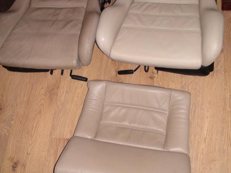

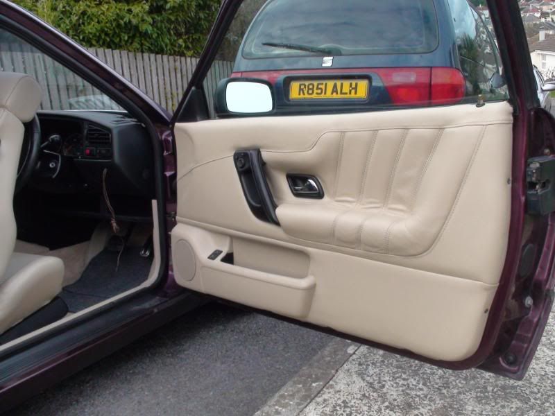

couple interior shots still got some trims etc to put in but il do it when ive got some other bits and pieces ready
ive had the seats in and out this week they were painted this week i just need them in asap ive used the car quite a bit and they so far seem to be holding up very well, im trying not to get marks on them ( i cannot feed the leather for 7 days )
im thinking of painting the inner lips of the wheels nimbus grey or whatever its called its a nicecolour and will be a bit different on the wheel, il keep the spokes and lips polished but the band that goes in and around the spokes is just bare metal at the mo so not only will it stop the wheels looking dirtier than they are itl be easy to clean!! lol
