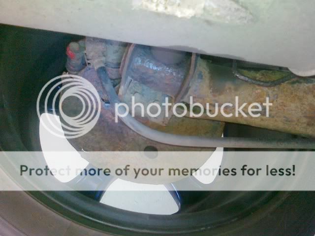

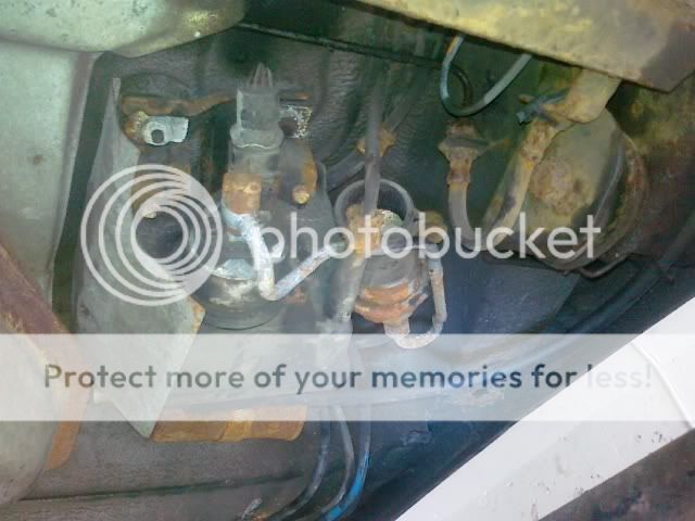

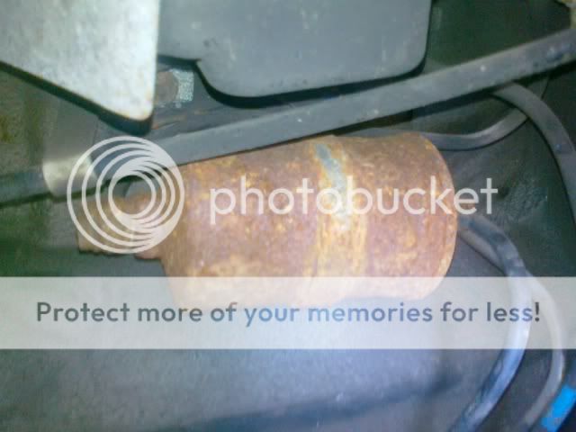

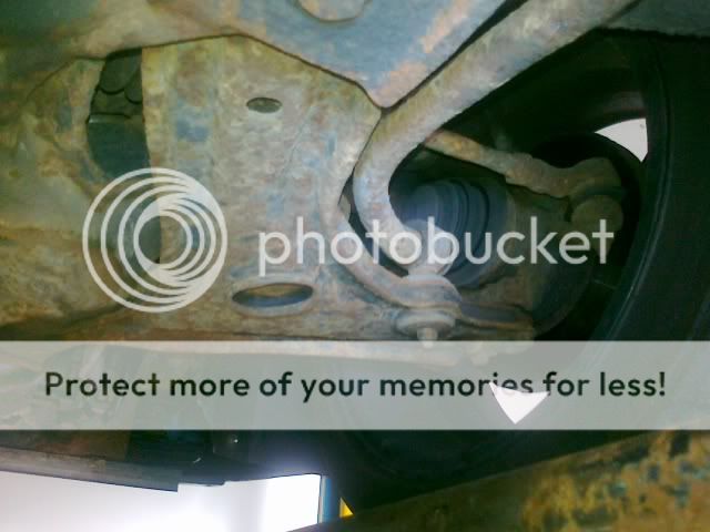

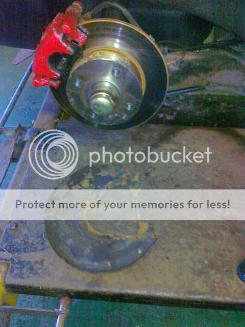

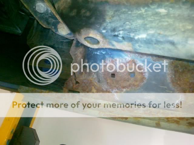

Akinesis 0 Posted August 1, 2010 Ok, here is some picks of the underneath of the car: This is looking behind the front bumper: Drivers Wishbone: Rear passenger-side wheel Rear driver-side with heat-shield rusted through (it has fallen off and was knocking around the caliper). It has actually split the piston-boot on the caliper, so these will need changing soon :( Fuel filter: Fuel pump unit: So, is this normal for this age car?? Quote Share this post Link to post Share on other sites

Toad 0 Posted August 1, 2010 Pretty sure the rusty canister is the fuel filter. I think I'd change that next. Quote Share this post Link to post Share on other sites
mrbeige 0 Posted August 1, 2010 Mine 'looks' worse than that, but it looks as superficial as Katy Price! Nothing to worry about, really, but as Toad says get the fuel filter changed next. Quote Share this post Link to post Share on other sites
davidwort 0 Posted August 1, 2010 looks like it's been driven a lot on winter salted roads or perhaps a sea-side car for some of it's life, either way it does seem to have a fair bit of corrosion for a 2L 16v, I'd expect to see more of that stuff on an earlier 1.8 but then all these cars are getting on a bit now. Those front wishbones are probably perfectly serviceable, but your front radiator support panel is pretty bad, it is a weak spot on Corrados and really needs checking thoroughly and re-coating with protective wax every couple of years at least. the rear fuel pump, pressure accumulator and fuel filter, together with all the unions do get bad on these cars too, they may well last a long time even when they look aweful, but again, they really suffer from road spray in the winter. If you haven't done already, I'd have the rear bumper off, given the condition of other bits on this car, that and the area behind it suffer from the salt spray too. There's nothing really better or worse than a mk2 golf on these bodies really, it's all down to individual cars and what sort of driving they've had, lots of miles on winter roads, especially shorter journeys on more minor roads that get salted but don't dry out as much from traffic are the worst I reckon. My first mile to work is on smaller local roads that are always damp in the winter, but as soon as I'm out on the dual carriageway/motorway the roads are salted but the traffic flow dries them out and the spray level is much lower, even though I rack up more miles on them. waffle over... Quote Share this post Link to post Share on other sites
Akinesis 0 Posted August 1, 2010 Yeah, the fuel filter is next :wink: Got a price for just over £100 from GSF. It'll get done along with new suspension next month. I'm glad this is relatively 'normal' :roll: I plan to spend a couple of weeks dropping the wishbones, subframe, rear-beam, etc down and getting them sorted. But will probably be a winter thing :norty: Thanks for making me feel better about the car, guys :wink: Quote Share this post Link to post Share on other sites
Toad 0 Posted August 1, 2010 £100 for a fuel filter???? Quote Share this post Link to post Share on other sites
Toad 0 Posted August 1, 2010 Someone is trying to bend you right over. Unless they are pricing up replacing all of the pipes as well. From the GSF site. 121VG0070 FUEL FILTER-BQ CO 2.0 16v 9A Engine 91>95 8.40 Quote Share this post Link to post Share on other sites
__Andy__ 0 Posted August 1, 2010 Yeah, the fuel filter is next :wink: Got a price for just over £100 from GSF. It'll get done along with new suspension next month. I'm glad this is relatively 'normal' :roll: I plan to spend a couple of weeks dropping the wishbones, subframe, rear-beam, etc down and getting them sorted. But will probably be a winter thing :norty: Thanks for making me feel better about the car, guys :wink: that would of been a price for an oe fuel pump dude, deffinately not a fuel filter as they are pennies! Quote Share this post Link to post Share on other sites
davidwort 0 Posted August 1, 2010 or the pressure accumulator, filters are about 7quid Quote Share this post Link to post Share on other sites
Supercharged 2 Posted August 1, 2010 Jesus - yeah that's pretty bad but hopefullt the rust is mostly on the suspension components and the underseal on the chassis is doing it's job?? Clearly a complete lack of servicing though - I've never seen a fuel filter in that condition before, ever! Quote Share this post Link to post Share on other sites
steveo29 0 Posted August 1, 2010 doesnt look that awefull its an old car afterall , remember alot you see on forums have been tinkered with alot having had those kind off bits painted or replaced earlier in thier life , or the cars have been babied and not used in the winter my golfs that get used aint much differant , ive repainted all the running gear , those disc covers do tend to get scabby anyway you wana worry about the bits that dont bolt on , like the sills /floor etc , thats 10x more expense to make right Quote Share this post Link to post Share on other sites
Akinesis 0 Posted August 2, 2010 Wow - I have been seen off with the fuel filter!! £8 sounds much better! Will do that this month then! Quote Share this post Link to post Share on other sites
