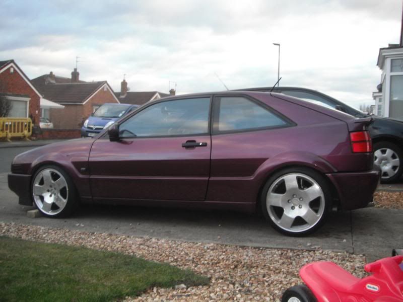

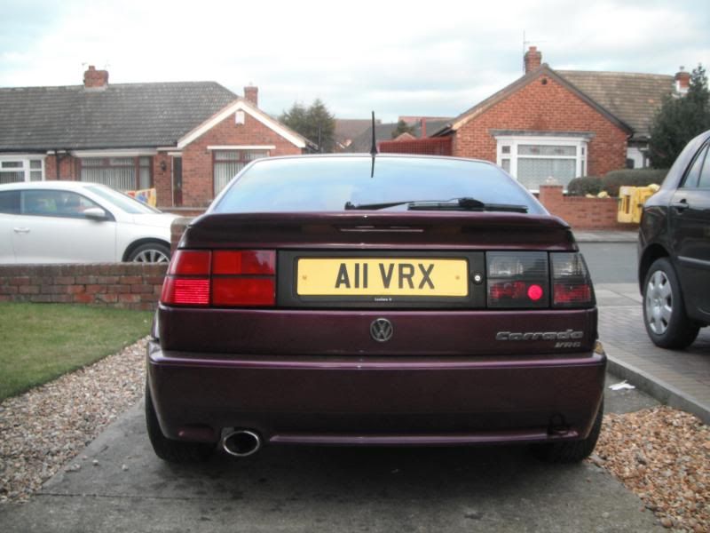

A quick wash and dressing, and used the CG Jetseal 109 I've just received. Only managed one coat though as the heavens opened just as I finished buffing off! Was great to see a bit of beading straight away though! This stuff is awsome, only downside is that it now shows every chip, scratch and dink on the car. And there are A LOT! Great beading, and fantastic glossy look! Also changed my repeaters for clear ones.
