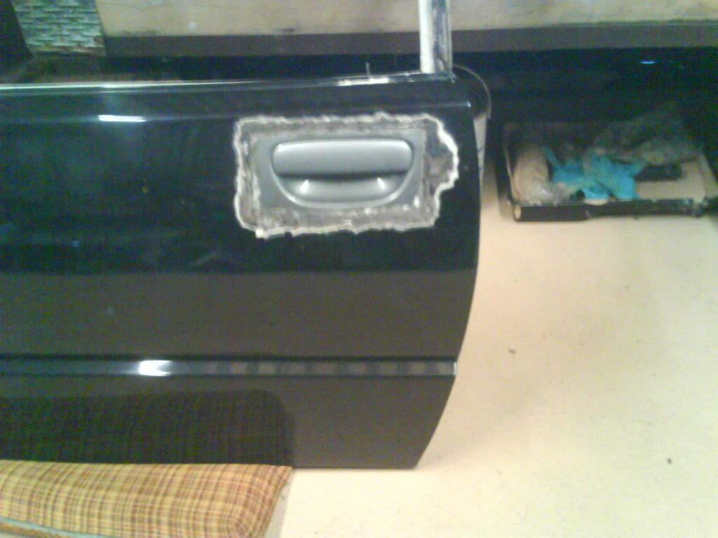

Finished refurbishing my spare passenger and drivers inner handles. They were quite poor condition and had been replaced with much better versions, so I had nothing to lose by giving it a try. So I wet sanded them down lightly with fine paper to take the rough edges off any scratches. Then thoroughly cleaned them. I didn't have any primer so I gave them a coating of diluted pva to increase adhesion. Then several coats of Halfords black vinyl spray.
They have come out really well so I will let the paint harden overnight and then fit them in the morning. Very pleased so far.

Put on the wiper motor cover and top strut covers. Also started returning the drivers side inner door handle trim... Sanded it back, grey primer, top coats of black vinyl paint. The passenger side came out very well although this one doesn't seem quite as good a finish (yet).
