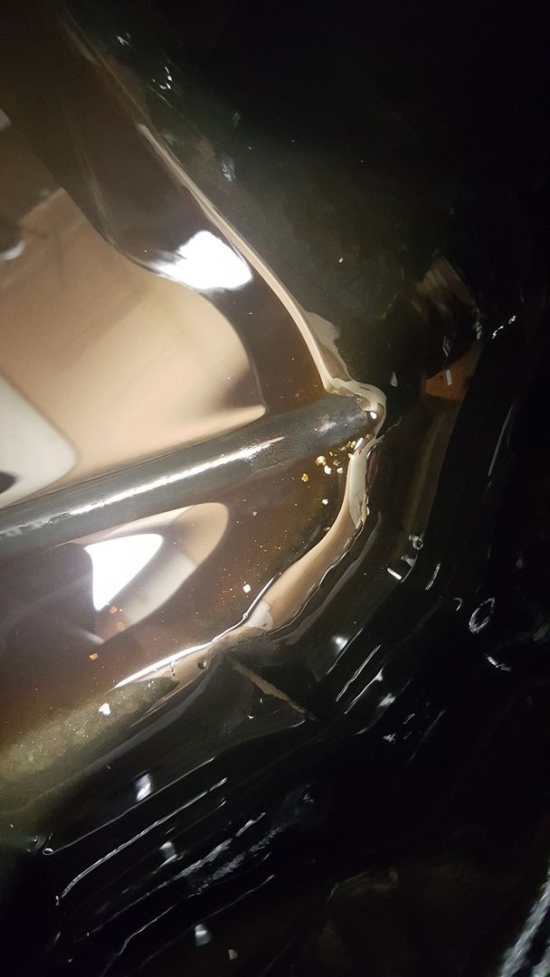

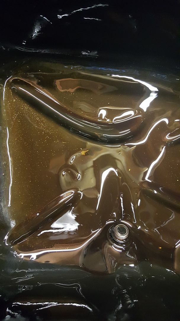

Jim Bowen 1 Posted April 13, 2016 Started to take engine apart, got rocker cover off and couldn't see anything wrong, cams looked ok and the timing chain still tight, didn't take cams out so couldn't really see if the valves were still there. Then took sump off, seems to have quite a bit of metal flakes in there. Oil seemed very gloopy as well. Looked up into the bottom end from underneath and couldn't see anything wrong, but i'm not 100% sure what i'm looking for. Think i'll take the head off next. Quote Share this post Link to post Share on other sites
