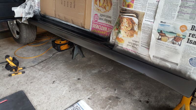

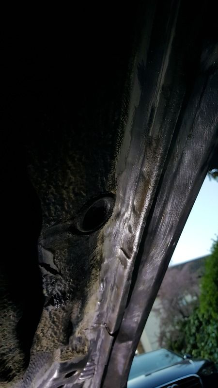

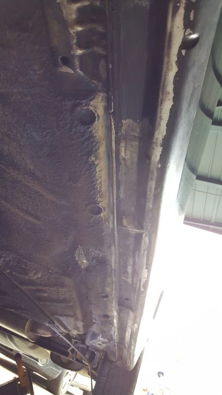

Jim Bowen 1 Posted May 24, 2016 Not really got any further with the engine, not got any way to transport it any more, may rent a van or something. So using the time to do the underside/sills again, stripping off the stuff i put on as i wasn't totally happy with it. Took the ston echip off the seals, just going to paint them Door shut needs painting and new sill covers And then back underneath, i must enjoy the pain of lying under the car and sanding upwards. Quote Share this post Link to post Share on other sites

Jim Bowen 1 Posted May 24, 2016 Just doing one bit at a time now. rather than taking paint off everywhere and getting overwhelmed with it all. I think i might look into getting a compressor and spray gun. Am sure i can convince a mate to build a spray booth in his workshop. Quote Share this post Link to post Share on other sites
SR_Neale 10 Posted May 24, 2016 Probably not what you want to hear but I would advise that you paint everything that needs doing in one hit in order to get the colour match right. What else needs painting apart from the sill? What size compressor are you thinking of? I would also advise using an air fed mask if you plan to use 2k which will require a compressor that puts out at least 14cfm. Where shouts I Essex are you as I live in Essex and could help you out if you like. Quote Share this post Link to post Share on other sites

Jim Bowen 1 Posted June 2, 2016 Haven't you finished it yet?!? :D Good solid car that. Good work! Cheers, i'm mainly after making sure it has no rot/rust anywhere. Not finished yet as the weather turned damp again. Managed to get some anti rust primer and then some hi build primer on last weekend, been sanding since that. I drilled the hole in the sill, so i can squirt the cavity wax in (in case anyone wondered) Grey is the hi-build primer, which i've sanded back, ready to paint Quote Share this post Link to post Share on other sites

Kevin Bacon 5 Posted June 3, 2016 Cool! I would get some grey stripe under there where you've scraped the original rubbery stone chip stuff off personally, but otherwise it's looking sweet! Quote Share this post Link to post Share on other sites
Jim Bowen 1 Posted June 3, 2016 I was going to paint it body colour and lacquer underneath, then considered using that paint protection film on the sills etc Quote Share this post Link to post Share on other sites
