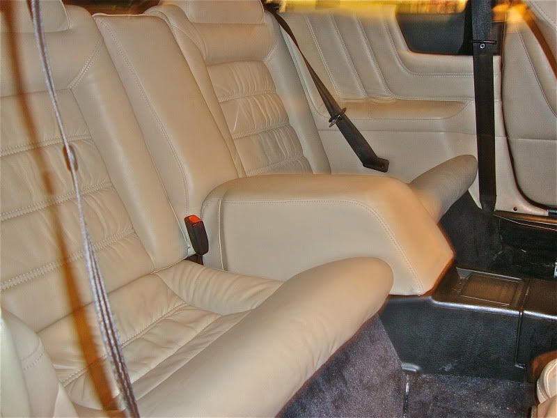

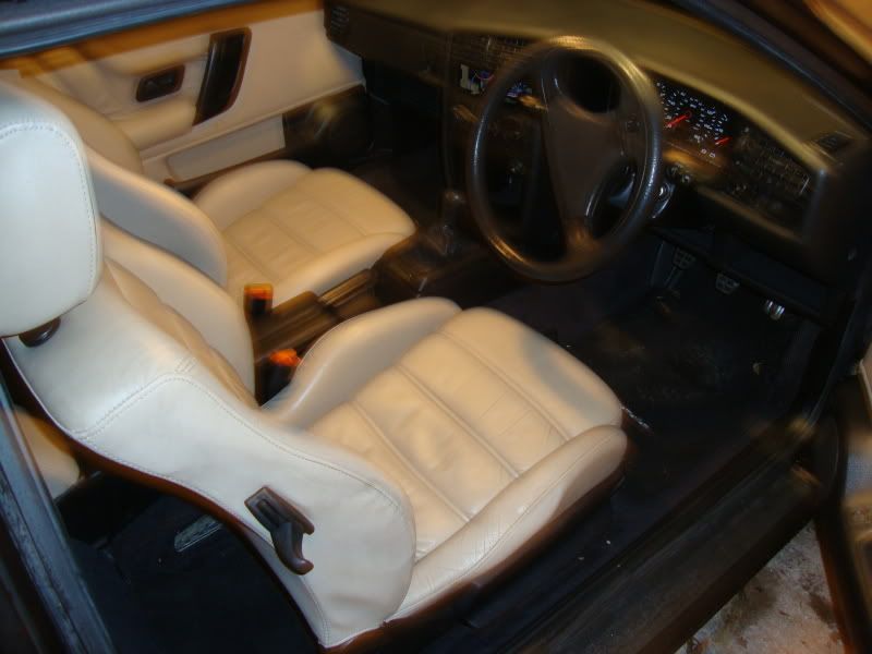

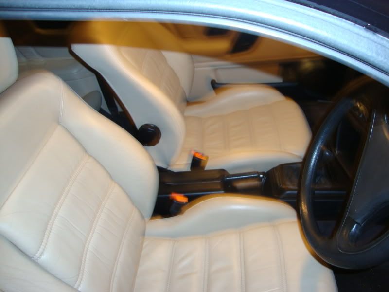

robrado974 1 Posted December 17, 2011 (edited) Well its been a while . Not long ago i had the chance of getting a beige interior from matt , thought it would go nice with the dbp. I like having the black door pods instead of the beige ones as well Big thanks to matt for offering it to me . not the best pics as they were taken in the garage , thanks Rob Edited December 17, 2011 by robrado974 Quote Share this post Link to post Share on other sites
dragon green 5 Posted December 17, 2011 Look really good,you must be well pleased, Cant believe how clean your carpet looks in the rear footwell ! Quote Share this post Link to post Share on other sites
robrado974 1 Posted December 17, 2011 Thanks mate , carpets have been through the washing machine lol. Quote Share this post Link to post Share on other sites
20vtvw 0 Posted December 17, 2011 trim looks realy nice,,i have the same in my dbp Quote Share this post Link to post Share on other sites
robrado974 1 Posted December 17, 2011 Yes it does , i had black before ,but was not sure bout beige . I saw the pics that people put up n thought yea this will look nice . Quote Share this post Link to post Share on other sites
Abdul 0 Posted December 18, 2011 Hey fella that looks great. I had the same combo in my DBP too. Quote Share this post Link to post Share on other sites
robrado974 1 Posted December 18, 2011 Thanks abdul .Rob Quote Share this post Link to post Share on other sites
CazzaVR 0 Posted December 18, 2011 Liking that combo a lot- good work! 8) Quote Share this post Link to post Share on other sites
robrado974 1 Posted December 18, 2011 Thankyou im very pleased with it .Just needs another clean now ,got me grubby mits on it whilst fitting . Quote Share this post Link to post Share on other sites
Chris Langdon 0 Posted December 24, 2011 very nice mate, the beige really goes well with the BROWN colour of the car lol only joking fella, yep matt has his uses lol Quote Share this post Link to post Share on other sites
8vMatt 1 Posted December 24, 2011 very nice mate, the beige really goes well with the BROWN colour of the car lol only joking fella, yep matt has his uses lol Yep, I make both your cars better. Agreed with the others, the combo does look the business. All the swearing when fitting it was worth it. Quote Share this post Link to post Share on other sites
robrado974 1 Posted December 24, 2011 Thanks guys , chris you need to go to specsavers lol, Matt with all the time we have off we need to sort yours . Had a good night last night ,had to go when i did i would have fallen over otherwise lol. I recon a for more days work on robster n we will have him back in the seat of a rado . Quote Share this post Link to post Share on other sites
KADVR6 0 Posted December 24, 2011 looking good Rob, i actually prefer the black plastics/carpet compared to all beige. Quote Share this post Link to post Share on other sites
