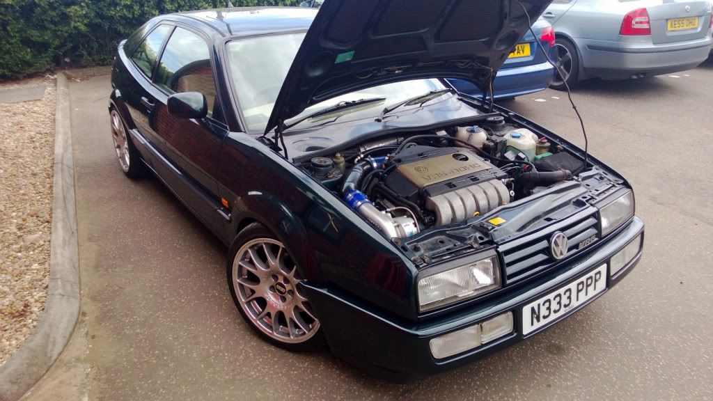

Time for a little update. Dropped off the car to Stealth a couple of weeks back to get a charger fitted. Lots of blips in the road, ended up having to have a lot of work done including tappets, updated injectors, fuel pump etc etc.
In the mean time I was without car as my spare Volvo's gearbox decided to die. Picked up a barge as a replacement, lots of car for silly money:
X-Type 3.0 V6, surprisingly the sensible car!

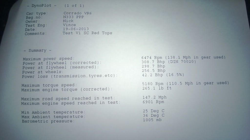

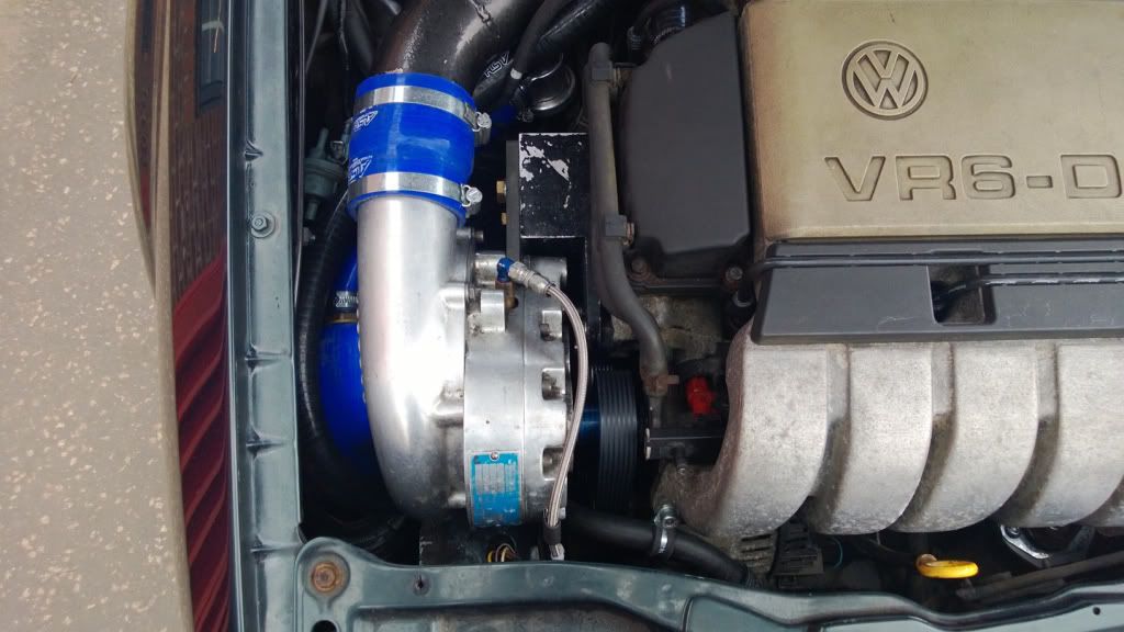

Got a call from Vince this morning, and an hour later I was on the train from Marylebone. Rough breakdown of the spec:
Vortech V1 Supercharger (Stage 2)
Schimmel 263 cams
Mocal 13 Row oil cooler
Red top injectors
Whatever updated fuel pump stealth use
Also got a new rad, plugs and leads.
Initial thoughts, coming from a basically stock VR6 (with an olllld AmD chip): It sounds insane! When revving anyway. At idle it whistles, so you know something is there which takes out a bit of the stealth factor. The car pulls like crazy past 3k, and the cams make it a lot grunting down low. I was giggling home! Although brakes are a must do ASAP.
Some initial pics,

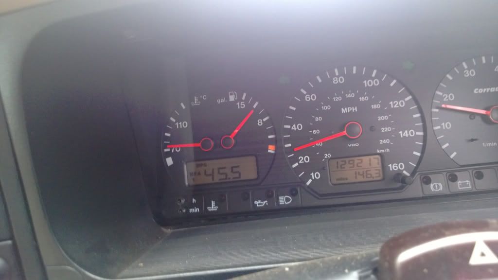

Also found my mpg gauge is playing up now, temp a little lower than usual after a motorway. Maybe something to do with the new rad? will see how it goes over time...
Nick

Mpg gauge on the MFA you mean, and perhaps reading higher than it should? That'll be the red top injectors. Small pulses, which is how the VR6 MFA calculates MPG. Wide open throttle = long injector pulses and cruise and idle = short injector pulses. The ECU is programmed for the original orange tops, so the reds won't read right. I was seeing 44mpg at 80mph with my red tops when it was charged, which is ever so slighlty optimistic :D
Good stuff!
Cheers for clearing that up, explains a lot! My MPG was reading around 45mpg by the time I got home! I'd like to think 308bhp is enough, but let's see how I get on with the charger. I can only imagine a turbo being twice as savage :norty:
