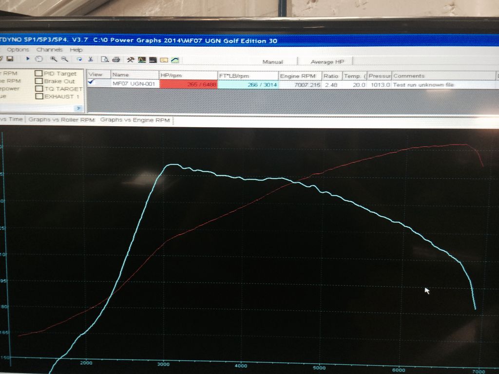

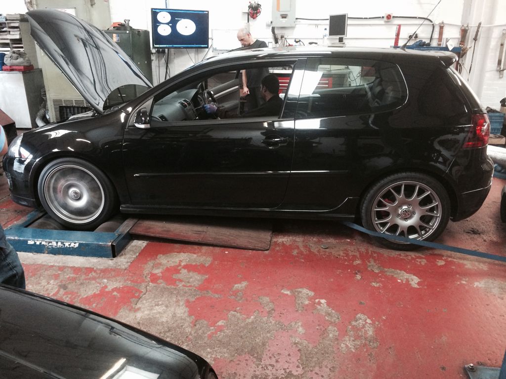

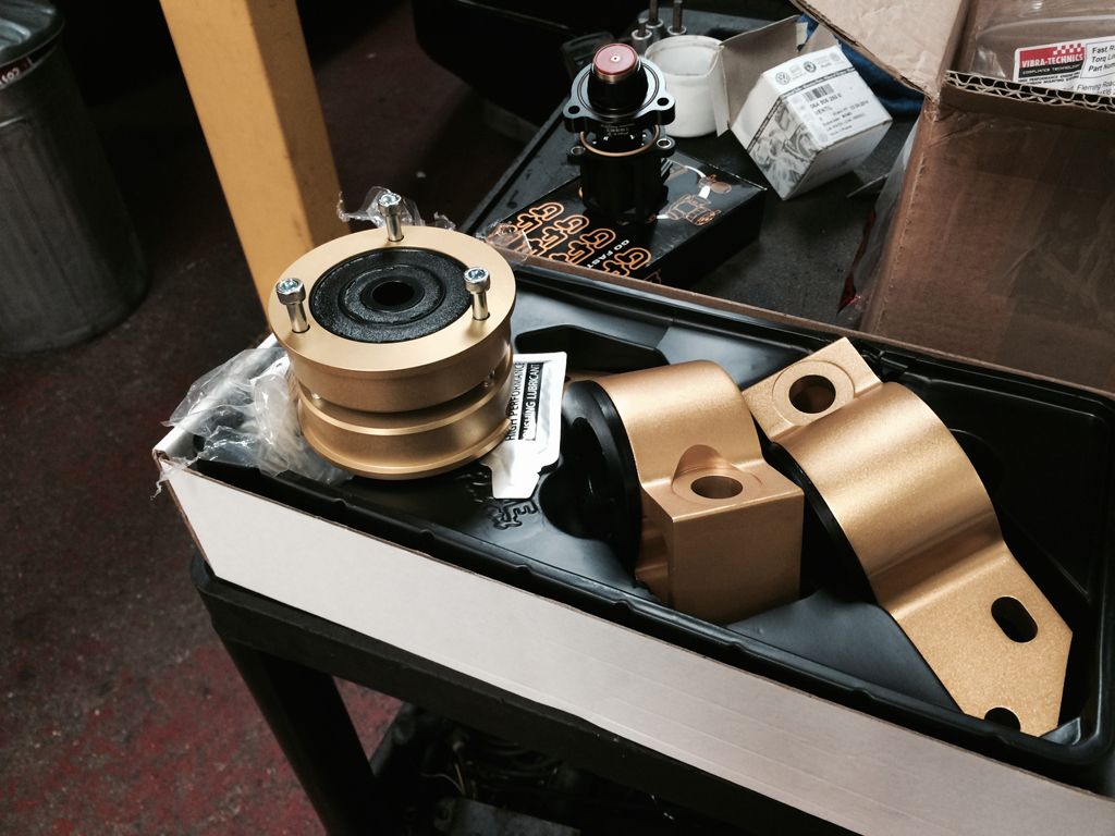

Kevin Bacon 5 Posted October 3, 2014 (edited) Went up to Stealth today to fit a couple of goodies and see what map my ECU had in it, and then get Vince to remap it. Starting with the goodies, we have the infamous "WALK" (WhiteLine Anti-Lift Kit), my old favourite Vibratechnics for the dog boner, and last but not least, a GFB DV+ to replace the OEM diverter valve (aka "dump valve"). The WALK replaces the OEM voided console bushes. A known weak point on this platform. I can see why VAG do that. It reduces steering wheel kick back and smoothes out assorted twitchinesses, but at the cost of feel and precision. The WALK doesn't increase vibration or add any unwanted bad behaviour. Unbeknown to me, the previous owner had already fitted a VT boner (the man has good taste!), so we didn't bother with that. It's a testament to Vibra if I assumed the mount was OEM, because I can't feel the engine at all in the cabin at idle. The WALK did it's job perfectly. Steering and braking are now epic, not that it was too shabby to begin with :D The engine didn't feel quite right with the GFB DV+, so I've gone back to the stock one for now until we can figure that one out. Now onto the mapping shenanigans. My ECU was indeed revo'd by the previous owner as I suspected. Thank god I went to see Vince. Long story short: without him, it would have been extremely difficult to have any map other than Revo in it. That and some other reasons really have put me off Revo & generic flash maps for life, not that I was a big fan of them begin with. To give you an idea of the mental torque curve (more on that later) this was the first power run "as it was" when I arrived. It was a map with everything turned down that Revo forces your ECU to do if you disconnect the battery :scratch::censored: Vince then managed to re-flash a stock file back into the ECU and it then made 245hp. Standard ones make nearer 260hp in the winter apparently :D Oh, 0.9 bar is the stock ED30 boost pressure. Finally I know! A few runs and map tweaks later, we discovered the high pressure fuel pump can't keep up with the demanded rail pressure. What that means in english is, I need a new pump :( But before we discovered that, the car started climbing out of the dyno with Vince's map!!. It had to be tethered down at both ends. Not something I've seen before on their rollers, not even a VRT! They've only seen that happen once or twice themselves, with 500+hp cars. The reason for it, we think, is partly because of the way the torque ramps up so damn fast and because of the way their new dyno software controls the brake retarder. Anyway, with a tired pump, we called it a day at 300hp and 334lbft. The midrange was dangerously lean, so Vince wound it back to 280hp and 300lbft for safety until I get a new / uprated pump fitted. Luckily the ECU throws a fault code if the rail pressure is too low, so I'll keep an eye on it. Vince showed me another ED30 plot running his map which made 338hp, so that's what I'm aiming for :) I'll update this when I get a new pump and the map turned up to the full Bovril level. For now, Ovaltine it is. Another shout to Vince and the guys at Stealth. Legends. Firstly, I always leave with a tonne of new knowledge, thanks to their knowledge sharing and skills. I learned more about TFSI engines from Vince in 1 hour than I did trawling the net for 2 weeks :notworthy: Secondly, their prices are always better than reasonable and lastly, Vince's maps never fail to amaze me. Impeccable manners, creamy smooth and ballistically powerful :D Edited October 3, 2014 by Kevin Bacon Quote Share this post Link to post Share on other sites

Kevin Bacon 5 Posted October 6, 2014 redborbet said: Great results , is there a reason one of these hasnt been dumped in a corrado yet or is the conversion to complicated Should be doable if everything is transferred over but there will always be clocks / immob issues and the fact MK5 onwards takes vehicle speed from the ABS sensors instead of the gearbox. Sean_Jaymo said: I'd imagine there are far too many sensors from all sorts of systems that need to be included for it to work well! Always loved the ed30s, really fancy the 35 myself! Yeah lots of sensors! There's an Edition 35? :lol: I thought the ED30 was a nice touch, and maybe do it again at 50 years old, but one every 5 years is a bit OTT!! rado20vT said: I'm sure you've already found this forum but if you haven't, take a look, they regularly have uprated fuel pumps for sale http://www.mk5golfgti.co.uk/forum/ Yeah I have a look at that from time to time. Not many techies on there though! Quote Share this post Link to post Share on other sites
coullstar 0 Posted October 6, 2014 Impressive figures there. Yeah Mk5's are more about the looks for most at the moment. ED35 was the Mk6. Quote Share this post Link to post Share on other sites
Bullfinch 0 Posted October 6, 2014 An Ed40 must be imminent. I think the GTi turns 40 next year. Impressed by these bhp gains. I imagine the price was less than a 263 cam and remap job on a VR6 and you get far more ponies for your money. Quote Share this post Link to post Share on other sites

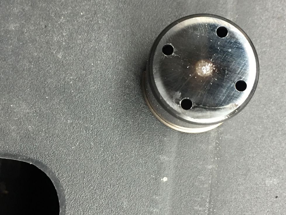

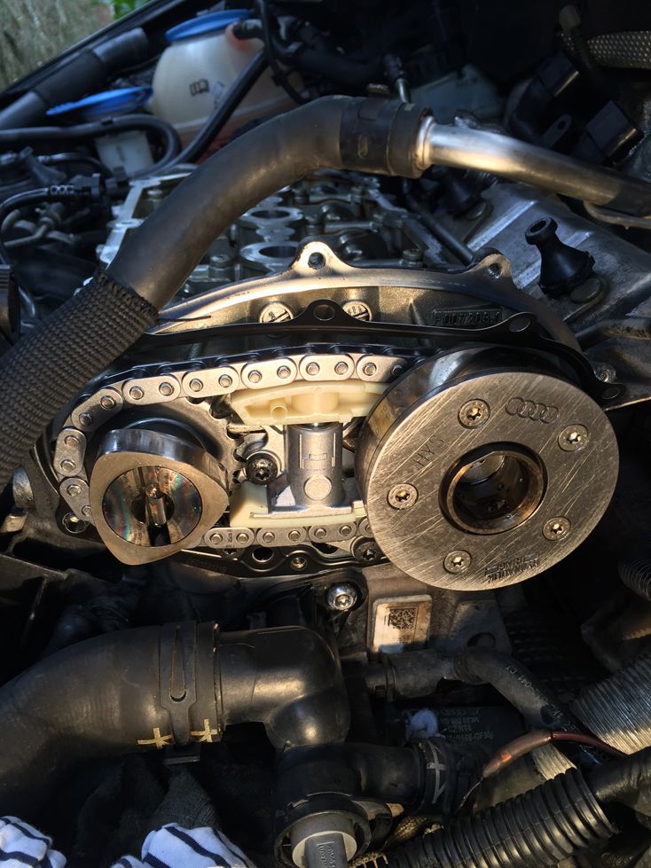

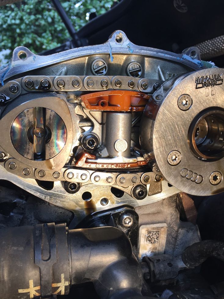

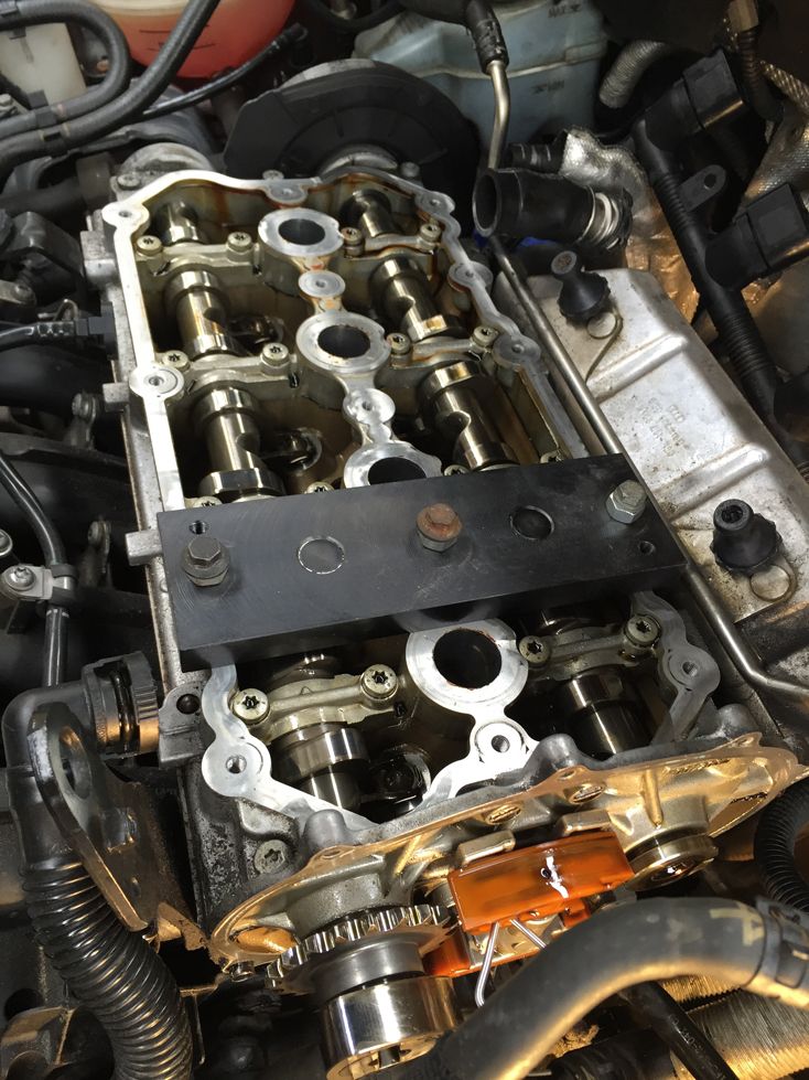

Kevin Bacon 5 Posted March 19, 2016 Still mincing about with the old Edition 30. For it's 100,000th birthday I treated it to a new chain and tensioner today as she was feeling and sounding a bit poorly. There's no getting away from bl00dy chains and VWs is there??! :lol: Engine is damn clean for it's age. I reckon it was looked after before I got hold of it. They're normally creosote brown inside like 24Vs by this mileage. A fair bit of chain droop at TDC and nobody like slack stuff do they? New chain and the droop is a lot less. Car is quieter at idle now which is a bonus. I caught it just in time I think. The chain has a habit of snapping if things get too worn in there. The Loba high pressure fuel pump is clobbering the cam follower HPFP. I suppose this might actually mean something to those with MK5 GTIs but this is yet another duff design by VW but easy and cheap to replace. I miss the basic engineering of the Corrado! Having said that, this job was a whole lot easier than doing chains on the V6s!! Going to be experimenting with a 3" downpipe and more mapping soon and hopefully get it close to 350hp :) Quote Share this post Link to post Share on other sites
Harrier 1 Posted March 19, 2016 Good work, that is amazingly clean in there, It seems to me that only merc and bmw (mostly)can design decent long lasting chains and guides Quote Share this post Link to post Share on other sites
