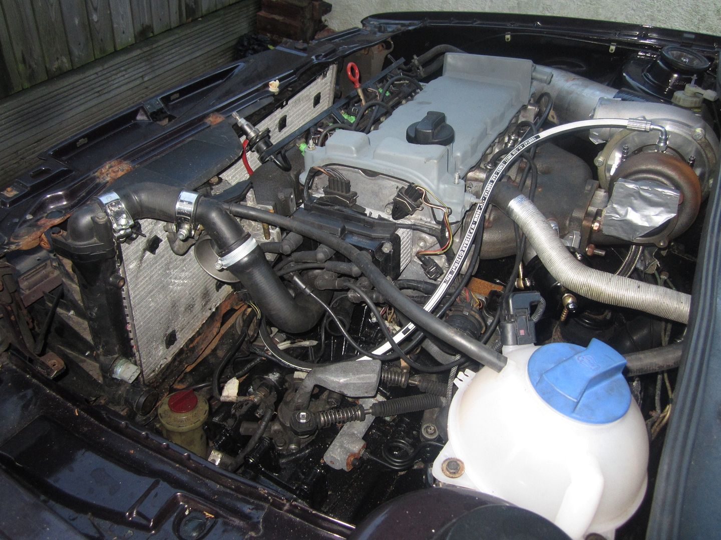

Slow progress on this due to family commitments but things are starting to take shape!

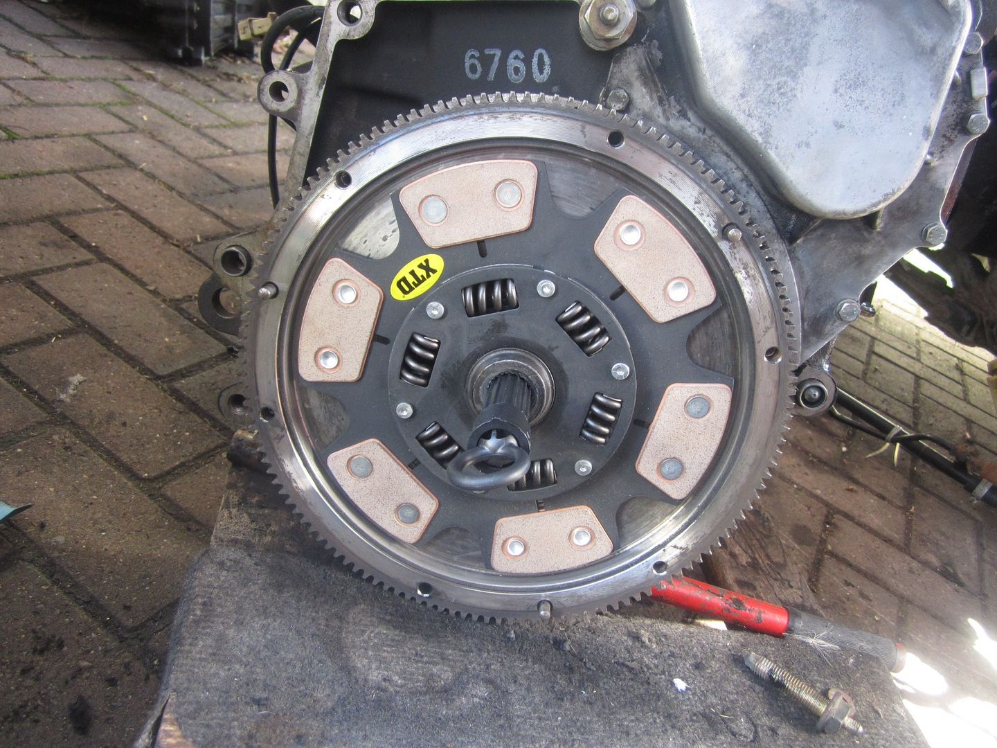

Engine has been fully stripped and built back up now and is now sat in the bay so I can work out what size intercooler I can squeeze in and how much room il have for everything else..
I got a 6 puck clutch so hopefully don't have to worry about that slipping ,,
Few pics,,

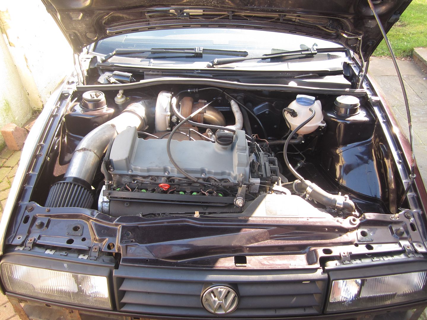

There's a lot more room than I was expecting so really pleased with how it's going ,just need to find some more time to get on with it!
Let me know what you think,,
Thanks,,,I am going to fit a 600x300x76mm cooler with inlet and outlets at the top ,boost pipe from turbo down the drivers side of engine and then a nice short 180'pipe for inlet ,,that's the plan anyway ?
I've ordered a 90' bend for the turbo intake to see if it clears the brake reservoir rest will be 4" ss pipe 4" maf and aem dry filter so the maf doesn't get damaged by oil...
Hope it all goes to plan,,

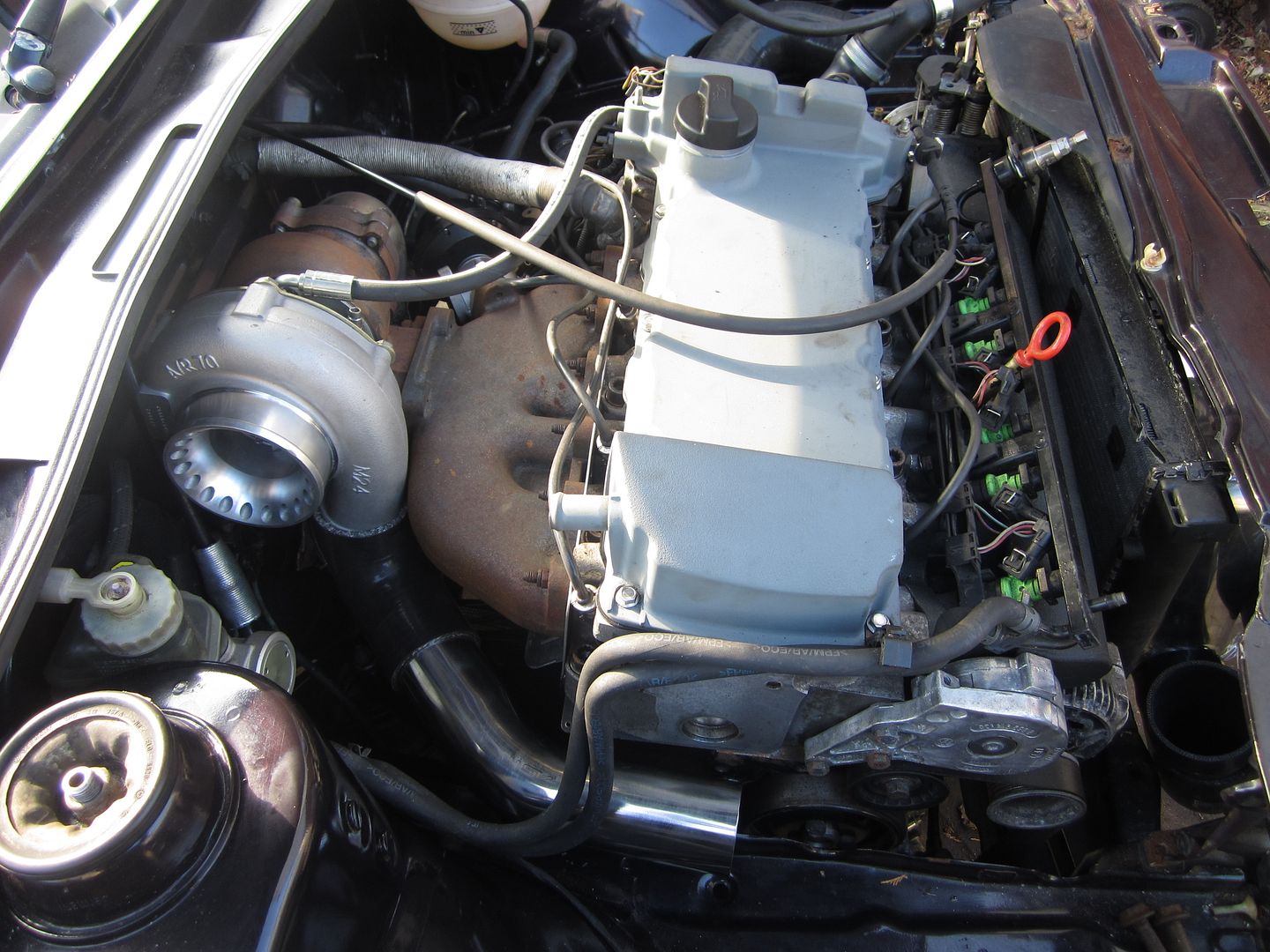

Not much of an update as haven't had much time to work on it lately ,but I have bought and fitted some bosch 440 green tops and spa turbo adjustable fpr that sits in place of the 4 bar item ..

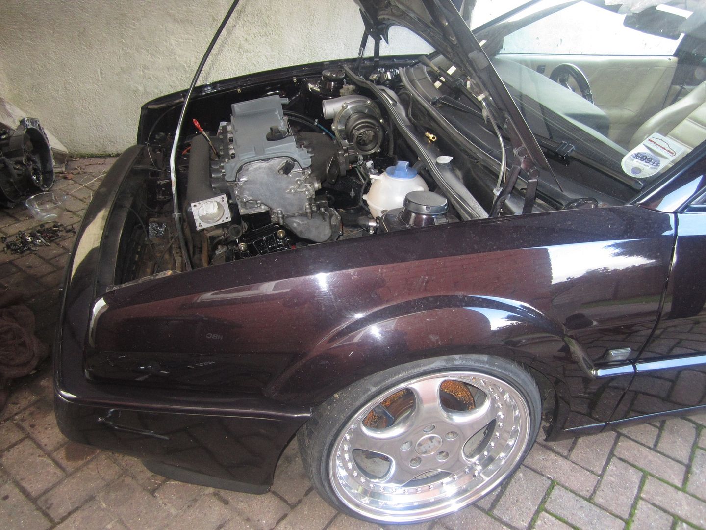

Wheels are off and going to be split for a full refurb before they get used..thinking of colour coding the centres as there a bit blingy at the moment,,

Wheels been inspected before they went into hibernation
And back to engine work,

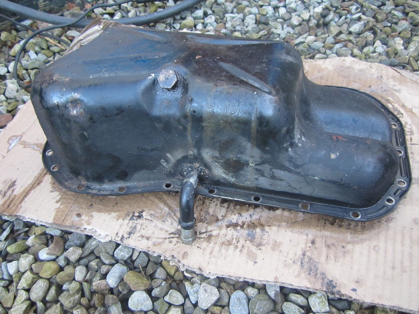

Oil return pipe welded into sump ,still need to clean it up and paint it but checked and it cleares the drive shaft nicely,,
As it stands now

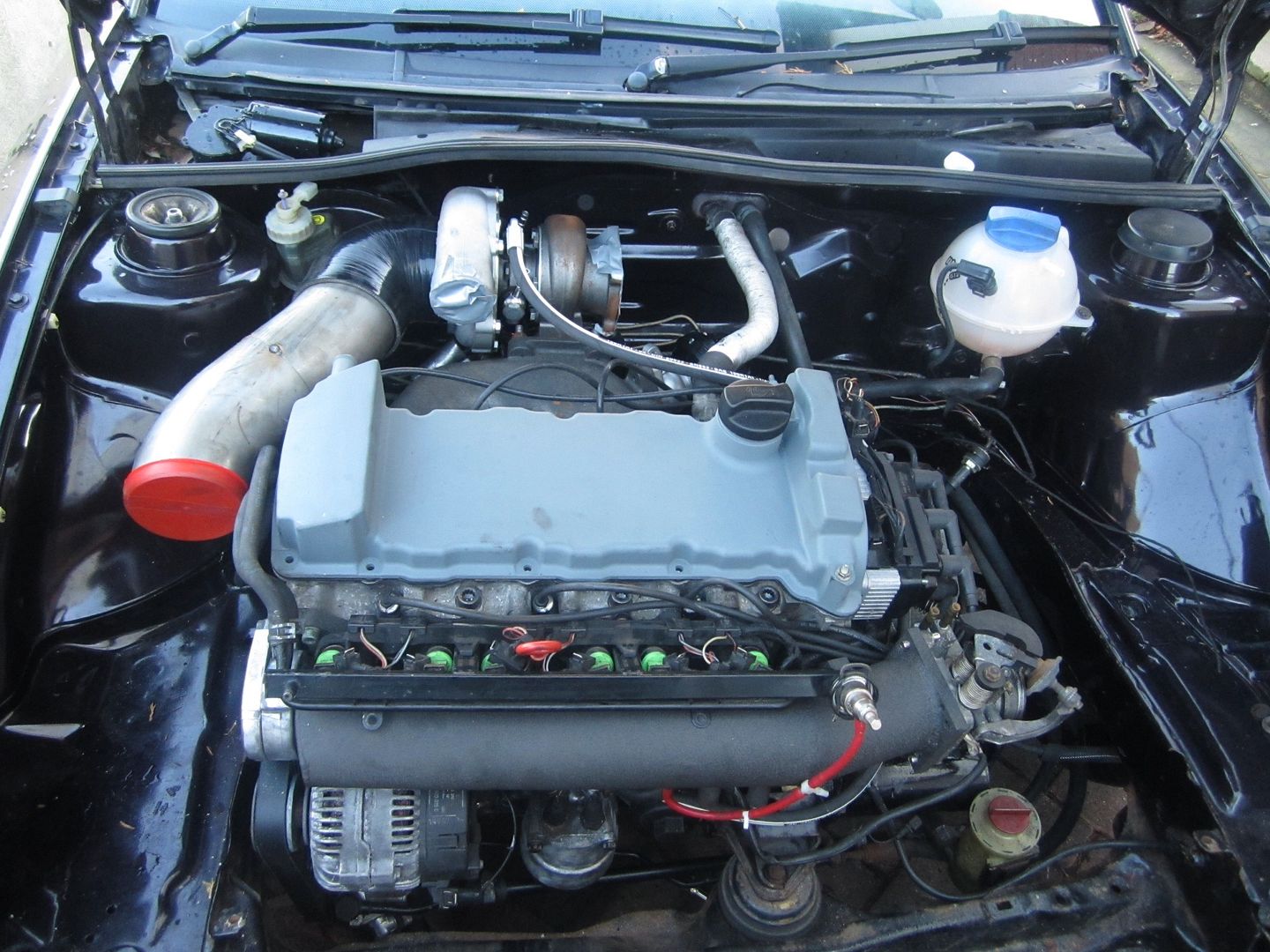

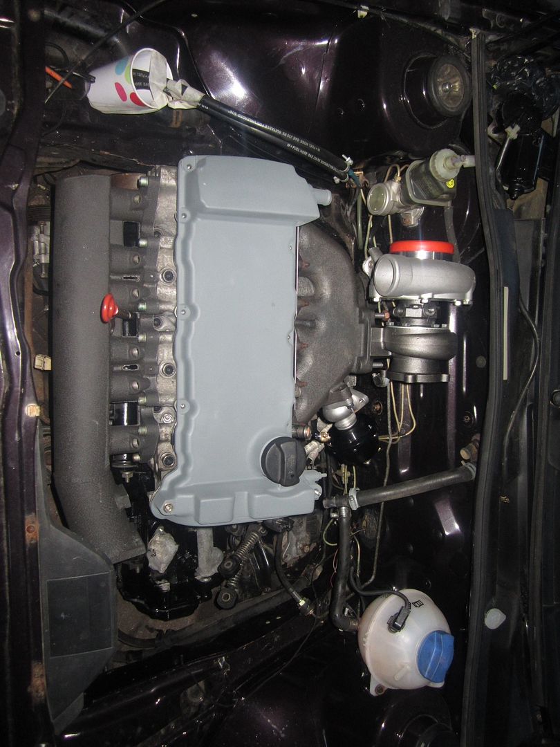

Well stil plodding on with this ,did a little bit this weekend and after finding a great build on vortex I have changed how I'm routing the boost pipes to give the bay as smooth and clean look as I possibly can ,not easy with a vrt in the very tight rado bay.
All parts are here now just need time to fabricate and get it all fitted..
Pics
Intake and rocker will be colour coded too so should look neat and tidy,,
Edited by 20vtvw
Just close to the manifold,there's more clearence than it looks on the pic but will clock the turbo a little more and will keep an eye on inlet temps once it's on the road..
This what I'm thinking of
Edited by 20vtvw
I like the idea, keeps it neat in the bay and shortish boost pipes. Get some of that gold heat wrap for the boost pipes or try make them from mostly metal as the rubber/silicon will degrade with the constant heat cycles.
Might limit the size of the intake filter you could have though.
Ye it's as short a path as I can do with a front mount,all boost pipes will be seam welded and when I can afford a decent turbo I could v band that link,.
