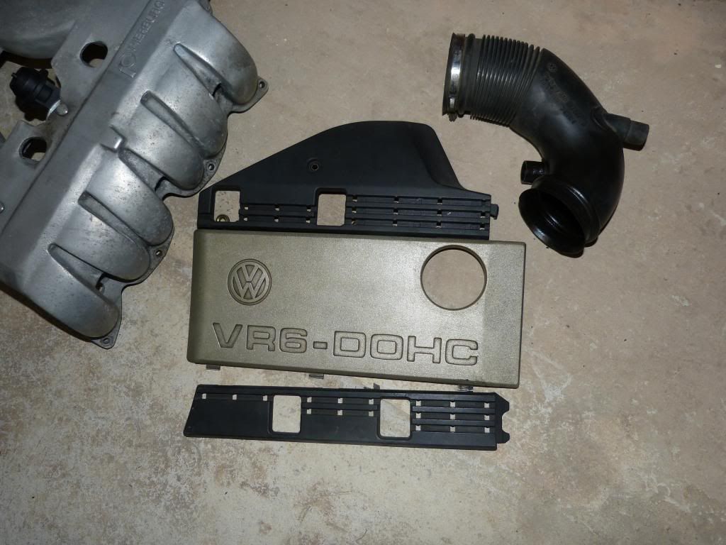

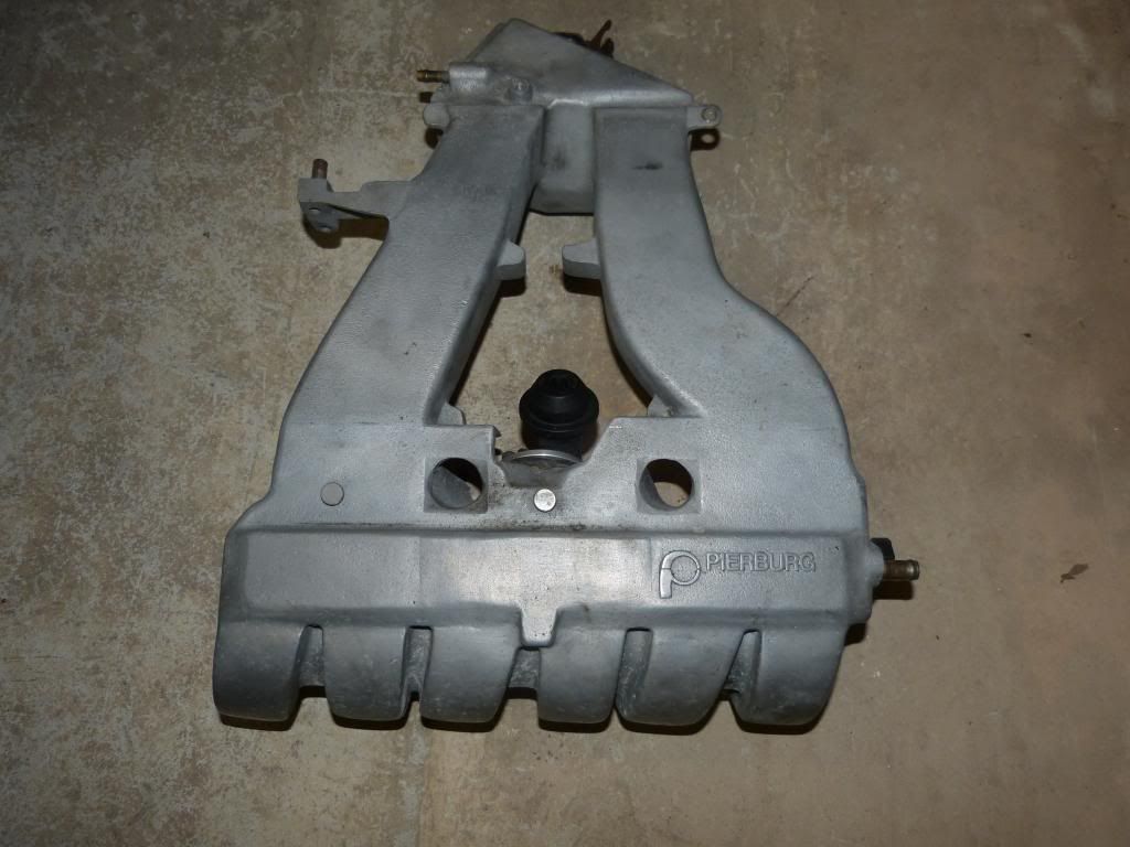

Goldie 2 Posted March 4, 2014 (edited) I try my best James… Latest update.. Ive been looking for one of these for a while, one came up late last year but funds didn't permit.. finally managed to find one, a VW Motorsport VSR.. It will be a while before its on the car. I want to have it blasted to return some of the texture to the casting and the observant amongst you will see the vacuum actuator is from a Schrick not a VSR so wil not allow the DOHC panel to be fitted.. Im not to worried about it as it will be getting removed and a blanking plate fitted.. The intention is to run it without any switch capability as i don't want vacuum lines and the reservoir under the bonnet. The name plate is also missing and i am on to leads to have one made, maybe an exact copy of an original or maybe something ever so slightly different.. These manifolds have a very interesting history, some are complete, some do not have the Pierburg logo on the casting or the knuckle halfway along the front. Some have a serial number underneath along with a VW and Audi logo whereas this one does not have the VAG logo on it. I have heard talk of prototypes but no one can say for definite. I have spoken to a number of people about there history (including a chap in the States who has 2 amazing Corrados but wearing VSRs and a 10k VR6 standard) who has been helpful with pictures of the name plate and some measurements.. The engine plastics need slight adjustment and the inlet elbow doesn't work due to the angle of the throttle so most use the early rubber type. Here are a collection of spare bits for me to try and id really like to use a late elbow if i can.. Id like to thank Tekara (Ross) from here who has had the patience of a saint selling this to me, i have asked a lot of questions. A long standing member of the community who has sadly sold his car on (to is about to)..why did none of you try and buy his 16" speed lines?? Enough chat, back to the polishing... Edited March 4, 2014 by Goldie Quote Share this post Link to post Share on other sites

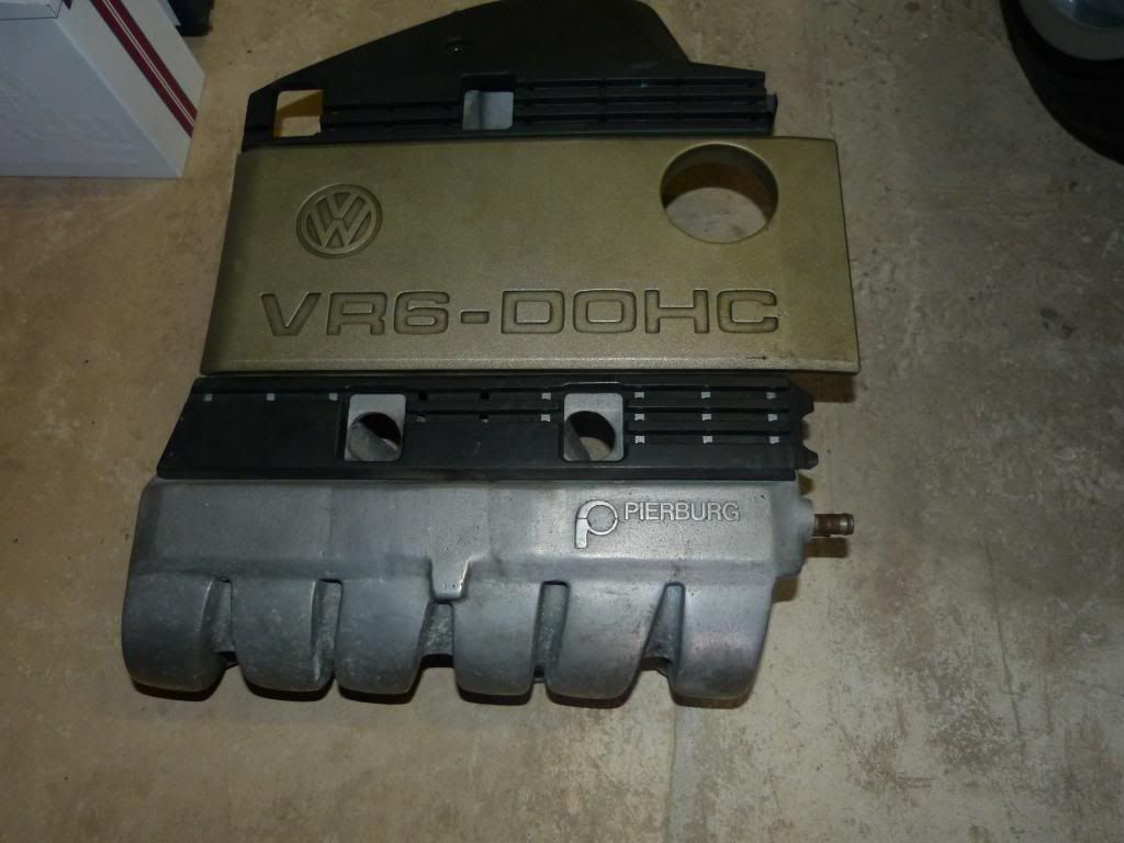

Goldie 2 Posted March 4, 2014 I am chuffed to have got my hands on one. Only 500 were ever made.. After a bit of chopping and removing all the bits from the manifold here is what it will look like….eventually.. Quote Share this post Link to post Share on other sites

Goldie 2 Posted March 7, 2014 Looking good mate, I was going to contact you this weekend to see if you wanted any measurements now I have my motor back. Give me a shout again if you need anything further. Vince at Stealth can if you ever wish get a new flap mechanism fabricated for you and source all the ancillaries All best Matt Thanks very much Matt and i probably will take you up on the offer.. Ill be looking for detailed measurements of the name plate.. First question on that subject is the font size of VSR the same as the DOHC on the engine cover and is the depth of the lettering the same? I have the full set up for the manifold, wiring, vacuum, controller but will not be using it. Im going to have a blank made up so it runs like a normal VR6 manifold.. Its off for blasting on Monday so will have it back later in the week ready to paint.. Quote Share this post Link to post Share on other sites
