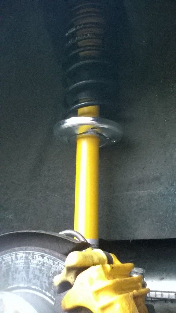

seanl82 23 Posted February 19, 2016 So, 13 months after taking delivery, they're finally on. Well the rears are anyway! I kept getting rained off, so managed to get the rear ones completed and the rear end back on the ground with all bots torqued up, and the front wheels are off and top mount nuts loosened so its just 2 bolts holding them on each side. Should get a break in the weather long enough to change them tomorrow. They're bilstein B12s (Bilstein B8 Dampers & Eibach springs) if anyone hasn't read (20 pages now!) back on this thread. Sorry for the dire pics! Quote Share this post Link to post Share on other sites
massbad69 10 Posted February 19, 2016 Looking good :thumbleft: and same set up as on mine which I'm really happy with Quote Share this post Link to post Share on other sites
robrado974 1 Posted February 19, 2016 (edited) Nice Sean , good work mate. The weather is dire ! . I tried so many times to get my new carpet fitted , it was a nightmare . I would love to have a nice big garage . Edited February 19, 2016 by robrado974 Quote Share this post Link to post Share on other sites
